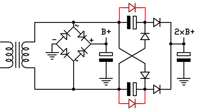

I'm having some trouble implementing the following schematic:
I found the above in a schematic posted by Tubelab who was using it in a scrap box amplifier (powering heaters on B+ and screens with the 2x B+ I believe). I had a small PCB made for my purpose.
I get the expected voltages with a 12V PT and no load, but something is going wrong when installed with a 15VA 115V isolation transformer (I have verified unloaded AC voltage). The voltage droops and the PT starts heating up, this is without tubes installed.
In my build the ~150V B+ feeds a CLC filter and 40mA draw (transformer loaded tubes) and the ~300V 2x B+ feeds a MOSFET regulator with around 10mA load draw (low current phono circuit). I am testing without tubes and the regulator disconnected though.
The caps are all 250V rated. I've used bridge/Delon doublers in the past and with those, rating for 1/2 the doubled B+ (plus safety margin) is enough. But does that hold true with this doubler variation? In trying to wrap my head around the circuit, it still looks to me like the caps are charged to peak AC and standing on top of one another. Then again, a shorted cap might explain what I'm seeing (but no visible damage to the caps).
I've made plenty of dumb wiring mistakes before, but I'm not finding one here so I'm hoping someone else can double check the theory of this circuit.

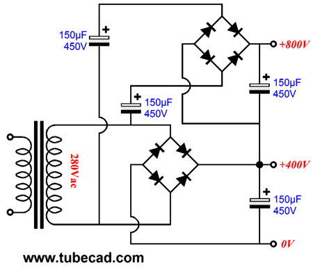

I think the OP schematic is an attempt at a full wave doubler.......It cannot work with full wave bridges.
I have built several of these and they DO work. The amp shown in the schematic that is linked in post #6 is still alive and well as built about 8 years ago.
I see two possible issues.
This circuit will produce 330 to 350 volts in normal operation depending on line voltage and the fact that isolation transformers are not actually 1:1. It may produce quite a bit more unloaded if your live voltage is distorted or noisy. C4 should be a 400 volt cap. All the others can be 250 volts.
The current in any rectified power supply is drawn in short pulses at the peak of the AC cycle. Use of tube rectifiers blunt this peak somewhat, but this circuit uses silicon. On any given peak there are two diodes feeding hungry caps in parallel in this design since it is essentially two power supplies on one transformer. A small power transformer may be operating near saturation when operated into a resistive load, and may overheat when feeding rectifiers. This should not happen with no load at all though.
I have found that an isolation transformer needs to be derated a bit when feeding diode rectifiers. I tend to suck no more than 35 watts from a 50 VA Triad N-68X when using diode rectification. The amp design shown in the link on post #6 used a 100VA isolation transformer to feed a guitar amp that draws about 40 watts at idle and 70 watts at full power (17 watts output).

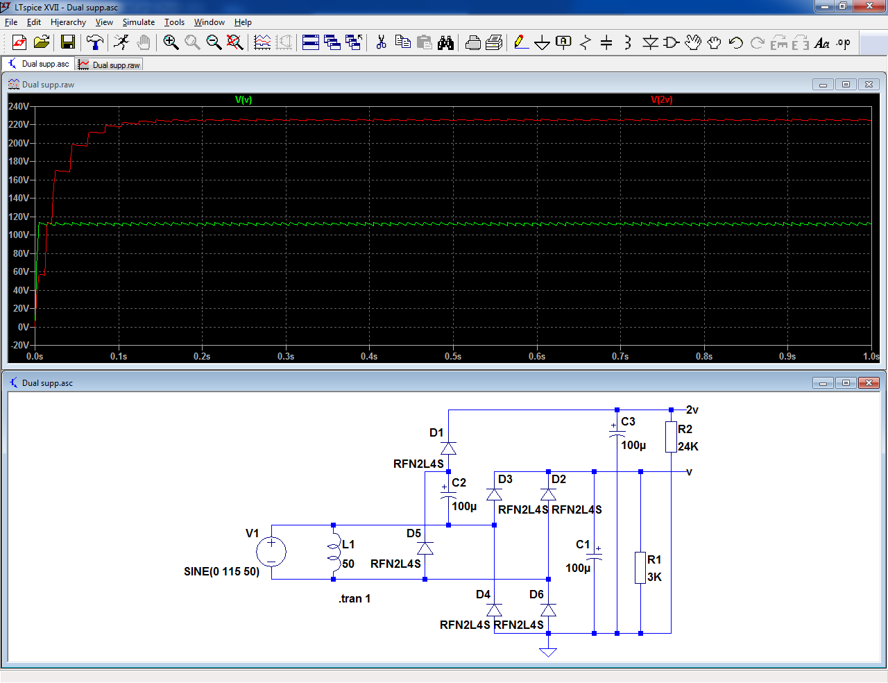

I never noticed any reverse charging, but then I didn't look too hard. I have an LT spice sim on a backup drive somewhere. My application has a constant load on the FWB (the tube heaters), but the doubled output is very lightly loaded (about 2 mA) until the tubes are conducting. Extra diodes are cheap insurance.

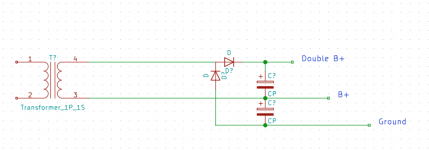

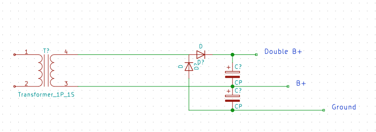

Why not use a voltage doubler.
That circuit (post #2) will make the power transformer very unhappy (buzzing and heat) if the loads drawn on each half cycle are different. This means that very little current can be drawn from the B+ supply.
