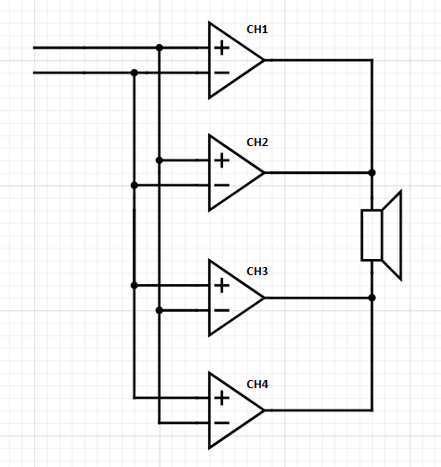

Bridge+Parallel amplifier
How? Could I not wire as follows:
Terminal + of coil 1 to channel 1 +
Terminal - of coil 1 to channel 1 -
Terminal + of coil 2 to channel 2+
Terminal - of coil 2 to channel 2 -
Yes, that's correct.
I was saying that you can't talk about an advantage because this is the only possible connection, so you have no choice (we're talking about an amplifier connected internally in bridge).
You can have an advantage when you have the possibility to choose one of two available conditions.
However, if you follow this type of connection, the problem of filtering remains.
