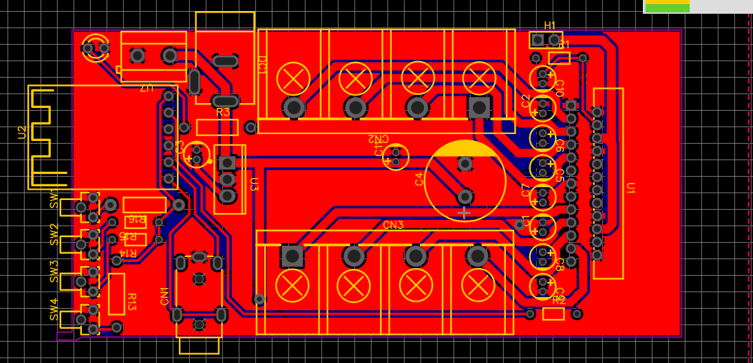

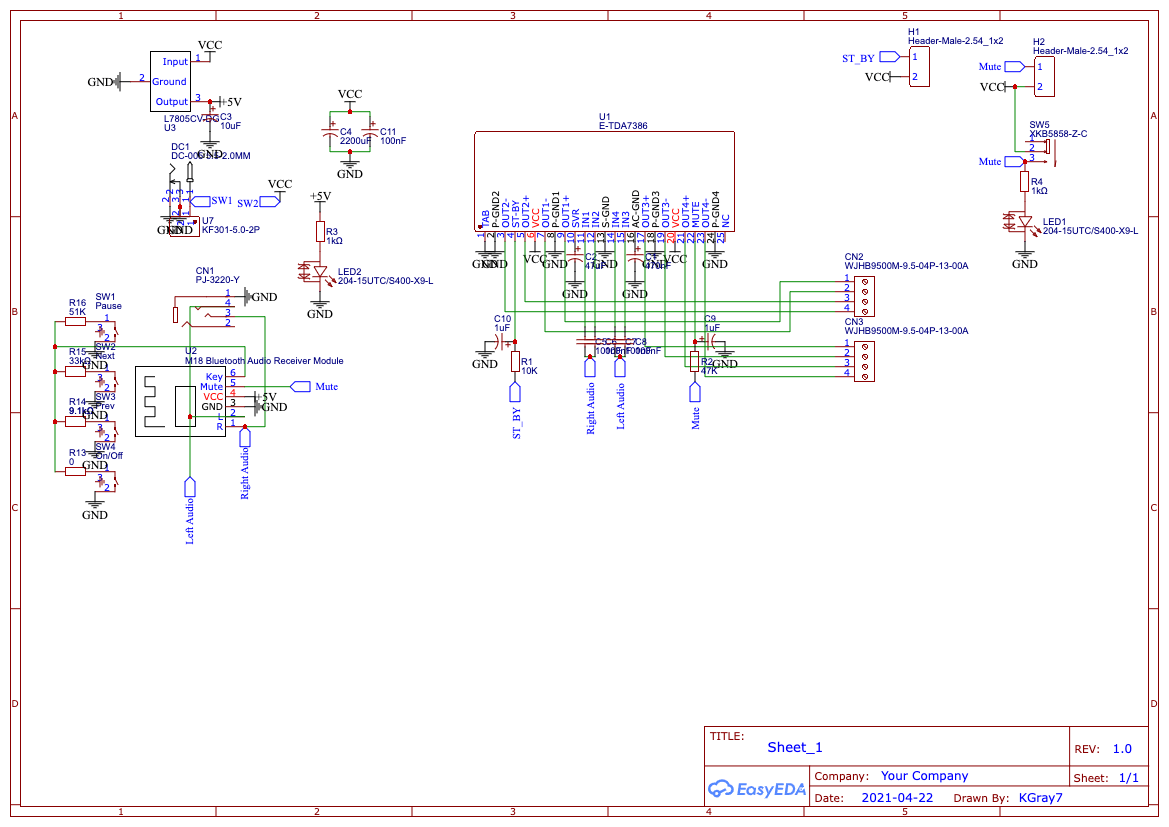

Hi all!
I made a 4x channel 40W (per channel) audio amplifier based on the E-TDA7386. It works amazingly! But I am wondering if I can bridge the outputs together on all 4 channels to create 1x 160W output? Is this even possible? Or maybe I could bridge the right and left channels to create 2x 80W?
Attached is the circuit and PCB top and bottom.
Thanks in advance!
EDIT: I am trying to run a 100W subwoofer temporarily on it.
EDIT2: Apologies for the rough schematic. FYI, the audio input caps are 100nF.

Those 4 outputs are already bridged, each of them.
So: no.
You might use 2 in parallel to drive half the load impedance but I´d rather get a proper higher power amplifier.
