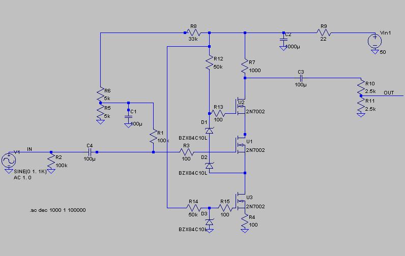

I'm about to build a ZenV4 and want a preamp to go with it.
Since it will be an integrated amp I will have a supply voltage
of approximatley 50V (like the Zen) at my disposal. After having
read Mr. Pass articles on cascoding and DIY OP amps I was
tempted to add som circuitry to the BoZ in order to, hopefully,
improve its performace. So my question to all of you is: Is the
following a good ide? I suppose not since I haven't seen
any attempts to modify the BoZ in a similar matter... But why is
that?

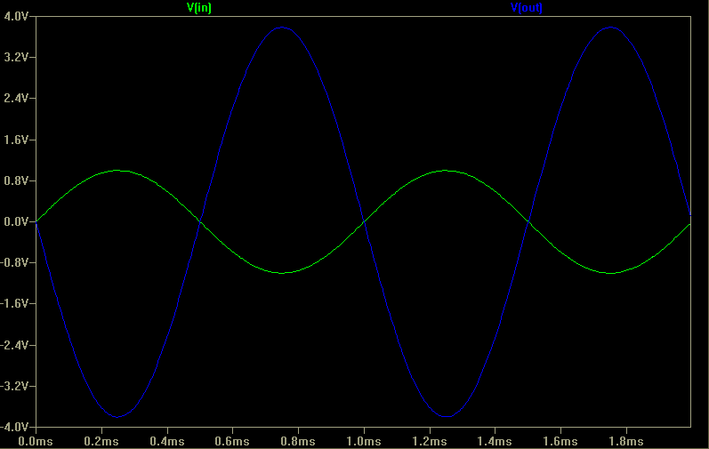

If this is the case my simulator is _way_ off...
Could you please explain your reasoning?
Below is the simulation from LTSpice/SwitcherCADIII with the
above circuit:
This circuit does not work. It has no gain. Output voltage is always 0V
above circuit:

Do not believe everything a simulator tells you. If Q3 works as current source with an (nearly) infinite output impedance it's
obvious that there isn't any voltage deviation on R7 and in this way any voltage gain.
If Q3 saturates I can't see any reason why implementing this MOSFET.
In other words: This circuit works not as expected.

As bocka says, the gain should be near 0, as the gain will
be the ratio of the output impedance load divided by the
Source resistance of Q1, which with a constant current source
will be very high.
Drop the current source, Ground the Source of Q1 and enjoy
the cascoding provided by Q2.

Nelson Pass said:As bocka says, the gain should be near 0
Sometimes the silence would be very appreciated 😉 .
Thank you bocka and Mr.Pass for pointing out the error.
I didn't think the MOSFET Q3, which can't supply a whole lot of gain, would work that well as a CCS. The purpose was just to try to better the 100 Ohms to ground in the original BoZ.
Now I find I've lost all my faith in Spice simulations!

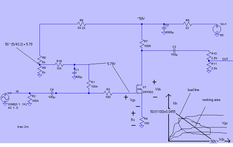

Niclas, I suppose you don't want us to design this amp for you but you should take a closer look at the working point of the amp. How do you make a currentwise stable amp? Think also: Avoid trimpots. Use them when nothing else solves the problem.

I assure you that some help would be appreciated! I'm familiar with my Kirchoffs and Thevinins, but unlinear IV devices like MOSFETs give me the creeps. For instance, what value of Vgs would I likely get when several Vgs seem possible when examining the load line? My rather limited understaning of the circuit is as follows:I suppose you don't want us to design this amp for you but you should take a closer look at the working point of the amp.
- Bride of Zen with cascode and current source.
