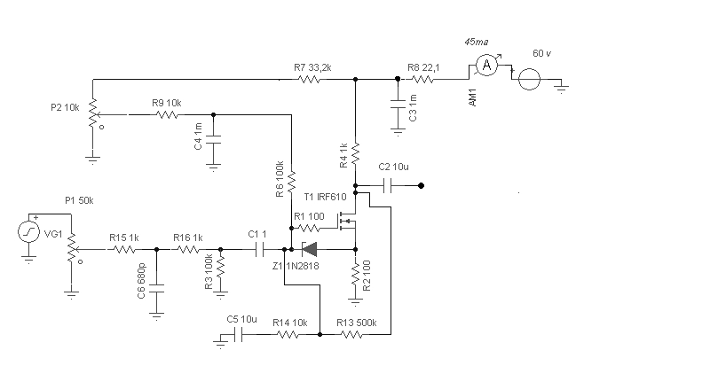

A friend who have the Bride of Zen told me that there was saturation at high input volume, so I have done a simulation of the Bride of Zen with a small NFB and an input volume and an input rf filter. (I use Tina for simulation)
By keeping the nfb to the minimum I keep the distortions spectrum free from high frequencies harmonics.
Is there better ways to put a nfb in the Bride of Zen, or any suggestions ?
Thank

I don't know much about this circuit, but I'm not sure what you are aiming to do - if this design is saturating too early for your application I wouldn't have jumped to nfb as the solution ?

Hello Gareth
The Bride of Zen preamp belong to a friend, he call me and told me that there was a bit of distortions at high frequency wen there is a high level input.
So I've download the Bride of Zen schematic and I did a simulation at 1k hz and 10k hz.
At 10k hz in that simulation the distortion start a bit hard at 3 volt input.
And wen I ad a very small amount of nfb it was better and at 3 volt input the distortions was much more less and without high frequencies artefacts (it was done without the input volume pot) . But it's only a simulation.
I my simulation, the load for the preamp was 10k ohm.
