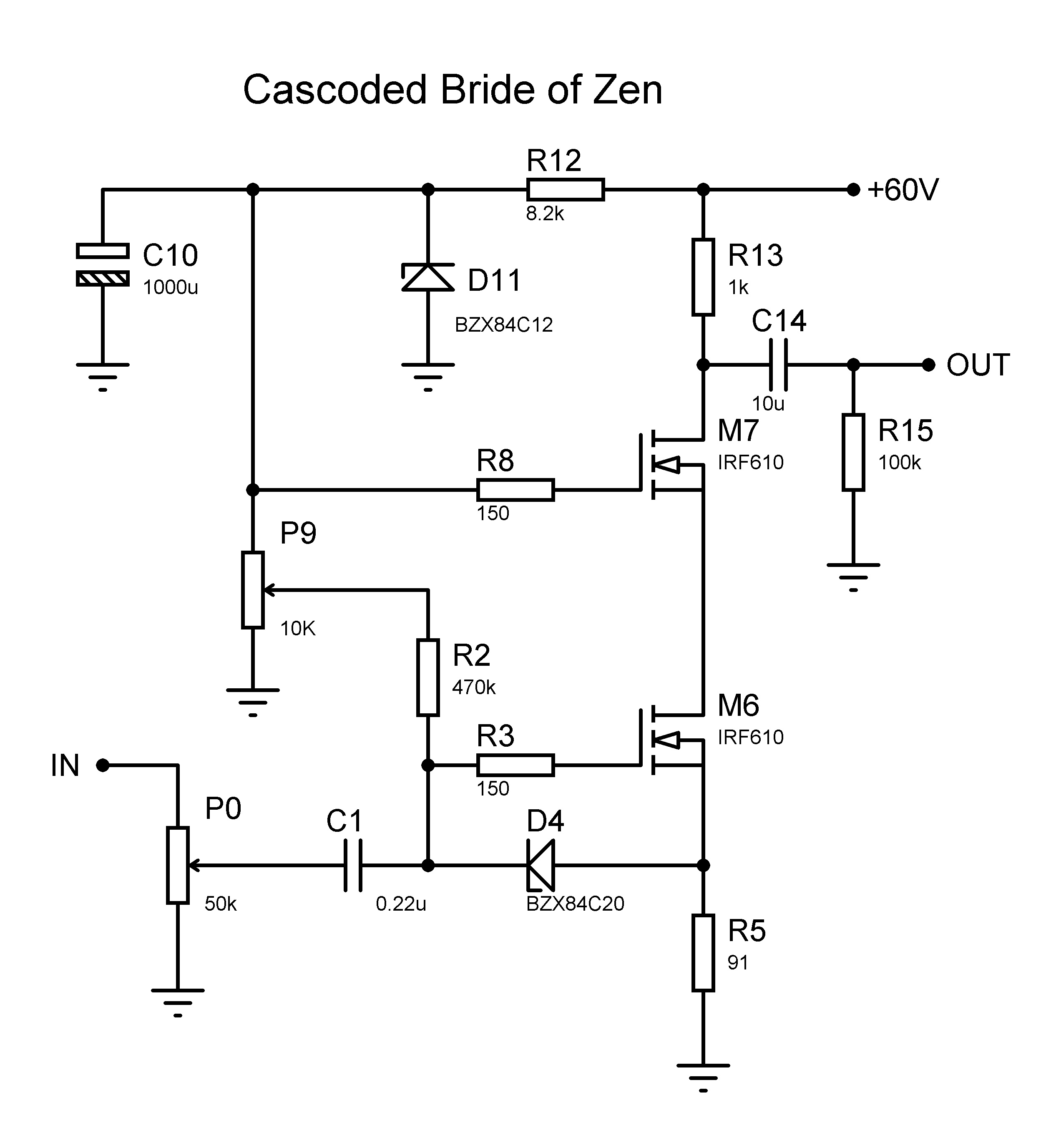

I am thinking of using the Bride of Zen as a combined preamplifier and voltage amplifier to drive my power buffer (with no voltage gain). Therefore, I have to place my 50k volume potentiometer before the BoZ. I am afraid the high frequency impact is too large with this potentiometer without cascoding.
So, has someone tried a cascoded version of the Boz?
consiidering that you have 30V at output node , make that zener 18V , re-arange bias circuit for lower one
in any case, lower mosfet will work better with more Uds
I would start from there ..... and up the current later
to do that , decrease both R load (1K) and Rs , to roughly maintain gain and voltage in output node
then fine tune voltage in output node with bias voltage
I did, and it didn't bring me much happiness either......So, has someone tried a cascoded version of the Boz?

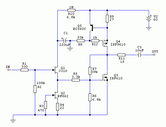

I suggest attached circuit:
Input buffer (Q1,Q2) gets you rid of the input cap and isolates the pot so you don't have to worry about it.
Amplifying MOSFET (Q3) works with local Schade feedback in triode mode, loaded with CCS (Q4,Q5).
Zout is about 150 R .
Gain (about 20dB) is set with R7/R5 ratio and half of the PSU voltage at Q3's drain is set with R6 (depending on Q3's Vgs/Id characteristic).
This circuit has much better PSRR than original. It will deliver more than 20V_peak of clean swing at the output and is linear up to almost 100kHz.
Of course, it can be further improved in many ways - first thing would be to use 2sk2013 instad of IRF610 for Q3.
The reason I wanted to use the BoZ was to make a 2 stage power amplifier without any feedback loops and compare it to my earlier much more complicated amplifiers.
The solution with a source follower input instead of the cascode can be an option, of course, though.
I have simulated Juma's circuit (without the JFETs), and I must say I am impressed. The topology is very similar to the Zen amplifier. So I think I will give it a try.
- Bride of Zen cascoded
