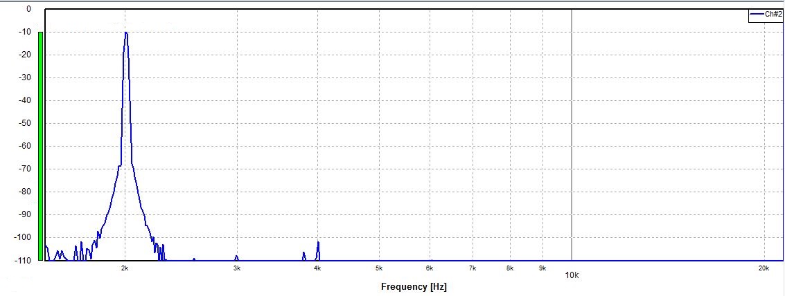

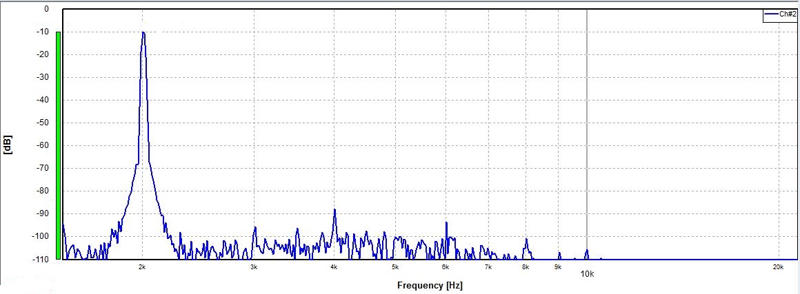

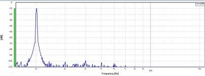

using my pc and sound card, fft analysis; 2kHz @ 0dBfs, 24/96, and sound card input attenuated by 10dB to avoid overload.
Three dacs tested under identical conditions.
1. Wyred4Sound DAC2DSDse
2. Berkeley Alpha2
3. Bricasti M1.
*Note: Sound Card THD is around 0.001%, which limits measurement resolution.
