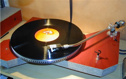

Somewhere around here i´ve got the manual for the Stax 12", see if i can dig it up, (if You want my wife´s opinion of the state of order i keep my things in that will be a thread of it´s own).
It is the original 12" j type with detachable SME style shell, was designed for Stax condenser (electret) cartridge which never made it to series production. Effective mass is variable as counterweight consists of two parts inner thredaed as usual and outher sliding to provide for a large span in cartridge weight , ( actually also an extra add on weight if You use the EMT cartridge in original shell). It is most suited for lower compliance cartridges, i like it best with Ortophon SPU, Denon DL103 but also Grado signature models. I´ve used it with realy high compliance cartridges like Sonus blue wich sounds and works good but will produce some lf disturbances, especially on not perfect records.
I´ll see if i find the manual and also post a picture of the arm so we agree on talking about same piece as it is a bit uncommon.

Found some info on the Stax UA70 12", most in Japanese but effective mass should be 24g.
