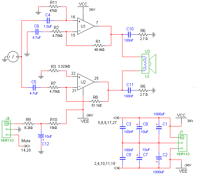

I say "custom" because it's based on PSU boards from audiosector and LM4780 bridged boards from tech-diy. I'm using a single Plitron 300VA 18V+18V transformer (keeping the voltage low so I don't need a fan). According to the overture design guide, this voltage gives me approximately 115W per channel. At this point I've decided on a single rectifier board for both amps ("stereo" design). The PSU is going in a separate enclosure from the amp.
On the amp board, I changed some cap types from the example parts list. I changed the 1000uF cap to an FC and the 10uF to an EB. This gives all electrolytics in my system a lifetime of 3000+ hours @105C. All values were kept the same.
The PSU on the other hand, I've changed the design a bit. For smoothing caps, I've selected a 2,200uF FC cap for each rail. I also purchased a pair of 15,000uF TS-HA caps to add if I feel there isn't enough bass. Also note there are 1000uF, 10uF and 0.1uF caps on power on the amp board.

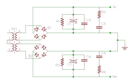

So at this point I'm almost done populating the PCBs. I bought 2 PSU boards, but only plan on using 1, so I made different PSU configurations that I can swap out to compare. On one, I used only a single 2,200 uF Panasonic FC on each rail.
On the other I used a snubberized setup consisting of the 15,000 uF Panasonic TS with a 0.1 uF Kemet Golden Max ceramic across the pins and a 0.1 uF Vishay MKP plus 1R metal film resistor after that.
I left the 1,000 uF FC caps off the amp boards for now, so I can test without them first, then add them if I want. There are 0.1 uF ceramic and 10 uF electrolytic on the amp board for PSU decoupling (is that the correct term?).

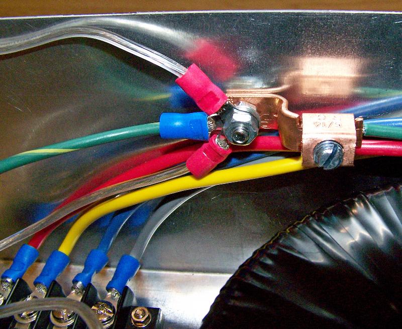

Here is the power star ground. The green/yellow wire heading off on the right goes to the earth pin on the power entry module. The green wire on the left goes to the power exit module. The silver coloured wires go to the ground points on the rectifier board. You can see the terminal block for the transformer secondaries in the bottom left corner.

Here is the final schematic of the PSU that I'm using.
TR1 is a Plitron 300VA 18V dual secondaries
B1 and B2 are made with MUR860 diodes
R1 and R2 are 1,500R 2W generic carbon film resistors
C1 and C2 are 15,000uF 50V Panasonic TS-HA capacitors
C3 and C4 are 0.1uF 50V Kemet Golden Max capacitors
R3 and R4 are 1R 0.5W Vishay NFR25 metal film resistors
C5 and C6 are 0.1uF 63V Vishay MKP capacitors
