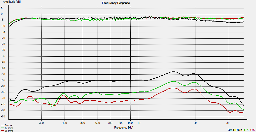

I would add a third remedy: reduce distortion using current drive amplification.
Here is an example with a small 4" driver (JBL C500G, used in the JBL LSR32 and LSR6332) with breakups occurring above 4kHz. It is a 4 ohm driver.
3th order HD is shown here, and two peaks can clearly be seen at 1.5kHz and 2kHz, reflecting breakups at 4.5kHz and 6kHz.
black curve is with a voltage source (close to 0 ohm output impedance)
green curve is with a 13 ohm series resistor
red curve is with a 26 ohm series resistor (as close as I could get to current source)
Level were adjusted to get the same SPL at 1kHz.
