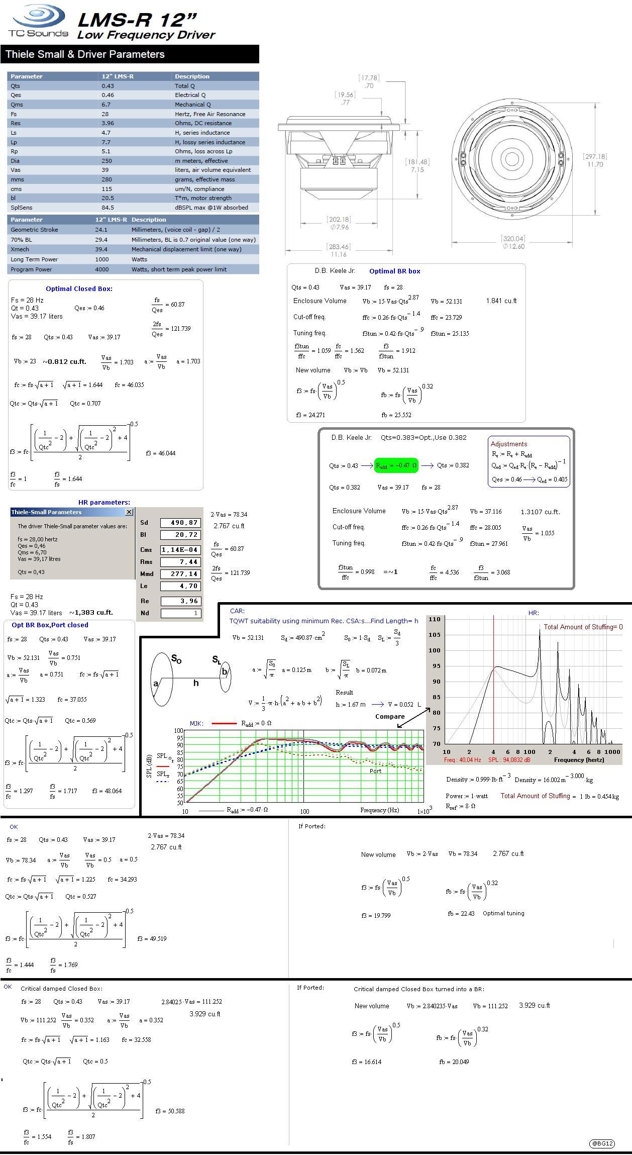

UPDATE
As discussed, I reduced the net internal volume of the ported box from 2.05 to 1.85 by adding a 7" cube inside the box to take up about .2 cubes. The resulting decrease in box volume also raised the tuning frequency from 25 to 26.7hz. the idea here being to let the driver have more of a mechanical advantage over the internal box air load. I've read that extended bass shelf subs can have a slight degradation of SQ over smaller flat alignments often being accused of one note bass which I absolutely agree with when the driver has a high Qts.
Anyway, yes it did have a much better subjective presentation. The group delay measures better from 31ms down to 27ms....not sure if that is much of anything but its a step in the right direction.
I'm going to go down another .1 cubes to 1.75 which will raise the tuning to 27.5 or so with marginal decreases in group delay.
The sealed box just needs to dry so that will be my fun for tomorrow.
So yes it already sounds better. I think the tuning was too low anyway.

Today I didnt finish cutting the hole for the driver in the sealed box but I did reduce the net internal volume to 1.7 cubes and tuned to 27 on my ported box. As I get away from the EBS alignment, I am getting the sound I want.
These reductions converge upon a 1.4 cube allignment at 27hz for the minimum group delay and I suspect the best detail and punch. I never would have thought that .35 cubes and a 25hz tuning would be so muddy sounding. Group delay falls from nearly 31ms to 24ms and the smaller internal volume seems to let the driver react faster. Yes slight changes make all the world of difference.
I will build a smaller 1.4 cube box and stay with the driver (keeping it) and tune it to 27 which is the best mix of group delay, lowest -3db point, and likely SQ in my truck. The sealed box will be tested so I have first hand experience with it. I tried most of my subs ported and sealed and never heard a sealed system I could live with. Even 7db at 25hz uses too much power to get there and just doesnt sound effortless at the volumes I listen at.
I'm really happy even at the 1.7 cube step but hey doesnt everyone try 7 alignments before they settle where they want to be? Seriously, I think most people who tout one box style over another never tried anything but what they have.

I see that group delay is just horrible for the LMSr 15 in 6 cubes tuned to 20hz....basically flat. Its actually really good though if you have it in 4.2 cubes and tuned to 25hz.

A 1.85 cube box at 25hz was the second worst sounding alignment 2.05 @ 25 being the worst I've heard for some time. 1.85 @ 27 sounded much better. 1.72 @ 27.5 really good. 1.4 @ 27 (best). Sealed was 1.05 (same as databass's test) and .85 with the smaller being really punchy and required to handle any power. The speed/control was not enough for me to give up the deep bass SPL and the distortion as the sub neared Xmax with the EQ to match the ported box was too much for me.

No issues with the vehicle ringing. My later posts in this thread noted that reducing internal volume to butterw/4 away from extended bass shelf got me the detailed sound I was looking for and it sounds incredible. EBS alignments are one note bass typically and lack detail.
I have the SPL I want with the extension I want with no compromises.
I initially used a 2 cube box ported to 25 and a 1.4 cube box tuned to 27 reduced group delay and gave me the punch and detail back.
