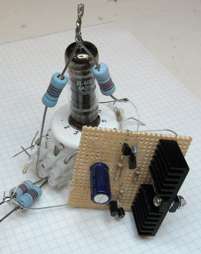

Another guy here gets the credit for inventing this, but I've put together some breadboarding fixtures using various tube sockets mounted into PVC pipe end caps. I use bits of euro-strip for contacts, and attach components/bits of perf board as needed. Attached is a prototype of an experimental sand/vacuum line amp (check the "Evil Sandman" thread for more details).
