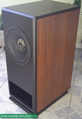

LEOSOUND - Tudo em som automotivo
This is a loudspeaker transmission-line with Keybass-Panther

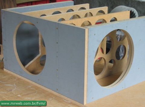

This is an article in Portuguese about transmission-line resonant (air-coopler), Works only in Bass and has a high yield, different from the loudspeaker picture above. Reading the text will notice that a speaker 8" is sufficient. Is an article from a magazine and the quality is not good.
The author has an interesting way to write...😉
http://ifile.it/s0nqdkp
The price is reasonable for models Keybass and cost less than the models NAR for sub 10" (The models NAR costing much less in a years ago but had rise in price recently)

Do you have any link that describes the TL in the photo?
I'll take a look at the other link you posted.
DiyAudio.com.br
You can send an e-mail to the author, he is a good person!

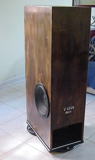

I found more loudspeaker with two sub 12" in configuration Push-pull (closed-box)

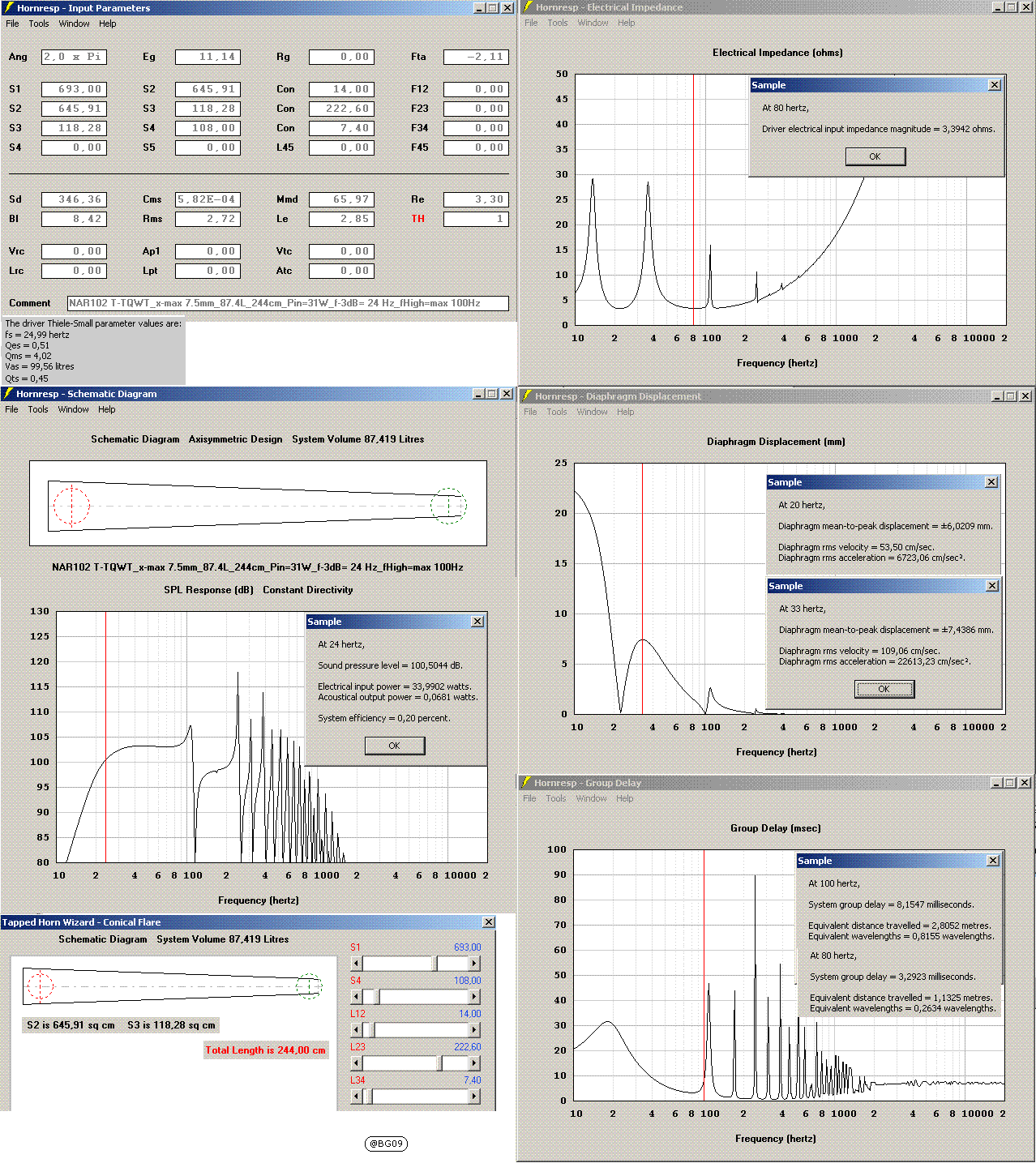

Hi Niguel,
why not NAR10 in a T-TQWT proposed by bjorno? You can build 2 and use in stereo mode as you told me. It would work fine since you have a large room.
http://www.diyaudio.com/forums/atta...orative-tapped-horn-project-nar102-t-tqwt.gif
I'm building soon 2 enclosures (T-TQWT and TH) for the same driver to compare the results. You can follow the results in the Brazilian diy forum.
best regards
Highef
Hi Highef,
This is one of the options I'm considering. In fact, except for the question of cost it is the option I prefer, I think, especially since your intended system set-up is close to what I plan. I joined the Brazilian forum, and will follow your progress there (and here) with interest.
