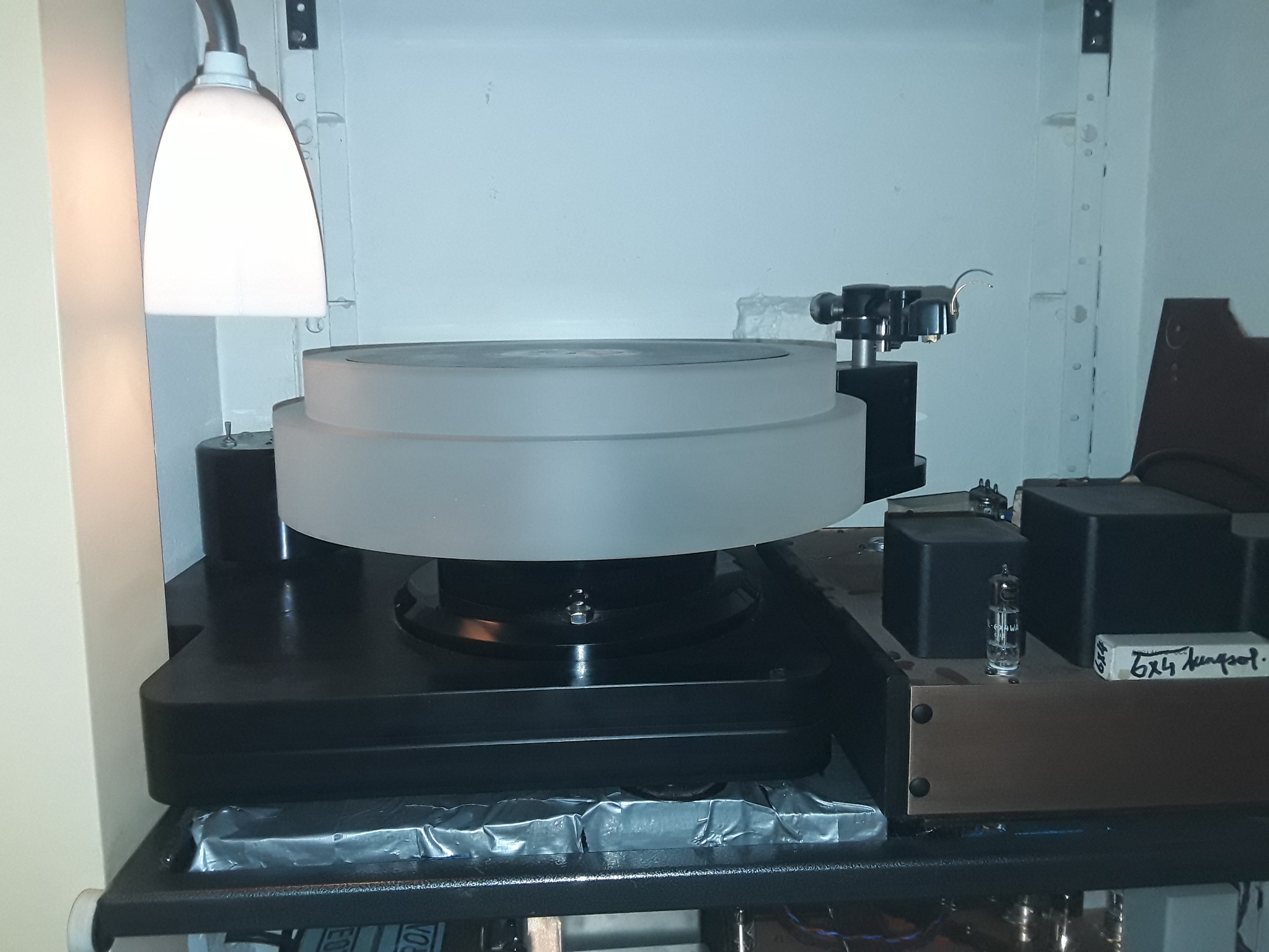

I just decided it would be better to have the belt running on the upper part of the platter where the inverted bearing is located.
The lower part is 400 mm diameter. The upper part is 360 mm.

The motor unit will be at close distance to the platter. I think motor axis and platter bearing will be something like 280/290 mm apart.
From what i read on the VPI forum the Pyramid design works very well so it could well be that it doesnt need a rubber belt to stop vibrations travelling into the platter. My diy motor housing machined from pom material will have several cavities of different seize and in all directions that will be filled with lead shot ( to kind of sink down vibrations)
The platter being heavy and big diameter will have a pretty high flywheel effect so i kind of hope that it will just keep turning. lol
