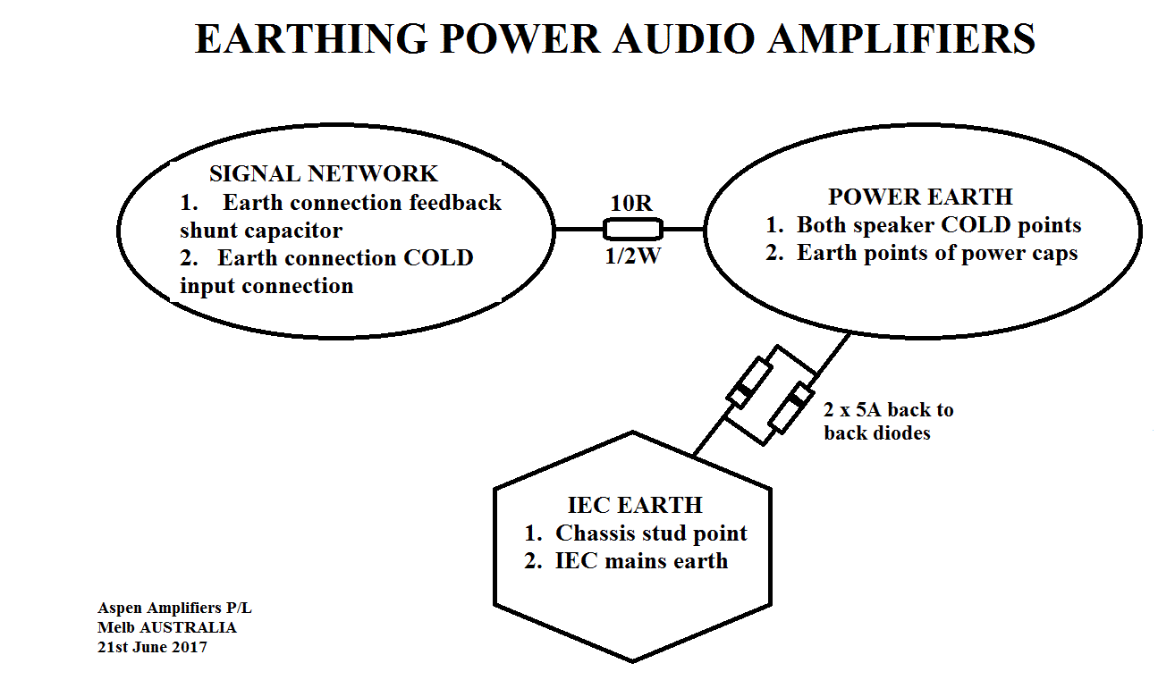

Most of my power wires are twisted, but not that tightly. The mains wire is quite tight however, but you cannot see it and the wires are covered with heatshrink.
The signal paths are connected to power earth via a 10R resistor; and the IEC and power earth are connected to the one stud at the rear right. The pcb ground is connected to the power ground on the centre of the pcb with back to back diodes; that is, no galvanic connection to the chassis, but protected with high current smd diodes.
This approach works extremely well. The SAKSA, and the Maya in fact with same earthing, are utterly silent idling; you cannot hear anything on the speaker if with your ear inside the cone. Earthing is a black art; I have arrived at this after years of stuffing around!

A draft block diagram shown all these(input gnd,power gnd to safety eart connection) would be useful .😉
