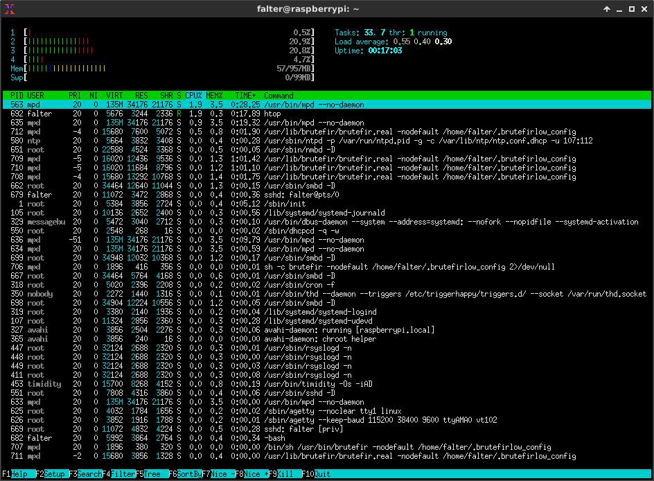

Thanks! Practical information. Just to make sure I understand, your data flow is:
Input -> Resample to 16/48k (if needed) -> BruteFIR 4 ch x 65536 taps (probably 32 bit internal math?) -> HDMI to receiver
RPi 3, especially if recompiled in Aarch64 (needed for NEON) is about 120-130% the performance in terms of pure math crunching versus the RPi 2. And, more so, more bandwidth to/from memory (although I'm not sure how much bandwidth is needed in our application). All in all, sounds like you could convincingly do 6 channels x 65536 taps. Not bad at all.
On the high end of the SOC-micro/mini/meso/nano/pico/femto/atto 😀 computer spectrum, if you're willing to be a bit more hands-on and don't *need* the built-in WIFI/BTLE, the ODROID C2 looks pretty promising (Amlogic s905 processor = quad A53 clocked out to 2ghz). Extra memory to boot.
Best if used headless by the looks of it, as I don't think the ARM Driver for Linux is all that hot.
That is the way on the Pi2; on the Singlecore it is 4x 8192.
I have just put the SD card from the SInglecore to RPI2, to show a little Picture. This is the PI2 running MPD, Brutefir with 4x8192 Taps @16/44.1 Output...
