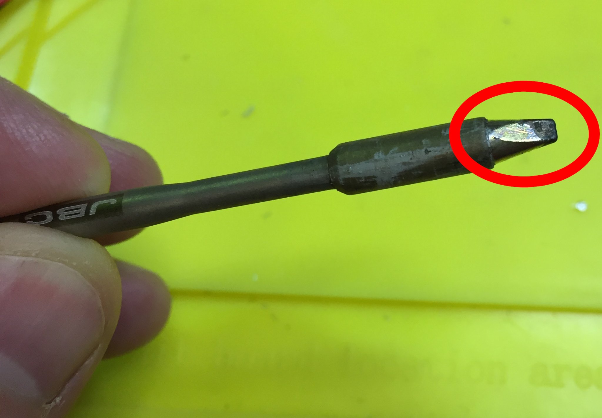

Up front I must mention I'm new to the whole "direct heating" soldering irons business. Being on a budget and after some research I settled on a chinese JBC station knock-off compatible with JBC T245 hardware with the intent of using genuine JBC tips.

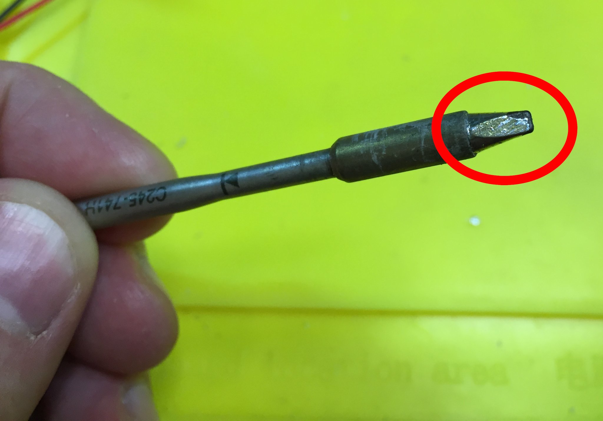

Ordered this tip on aliexpress at a good price with the reason for the discount being it comes in a older style of packaging. Tip seems genuine, package is sealed, looks good but when trying to tin it for the first time a substantial area of the tip won't tin and the plating seems to be chipped (see pics).
Tinning was done using 63/37 tin/lead solder and without external flux. Tried "tip refresher" stuff on it without success. Wet sponge, brass whool, nothing works. To me this seems like a bad tip, the non-plated parts won't take solder at all so most of the tip surface is useless.
So before I ask for a refund, I wanted to validate with more knowledgeable people if this chipping is indeed a defect or the result of a mishandling on my part. But all I did is simply trying to tin the tip, hardly seems like bad handling...
Thanks in advance for any insights,
Joris

Yeah... I thought I would be clear since it is a genuine JBC tip. Makes me think reason for discount was not old style packaging but rather because it didn't pass JBC quality control...The joys of dealing with junky suppliers selling junk
Is there an advantage over asking refund directly on ali?Stop payment on your card.
Opened dispute, let's see what happens. What's bugging me is that I took care of dealing with an authorized JBC dealer that has a high 99% feedback and still got junk...

An update for reference if anyone experiences the same troubles as me on aliexpress. The seller first answer to the dispute was to refuse the refund. Incredible behavior for a so-called authorized JBC dealer given the detailed pictures I submitted to support my claim (the pictures in the opening post above).
Of course I refused that "solution", and the seller didn't respond back. The dispute is transferred to aliexpress itself when an agreement is not reached after a pre-determined delay (5 days); aliexpress then approved the refund. As of now I have not received the refund per se but if there are further problems I will report back here.
If I didn't get a refund I would have proceeded to open a claim with credit card provider. This affair quite cooled my enthusiasm towards aliexpress.

IME a real JBC is hard to beat. I find it so much better than all the Weller "industrial" stuff I've used for decades.Why JBC? Honestly, for years I've used simple soldering irons and the classic triac-controlled WL100 Weller station and wanted the good stuff - At least for the tips, as Real deal JBC tips last reportedly much longer than anything else. But I must confess I came very close to buying the genuine JBC station and it's not impossible a "from me to me" gift appears under the Christmas tree at some point.
The tips are expensive (as they also contain the heater and the sensor) but dependable and this instant on-the-fly switching of tips is pure joy.
DIY is more fun with better tools but it will always be a trade-off. You still have to treat them well, solder tip coatings, regardless of tip size, are mechanically fragile by design.
