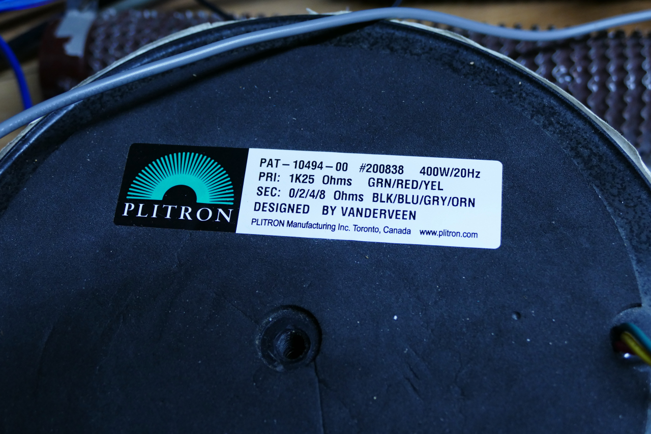

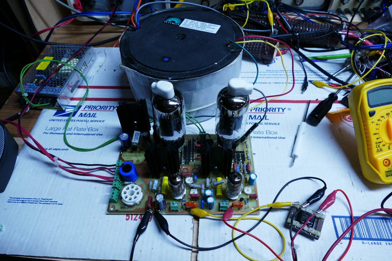

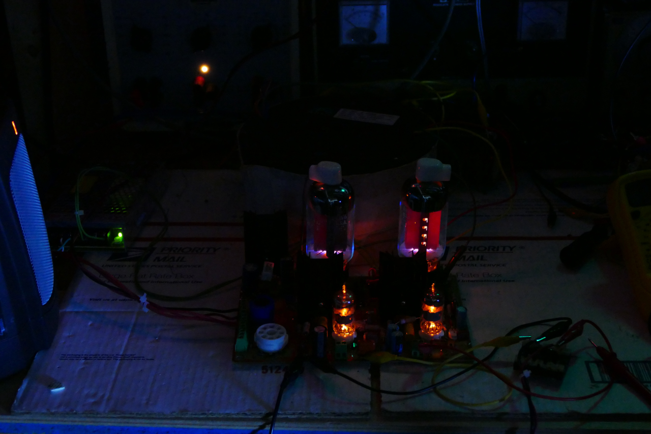

In the next test I took the same UNSET board, drove the two channels out of phase, connected up the Mother of All OPT's, dialed back the idle current, and turned up the power supply. This was a mono single channel test, so only one load resistor was used. The power supply and drive signal was adjusted to produce about 250 watts of power output at the dull red glow point in the Mother of All Sweep Tubes. Pressing on toward 300 watts caused clipping which caused a blown resistor in the screen grid supply.
The end result will be something in the 500 WPC range using 6 of these tubes per channel. This one resistor ate 250 watts for several minutes. I did smell something hot, which turned out to be the cardboard shipping box that the resistors were laying on. Being that there are the biggest tubes and OPT's that I have, I don't think I will ever need bigger load resistors.

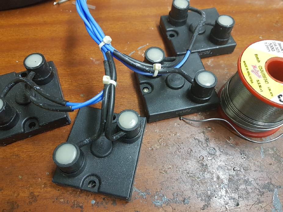

Maybe someone will use these ones from the dynamic braking of a T1 subway car 🙂
They should be good for a few kW 🙂 From what I gathered in person, those spirals are basically the same as the coils on an electric stove... I'll bet they will glow under hard braking...
I have a few motor starters using those resistors..as a test load for hifi?.....overkill? Much? 😀
