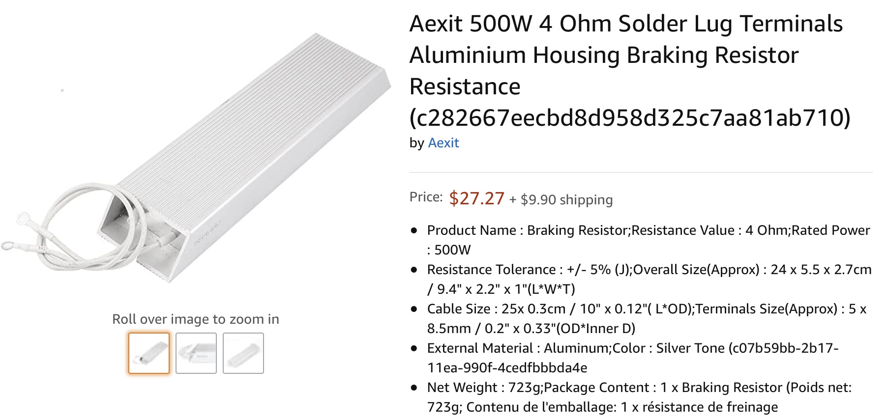

I just came across these “brake resistors”, available in 4, 8 Ohms (and many other values). Power 500 Watt or 1000 Watt. Available mostly on Amazon, Ebay, Ali...
For audio I need at least a 150 Watt dummy. Currently I’m using big metal wirewound resistors with a heatsink and a lot of cooling. I’m thinking of putting them in a can filled with oil for better cooling, like I did with large RF dummy loads from Heathkit. I still remember the smell of boiling oil 😀.
I wonder if anyone has ever tried these brake resistors as dummy load. I guess they will need extra cooling too?

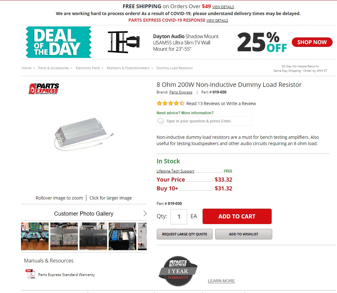

Those are intended for a one time dump, not continuous power.
If immersed in oil they could take more, but you'd have to test them to see.
Standard noninductive wirewound resistors work fine for audio loads.
No heat sinks needed, just use their mounting brackets to stand them off a surface
that can take high temperatures.

The resistors at post #1 and #3 look more like a precharge resistor; typical application is to reduce the initial load current of the capacitor bank installed in a large motor control unit (a brushless motor, for example). It can also be used as braking resistor for small industrial motors. I have no direct experience with low cost no-brand import resistors of this type. A good quality resistor of this type built in EU costs about 5 times more. They are supplied with extensive specifications for proper sizing. At the rated power value, the increase in temperature above ambient temperature is typically 200 Kelvin; the resistor value will increase sharply at higher temperatures to maximize the chance of surviving a overload. Divide the rated power by 5 to keep the temperature rise below 50 Kelvin. In braking applications, the rated power of the braking resistor is often specified with a duty cycle of 5%. Divide the value by 20 to obtain maximum continuous dissipation. Obviously this a rough extimate; the manufacturer's datasheet will list the exact values.

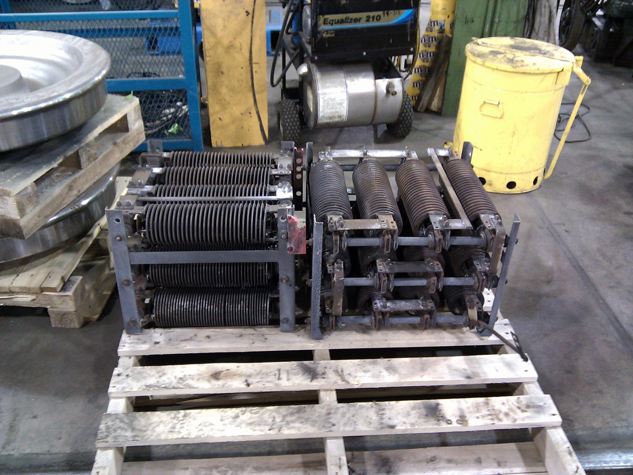

They should be good for a few kW 🙂 From what I gathered in person, those spirals are basically
the same as the coils on an electric stove... I'll bet they will glow under hard braking...
