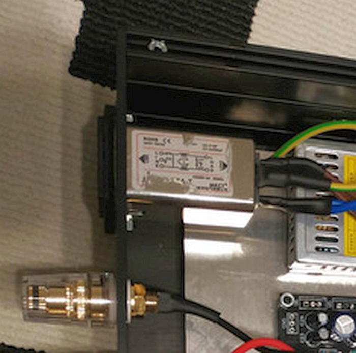

Completed yet another Purifi-Neurochrome build. This time a 4 channel build to complement the previous 5 channel unit.
However, decided to go for my first customised case as I was getting bored with the previous builds plain fronts.
More pictures and notes here: purifi-the-4ch-build
This means I can now ditch the AVR and move onto a pre-processor to drive my 5.x.4 HT system. I may try to rebuild the 5 channel unit (which used a generic Modu-shop case) into a slimline one too, thermals permitting.
So far the base plates are transferring heat to the sides without any heat pipes etc.

All okay with me, however, the front panel design needs a change in the positioning of the push switch as it is flush against the inside bracket. This requires some *customised* bracket work to get the nut on the switch I selected.
I would have fixed that in 5ch version I received yesterday, but wanted the switches aligned when the 4ch and 5ch units are stacked. So more bracket work 😱

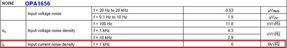

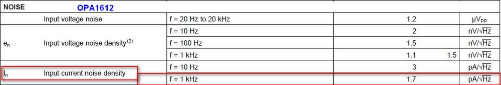

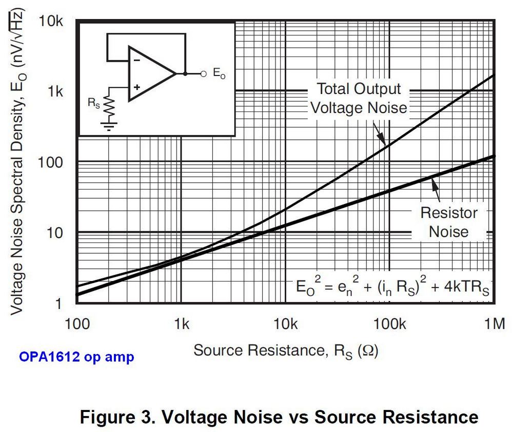

I think the main benefit of a FET input OPA1656 op amp is the ability to use a higher impedance input signal, since the current noise is so low. The resistors on the FET input can be larger & still have reasonable effective input noise compared to the BJT input op amps like the OPA1612 & LM4562 which are better suited 1k ohm or less.
Can we deduce that OP amps with FET-input architecture is more suited to the Purifi Buffer than the Bi-Polar ones ?
I think it depends on the output impedance of your source. Bipolar input opamps generally have lower voltage noise, and while they are more susceptible to current noise with high source impedance, if you are using a DAC or preamp with a low output impedance, a bipolar input opamp may be preferable.

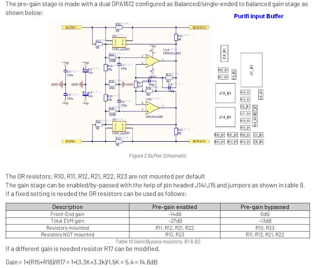

Hi amigos,...here the final version of my Purifi Buffer, V2.1 with OPA1656...
Are you using a a source impedance greater than 10K ohm for the input to the the Purifi Buffer? If the source impedance is closer to 1k ohms, the OPA1612 may be a better choice?
A compendium of blog posts on op amp design topics (page 26-28): https://www.ti.com/lit/pdf/slyt701
