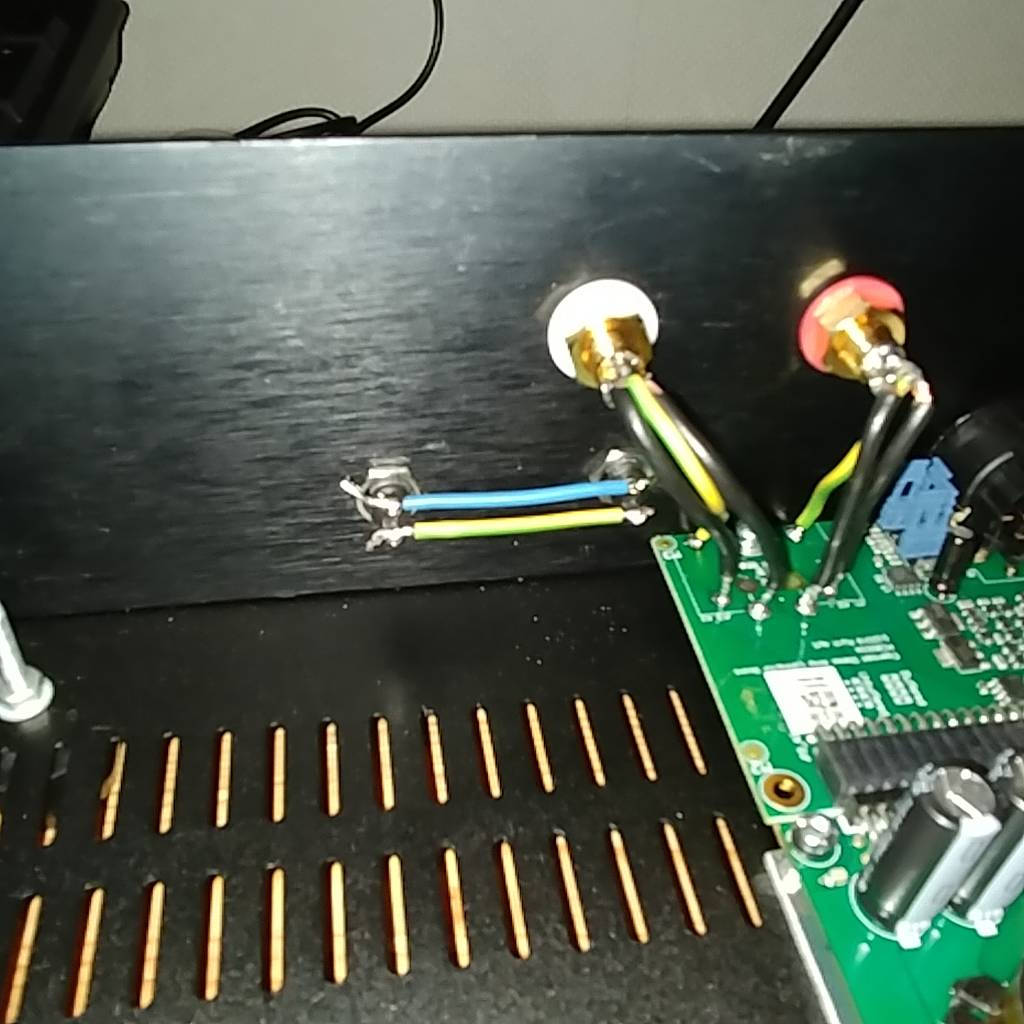

My build does not use the Eval mounted connectors. I used panel mounted WBT binding posts and Neutrik XLRs with metal shells. I used 2x16 AWG wire for speaker connections of less than 3" for an aggregate gauge of 13. I jumped the sense wiring on the board for simplicity. With output wiring of this short length, and high gauge, I very much doubt there would be any difference extending the feedback loop to the speaker terminals, but it is your choice to do so, or not as you see fit.
I have a simple question.. For those using an Eval (1 or 2) board, do you stick with the provided connectors or switch to more "fancy" one ?
If the latest, what are you doing for the sense +/- ad is it that important ? (sorry if it's an obvious question...)
they...
The sense wires basically extend the feedback loop. With the eval board in stock mode, the feedback loop includes up to the speaker connections. If you run small gauge speaker wires to a binding post, then the run the sense wires also to the binding post, the feedback loop would then correct for any additional impedance of the small gauge wires, which might affect the damping factor of the amp (output impedance).
But if one just runs relatively large gauge, relatively short wires, to the speaker binding posts, there will not be any significant added impedance, and so no need to extend the feedback loop around the wires as well. Just make sure when you remove the Eval Boards speaker connectors, that you also jump the sense wire points, as mentioned in the user guide for the Eval board, as this closes the feedback loop on the board. If you do not do this, you will have big problems running the output of the amp without feedback!

Taking the sense signals all the way to the speakers would provide the best feedback, but you risk the possibility of turning the amp on by accident with nothing connected. Another option would be to add the external sense lines, but use a 1R jumper inside the chassis just in case.

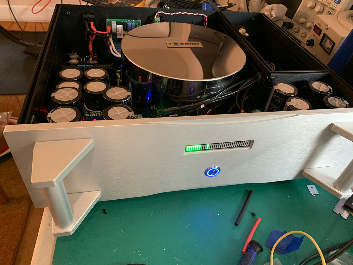

@eboissier - I am building a Purifi-based amp (monoblocks) with a linear power supply. I have one channel complete and currently am just grounding the /AMPON signal. There is a slight (half-second, low volume) buzz when power is first applied, but this is barely noticeable.
Ideally, a circuit that clamped this signal after a couple seconds would be better, and I plan to implement this on the custom buffer board I am working on.
For now, I am using the Neurochrome input buffer. Since I only have one channel implemented and don't have the amp in my main system, I can't fully assess the sound yet, but it seems to sound quite nice driving my workshop speakers (Totem Mani-2).
