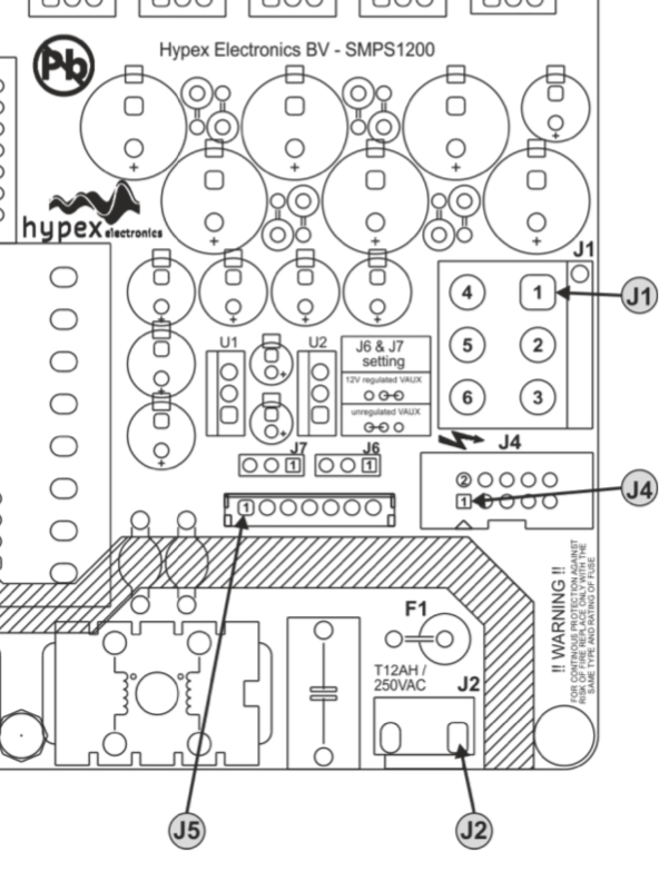

The SMPS 1200, should be set for the unregulated output on the aux output. See the data sheet for the SMPS 1200 to see how the jumpers are set for regulated vs. unregulated output to confirm. You can download the data sheet from Hypex. I mention this because one amp, from a well known manufacturer, came to my workbench with the outputs from the the two SMPS 1200s set to regulated, when this amp used an input module with its own regulators, and expecting unregulated ~+/- 18 VDC input! Needless to say this amp was not working correctly, as the very nice discrete regulators were receiving 12 VDC input, and being asked to produce regulated 12 VDC output, of course they could not. If this was set wrong, it could explain why the amp is not sounding right to you...

I confirmed with SMPS1200 data sheet. It’s set at unregulated position 2&3 in J6 and J7
