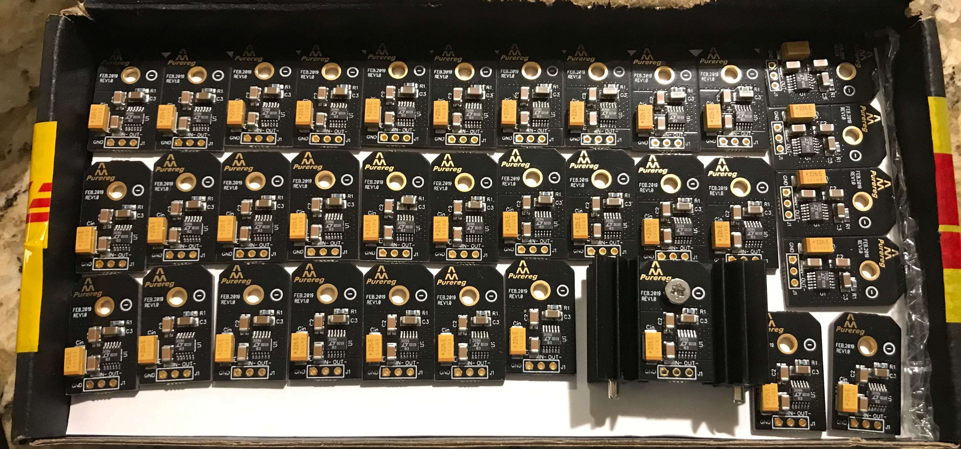

Do you mind posting this sale ad in the Swap Meet section? And please, everybody, take a look at the middle row of these “buffers” (correction...regulator) and count to the 5th one starting from the left. You’ll see that part C3 exhibits poor soldering or is blown off. Is this the kind of reliability that Mike Davis wants to sell? Is this a matter of pride? Or perhaps you have DETAILED measurements to show the superiority of these regulators and how you have proven beyond a reasonable doubt that they measure better than a Belleson SPX, without resorting to a datasheet?
I didn’t think so.
But please before you sell these units, test each one, give your customers a return guarantee and fix the one I have referenced.
Anand.

Sorry I'm not selling these. Just seen them on his forum and thought some people might be interested. Yes looks like the cap on 1 of the regulators isn't centred on the pad. Good eye. Although it would only be a purely cosmetic flaw if the cap is still contacting the pads. If you want further data on them you'll have to contact Mike. Mike said he used Belleson's for years and switched to these after measuring them and comparing them with listening tests. They measured better, and he couldn't hear a difference. So it was a no brainer for him to switch.

Although it would only be a purely cosmetic flaw if the cap is still contacting the pads. ... and he couldn't hear a difference. So it was a no brainer for him to switch.
Mike, it really doesn’t matter how good or bad a product sounds if an assembly issue results in poor reliability. This should’ve been discovered by the manufacturer, period. Hours of frustration can be avoided on the part of your clients (and perhaps yourself) if suddenly a regulator stops functioning due to a cold soldering joint. This is the diyaudio forum. Let’s not sell a product as “reliable” under false pretenses or pretend we are not or have nothing to do with Mivera Audio when the evidence clearly points the other way.
