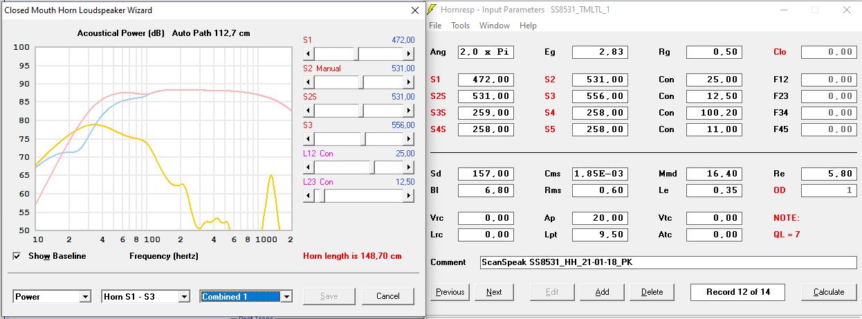

The basic cabinet calculations is done by the award winning (and very humble) Transmission line expert (which he refuses to call himself) Paul Kittinger (google him) in Martin J Kings software MathCad. That software is unfortunately not available anymore due to misuse by comercial users. The work has then continued in Hornresp, which is a great software, with almost the same result. The filling calculations are based on somewhat slightly different methods in the two softwares which create the slight differencies in outcome. The results has been explored back and forth and ended up with minor changes but pretty much the same as from the beginning with Paul and MathCad.

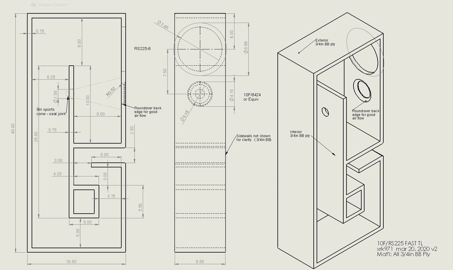

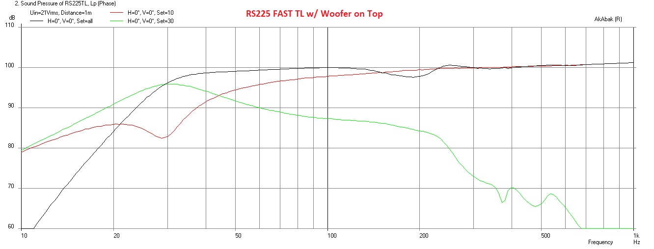

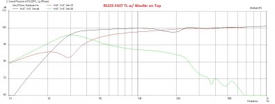

I recently designed in Akabak, a 40in tall floorstaanding TL with the RS225-8 (~35hz bass extension). Although used with a ScanSpeak 10F/8424 - it could be adapted to a 3-way with a dome tweeter in a waveguide. I have had good success with an RST28F or RS28F in a commercially available Visaton WG300 waveguide too.
The resulting speaker has been built 4 going on 5 times and is one of the best speakers I have heard. A tapered TL is one of the best alignments, IMO. So good choice for your basic guideline requirement. This could be somme with dual 7in or dual 6.5in woofers like the SBA Papyrus with great results too.
More info here:
10F/8424 & RS225-8 FAST / WAW Ref Monitor

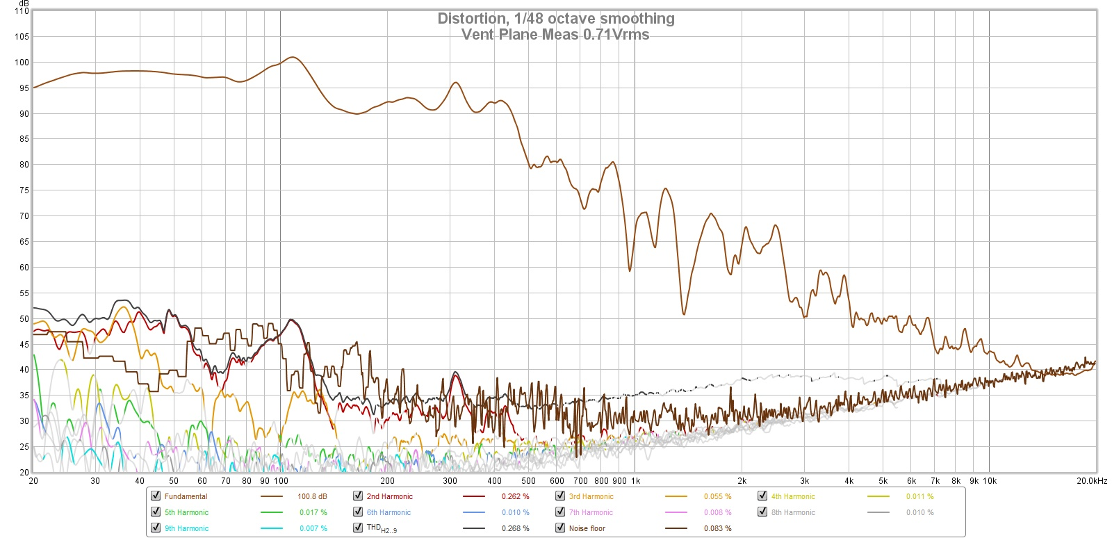

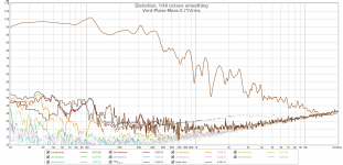

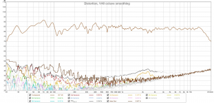

Measurements:
TL vent output only (attenuated to prevent mic clipping):

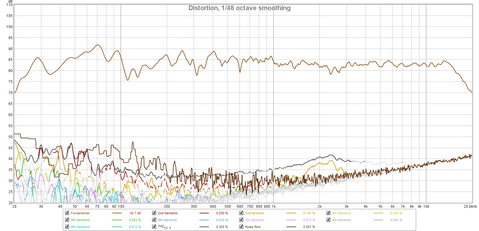

This is the simulation at Xmax which is reached at 21Vrms - for 100dB output:

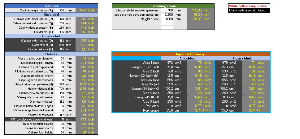

I actually added two things to my original post here. The "driver chamber" and "simple pipe design". The chamber adds lower -F3 and some other things to the equation, and "simple pipe" is just to keep the wood work easy, and actually being able to design a floating tapering.

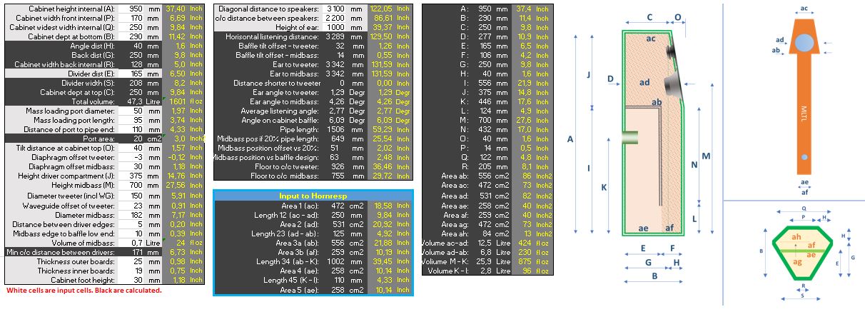

PROGRESS PROGRESS
Since the last post there has been quite some progress.

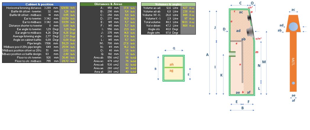

The cabinet is now a combination of inspiration from the OPUS3 Chorus (today Rauna Vale) and the Rauna Leira. Which mean a six sided cabinet with part of the front baffle tilted, and inside a coupling chamber connected to a straight line with a mass loading port. The drivers are currently thought to be ScanSpeaks, Midbass the 8531G00 and the tweeter the 2608 improved with the waveguide from the diyaudio Elsinores project.
Despite a little 1+ db dip at 100 Hz the response curve is great (run both in Hornresp and MathCad, and even better in the latter) and I have desided to live with it. All the rest of the dimensions measure great.
The six sided cabinet is a little more complicated to build. But who needs easy. It caters fo a stable build with less internal resonance (except for the annoying dip caused by the fairly fixed midbass driver position in the length of the line). Some birch wood rods will be drilled and glued stuck between a) the front and back baffles in the coupling chamber, b) front baffle and the internal divider, and c) the front baffle the divider and the back baffle at different hegihts. The great cad drawing is done by a diy fellow Neil B.

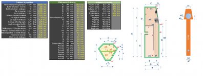

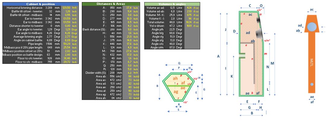

Four and six sided versions
Building capapbilities differs among people. That mean that what some can build others cant. Therefore there are two different versions. The basic design idea is the same. Coupling chamber into a cylindrical line with a mass loading port in a cabinet with the upper part of the front baffle a little bit tilted.
The tweeter will have almost zero degrees listeing angle vertically, but will also get a liiiiitle more "space" with the help from the reflection from a ceiling.
Software exploration and measures it will probably tell us that there will be some differencies between the four and six sided versions of the XO due to difference in baffle reflections.
