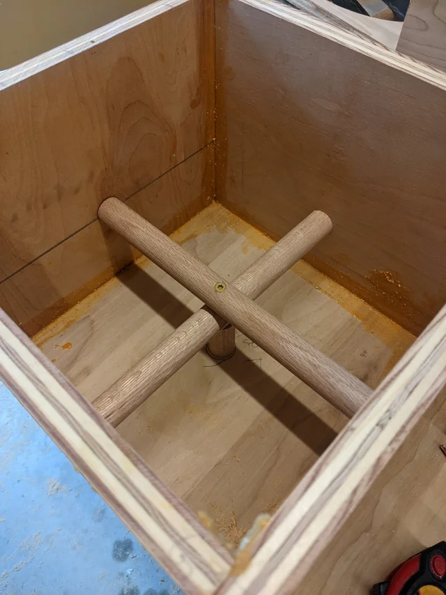

Bracing is absolutely worthwhile. Even something as simple as cross braces as shown in the photo will make an audible difference at higher volumes.
Yeah, don't listen to Dissident Sound. Bracing is highly effective and helpful. It might not be worth salvaging those speakers but bracing is helpful in pretty much every build since it reduces panel vibrations.

😀 yeah on small sub I would put a cross brace just in case, box and panel resonances are likely above pass band.
For a box that goes into midrange you'd likely want to put a lot more. For reference, a mid box I just built has box resonating some around few hundred Hz, middle of it's passband. It looks like it's the whole box mode, the whole thing resonating as one. First panel modes are roughly an octave higher, still in pass band. These are visible in impedance plot, and it's very hard to determine whether they are audible or not. My bracing is with about 15cm spacing, and if I wanted to push the panel resonances octave higher I'd need to drop that to 10cm or so, basically redo the boxes.
It's no joke to push resonances high up. Plywood box. That's why one wants to add damping with the panels or the braces or both, look for KEF LS50 white paper. And make a multiway speaker to separate concerns. If your mid box is 10cm x 10cm x 10cm it doesn't need any bracing 😉 Oh, and do a fun test, knock your box with other hand while use the other to tighten the driver screws and hear the whole thing tune higher just like a quitar. Tried using tight and floppy connection with few different damping between box /screws/driver, but the lowest resonance was still there just at lower frequency the lossier the connection, which is why I think lowest mode of mine was just the whole box resonating all together. Tigthness like this was audible with knock test, but not sure if I heard any difference with music with a quick test.
