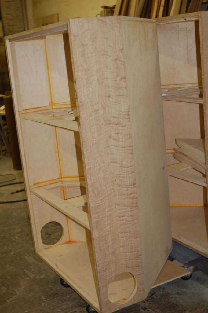

+1 This is the advice GM gave to me. 😉 I did the same thing,except my cabinets are dual 15" woofer corner boxes.I also used the window braces that really stiffen them up quite a bit.I staggered them so the spaces were 17",18",19", so they wouldn't have the same resonant freq. 😀 I'm hoping to finish these in the next couple of weeks or so.No small bookshelf's for this Gent !! 😀

Looks like tiger maple veneer, is that right? very pretty! I go through the stack of white birch ply at the Home Depot looking for wavy and clear grain. I've got some nice stuff that way.
Are you going to screw those boxes to the walls? I think it's a good idea if you do so.
Loren Thank You Kindly !!! 😉Sir! I salute you!!!![]()
Thanks ! It's actually "White Tiger Oak" and is very pretty up close and personal. 😀

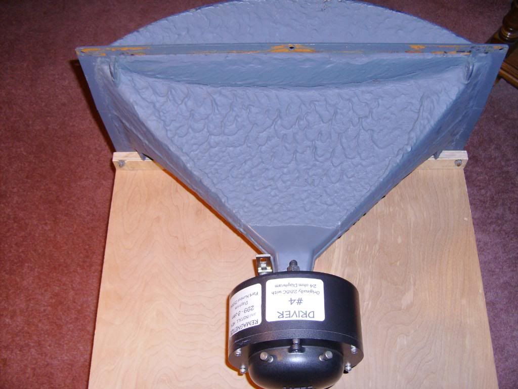

No these are floorstanders that are pushed into the corner with a 2" base that I still have to make though. I will have lots of measuring to do.I'm gonna use a custom passive XO.I'm using a 511E with a 288 or 299-8A

Nice looking , unfortunately that enclosure is poorly braced , you are about 40% where you need to be ...
