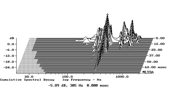

For instance i would like to see some tests results on baffle vibrations ... never seen one but i am sure there are some. I mean graph like this one here
https://www.stereophile.com/images/720P701fig2.jpg
cumulative spectral-decay plot calculated from output of accelerometer fastened to center of sidewall level with upper woofer
but relevant to the baffle and not side or back cabinet walls, very much less critical. If not of no use at all. If you think any noise emitted by the side and back walls has to reach room walls and then be reflected to the listening spot. They are already very low in level and if the reflection issues are taken care the listener hears nothing at all. Not so with the direct sound caused by the front baffle vibrations. That can increased distortion.
At the point that i am pretty sure that just a simple bracing opposing to the baffle vibrations would have a sensible effect ...

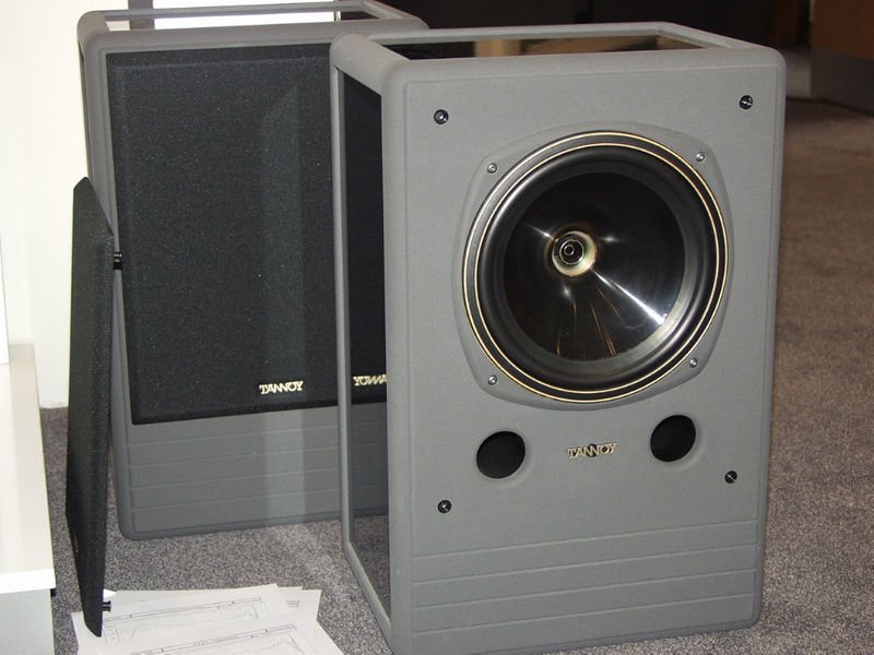

I can remember the boxy sound of an old Tannoy Eaton ... the driver was fantastic ... not so the box. Instead in the pro Tannoy DMT series
the cabinet was out of this world ... one of the best cabinet available. But many models were using a strange plastic materials for the cones ... i heard an heavy sound. Better the paper cones.
And of course i am sure that the DMT cabinet would be just exceptional for an high end subwoofer as well.
