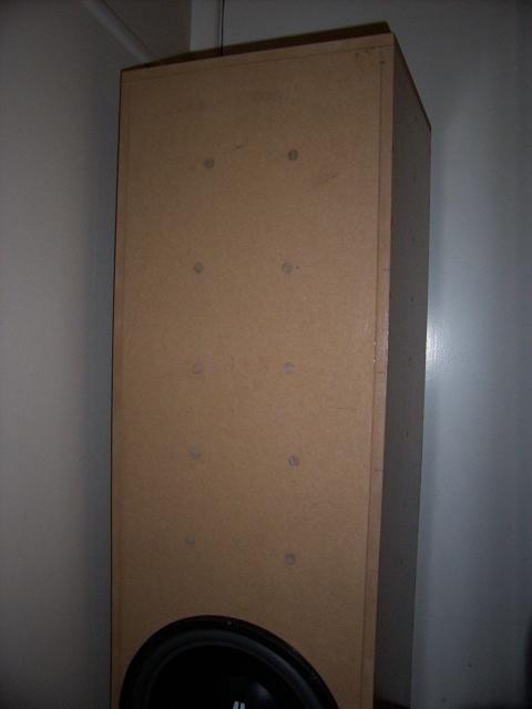

I used 16mm hardwood dowel with a looong 16mm drill to go straight from one side to the other, no messy measuring, just slide the dowel in, trim off, and glue in place:smash:
Of course, once the panel sides are cut, you could clamp them together and use a speedbore before assembly.

I'm using 2x JL15w-6 (car audio long throw subs, very similar to Adrie's tempest, but with dual 6 ohm voice coils) in push push with a driver on either side to cancel mechanical vibrations, the enclosure is divided in 2 with each sub in a seperate 85L sealed enclosure(stuffed with dacron and lined behind the drivers).
