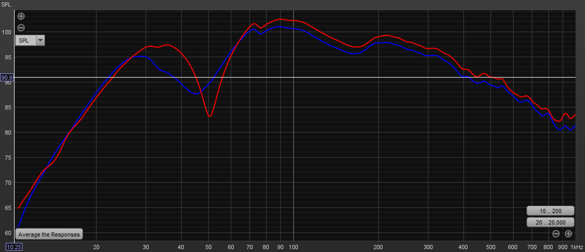

All measurements in the opening post were done nearfield (mic as close to the driver as possible, and flush with the port opening). The amplitude of reflections should be negligible compared to the driver/port.Hmm, 344/2/~43Hz = 4 m, so got any parallel walls/whatever as down low these major peaks, dips are room related and if so, then move the speaker.

If you tune higher, like say 40 Hz or more, you might get a nice bass peak. Could you try making a port half as long as the current one? Could be interesting... A flat response on paper does not guarantee a proper sounding room response, especially in the bass region.

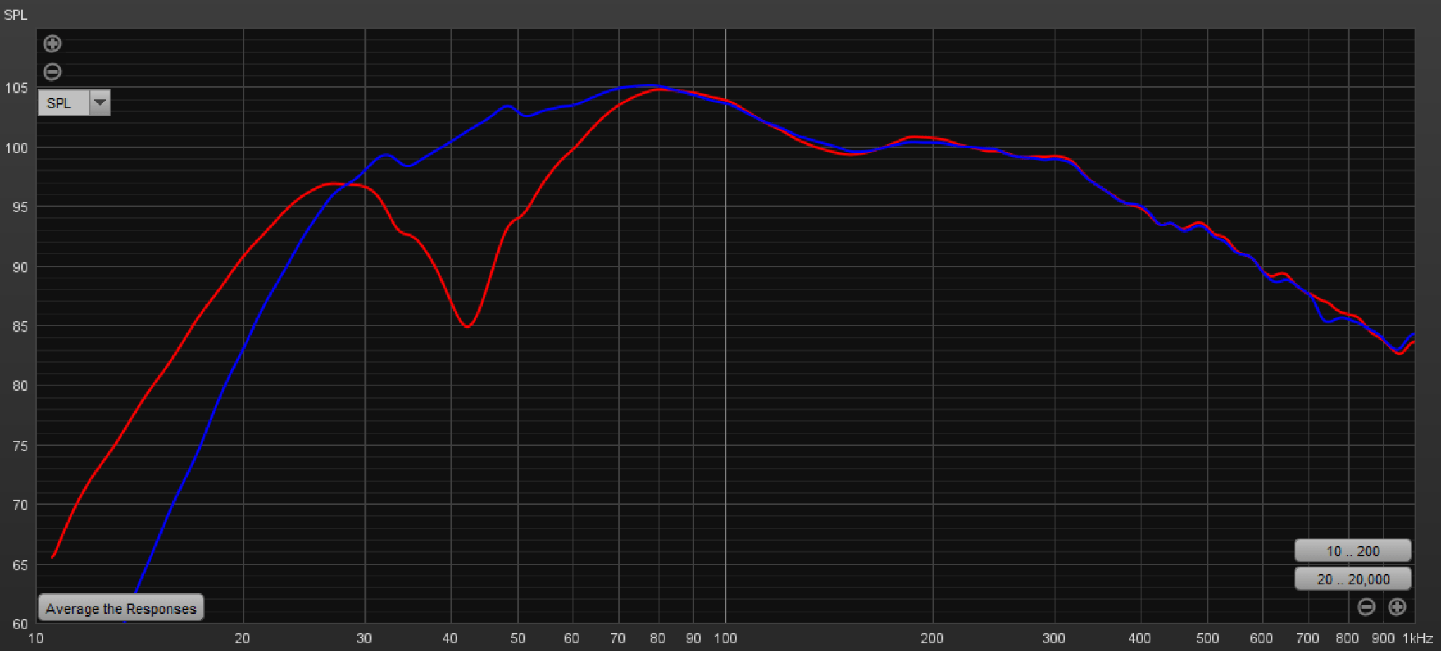

This is the summed response (driver+port) for the WinISD calculated port length. There's a huge dip in the critical area.

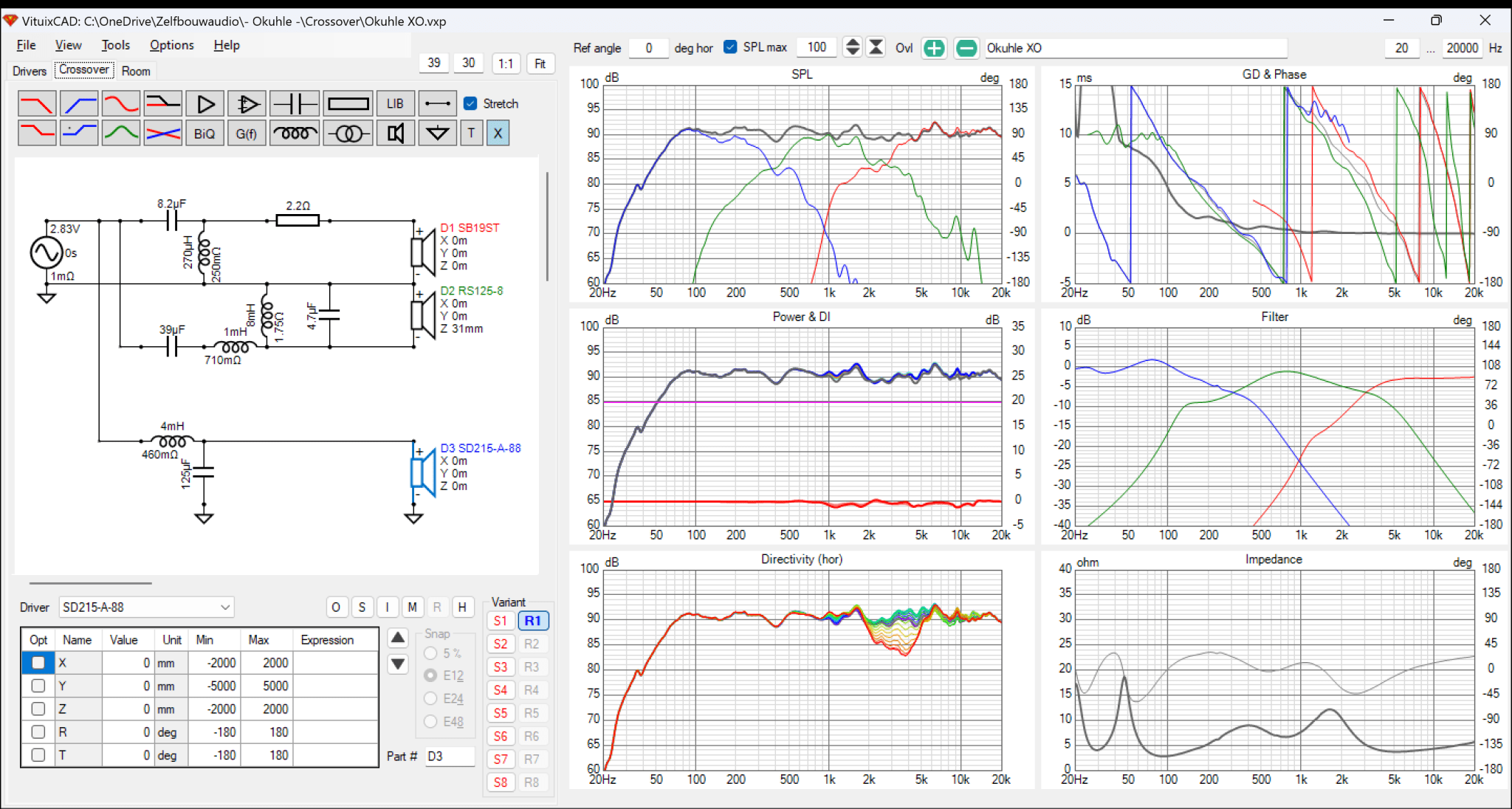

Why the difference between REW and VituixCad in summed port+woofer near-field response? I don't have REW, so I can't see the individual port and woofer near-field measurements, but summed near-field woofer+port measurements in VituixCad looks much more logical. Anyway, I suspect Thiele -Small parameters in Dayton data sheet are wrong - you should measure them.... I already noticed an early roll-off of the bass from the raw driver measurements, but didn't pay too much attention to that, as my focus was mainly on getting a linear-ish FR.
I attached my VitiuxCad file including individual driver measurements.

I could try to shorten the port even further, but going from 18.2 to 13.5cm the dip only deepened (and shifted to a slightly higher frequency). According to WinISD, this shifts the BR tuning frequency from 31 to 37Hz. I doubt going higher will solve the issue. Blue: 31Hz tuning (18.2cm port), red: 37Hz (13.5cm port).If you tune higher, like say 40 Hz or more, you might get a nice bass peak. Could you try making a port half as long as the current one? Could be interesting... A flat response on paper does not guarantee a proper sounding room response, especially in the bass region.

I'd still try an outdoor 1m groundplane measurement to see if the dip is caused by boundaries / room effect.

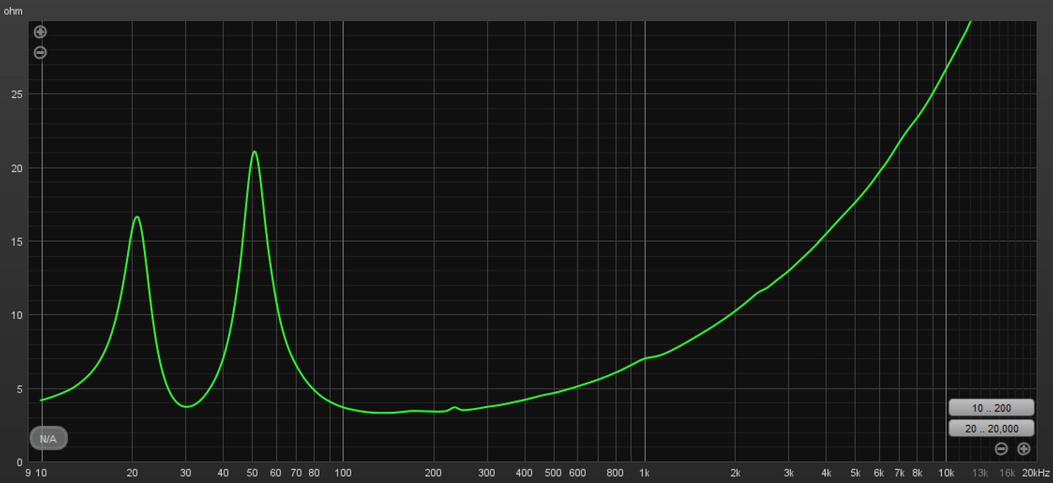

The lowpass section together with the impedance adds about 2dB at about 100Hz. I’d try to equalize the second impedance peak with a parallel notch. Did you do a SPL measurement of the port?

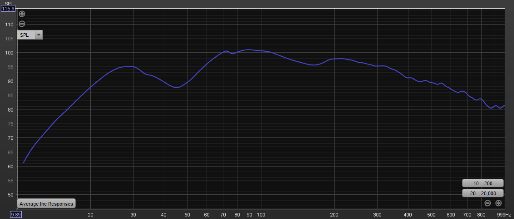

I think I solved my conundrum. The dip at 45Hz looked to me like the port and driver are out of phase, which got me thinking. For farfield measurements I use a loopback for timing reference, but for nearfield I set REW to 'no timing reference'. So this time I went to the 'Impulse' window in REW and clicked 'Set t=0 at IR start' button for both the driver and port measurements, and then summed both again. This time the plot looks a lot more like what I would expect. The blue line is with timing/phase correction, the red line without:
I'd either lengthen and shorten the port and see what it does (lay some pencils in it to lower the frequency), or better still, take an impedance sweep.
I already have an impedance sweep at a port length of 18.2cm (as calculated by WinISD). The tuning frequency is nicely at the calculated 31Hz. As the port is slightly tapered, it's hard to predict the actual tuning frequency if I shorten it significantly. But I can ofcourse always check it by doing an impedance measurement.
