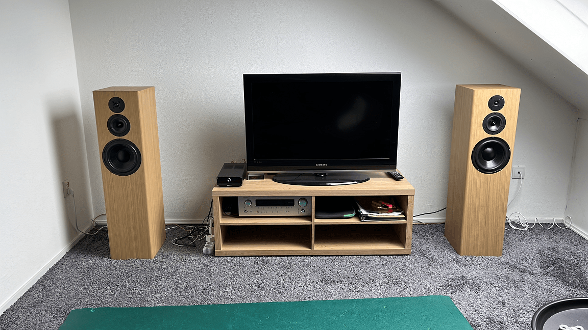

Ah, okay. There's a Dayton RS125 for the mids and a SB Acoustics SB19ST for the highs. I can supply the VituixCad file if needed. Here's a pic of the system (the Denon amp isn't in use anymore).While that is interesting i am asking ore specifically about the speaker.

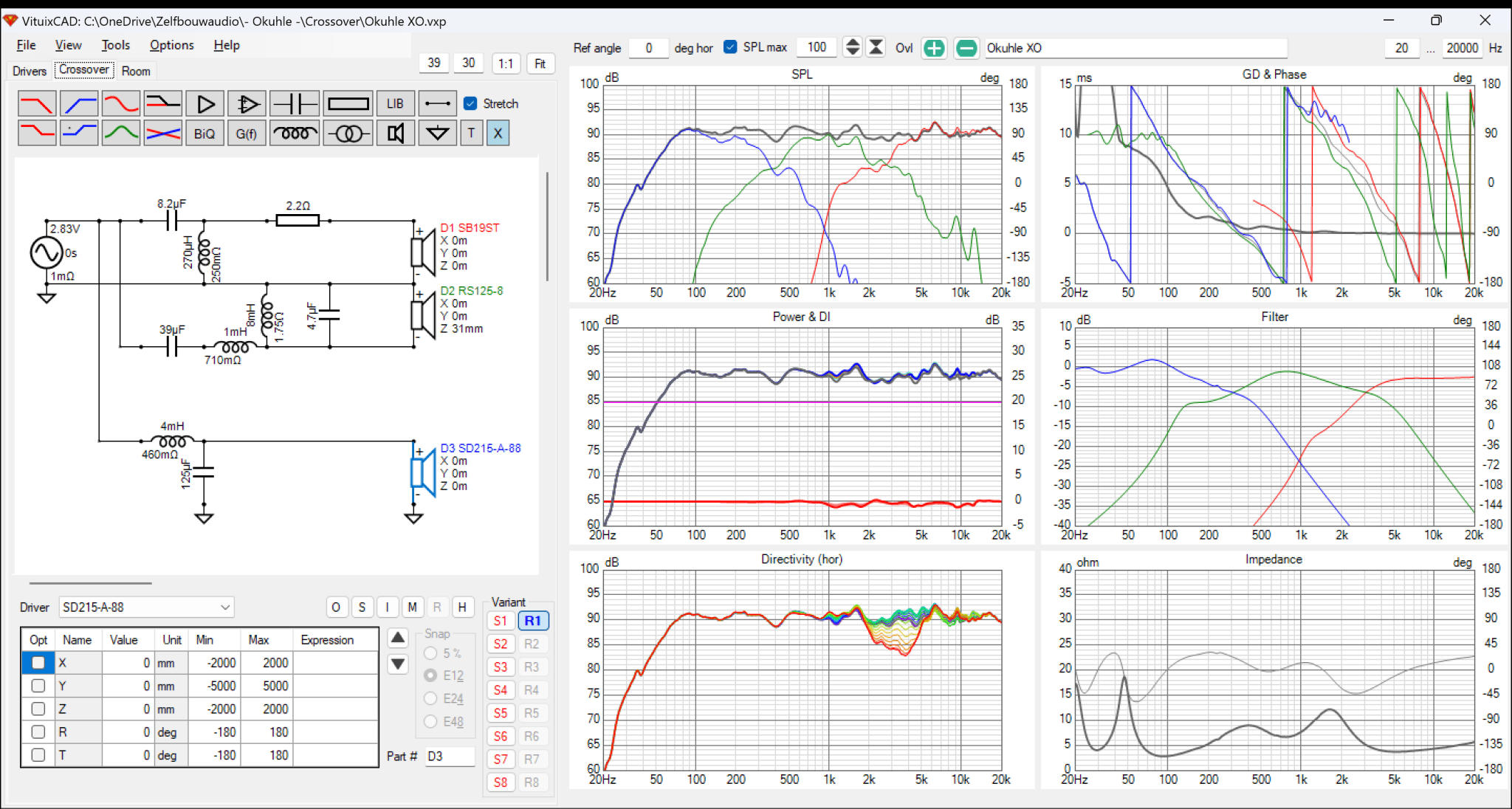

What is your X over to the mid and what crossover do you use? It could be the series inductor in the crossover combined with the second impedance peak that cause the peaking at about 100Hz. Should be fixed with a LCR circuit to flatten that second peak.
This is the crossover. All 2nd order. XO points were 370 and 2.2kHz. Crossover was designed using individual driver measurements (quasi-anechoic). I already noticed an early roll-off of the bass from the raw driver measurements, but didn't pay too much attention to that, as my focus was mainly on getting a linear-ish FR.
I attached my VitiuxCad file including individual driver measurements.

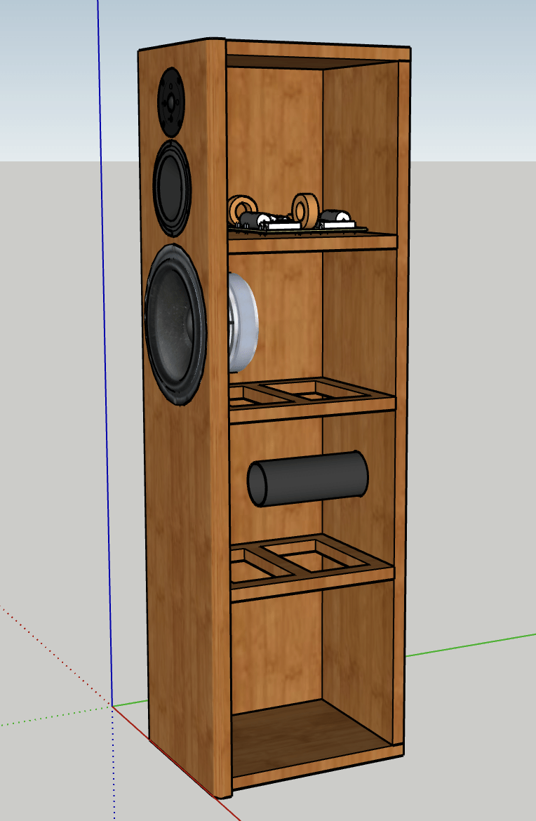

I don't know much about TL's, but here's a Sketchup dwawing of the speaker with a side panel removed.Where is the vent?
Given the shape of the box, you likely have an ML-TL not a BR.
