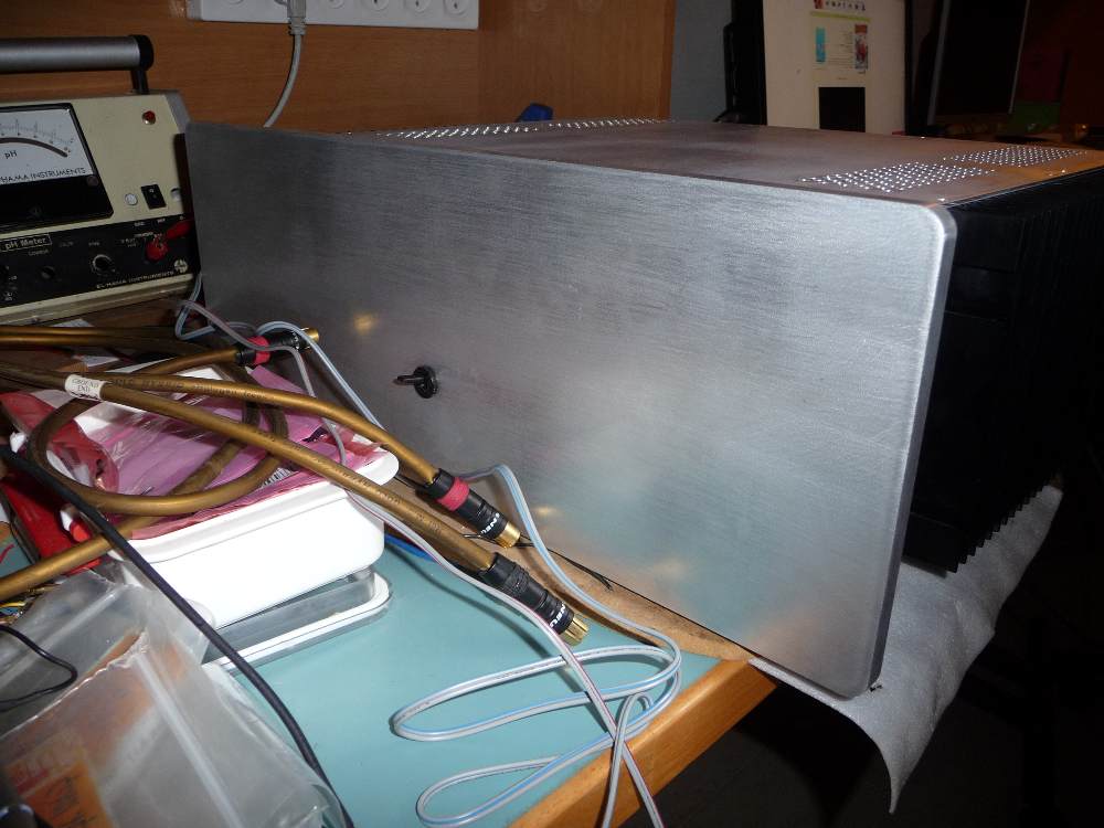

front slab:
I wanted to buy a case but could not find one with right dimensions to accomudate two monoblocks together without being too big. I ended building the case from aluminium pieces I bought in a metal shop. the front slab is 11mm thick in order to carry the two toroidal transformers. each central screw is held in place by an alunimium disk bolted to the front slab. A friend of mine has an old milling machine so I could bring the slabs (front and sides) to the required dimensions. since the front is so thick I had to remove some material to sink the power switch in and allow the neck to pop out on the front. the heat sinks came from a junk shop. it cost about $22 for 4 pieces and is in relatively good cosmetical shape. only the front and heat sinks together weight over 7 Kg. the floor is 4 mm thick to allow for structural support and facilitate threading of all mounting holes. almost everything is screwed directly to it.

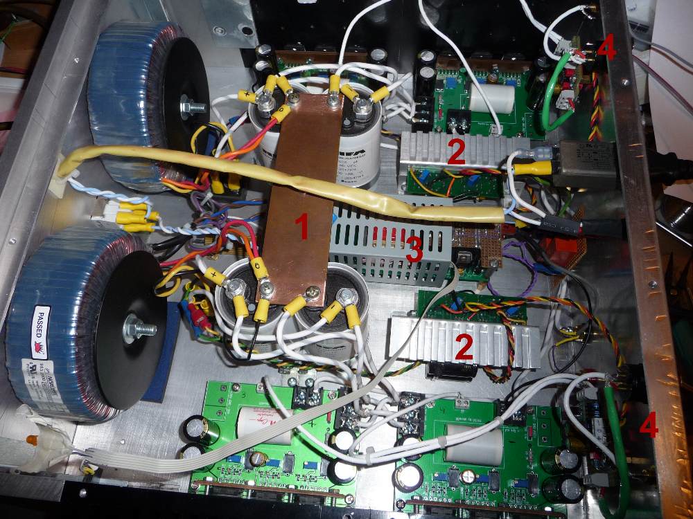

overview:
in the overview image, besides the parts you all recognize, one can find (1) common ground (copper slab) which is also a mechanical support for the capacitors and ground disconnect network (attached below). (2) PS for the input buffer mounted on a heatsink taken from a broken PC PS. this is a TeddyReg from PinkFishMedia fitted with trimmers to allow for voltage setting. I'm glad I fitted them in since it allowed me to tune 18V for the DRV and 15V for the OPAs without taking the PS out and replacing resistors. (3) soft start and DC protector. this is a nice device, bought from a very nice guy on DIYAudio (Murray the aussie). it is PIC controled. one can see the power resistor bolted to the floor below the mess of wires between the transformers and the loudspeakers relays (in red) on the back panel on the right. also attached to the back are the input buffers (4).

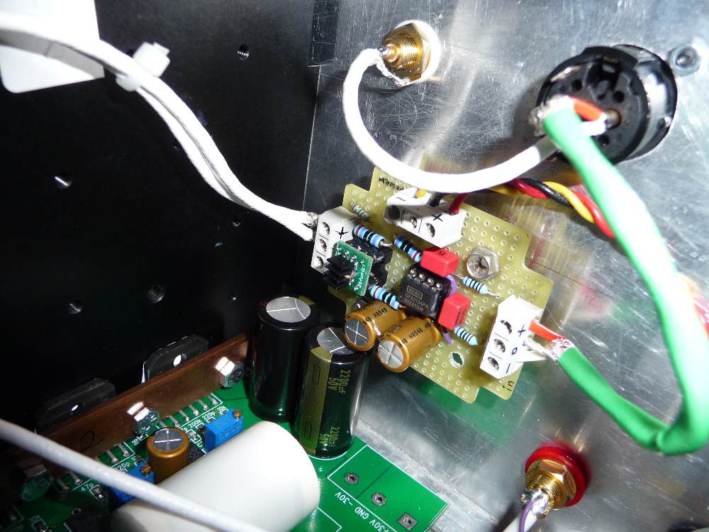

input buffer:
on the left one can see the LM3886TFs held in place by a copper bar screwed to the heat sink with thremal paste to enhance heat transfer. in the center is the input buffer implemented on a strip board 6x5 cm is size. one can see the patch over patch - the SO to DIP adapter and the tiny heatsink (which gets pretty hot) on the OPA1632. if someone is willing to produce a full SMD board with the OPA1632 in thermal package soldered in place and holes in the right position (I can't stand the thought of drilling more holes!) I'm in for 4 borads.

Pic 1 post 1047 shows a plate across the smoothing caps.
That plate has two sets of red/orange. These must be the centre taps of the transformers.
The plate also has two black and two white wires attached to it.
These will all be at different DC voltage and different AC voltage from each other.
What are you tying into these wires?
neither can I.
the red/orange are indeed the center taps. the black is the 0V for the PS of the input buffer. the white is the 0V for the PA150s. this arrangement is duplicated per channel. having a single instance of DC protection, I MUST have 0V to be one over the entire amplifier.
the two transformers share only this point and otherwise float so I don't expect to have any voltage drop along the long side of the copper slab. can you see a reason for such drop to develop, i.e. a reason for the transformers' secondaries to be fixed by other potential, different for each?
regarding the short side, there is indeed current flow since the capacitors charge, and it is not symmetric between positive and negative rails. however, I used heavy gauge copper in hope its conductivity will dwarfs any currents flow in it. in practice I cannot measure any (neither longitudal nor transversal) voltage drop but I have a cheapo DMM (about time to upgrade).
If you find my logic above flawed, please explain. I learn from each comment.
for noise, besides the scope, I use the ear inverse distance test. the closer I have to put my ear to the loudspeaker in order to hear noise (given I can tell if it is hiss or hum) the lower I grade the noise (and of course better the situation). this cannot be done of coarse for the input buffer. there I rely on the scope and simply assess the width of the noise band I see on the screen.
Schmulik, from what I can see your basic problem is the grounding. Most likely you have lot's of ground loops and lot's of wiring.
the four attachment points are separated. This will develop different voltages, both DC and AC, at the four different points. Guaranteed.I MUST have 0V to be one over the entire amplifier............
........ I don't expect to have any voltage drop along the long side of the copper slab. can you see a reason for such drop to develop,
Do not locate your zero volt reference on or in the smoothing capacitor bridge/link. Never.
From what I can see you are having two separate transformers so you can form two mono blocks. Try to do the wiring as two separate amps in one case. The balance to unbalance to balanced circuits may be fed from a separate power supply if you can't manage the ground loops. Pay also attention to short wires, especially the ground wires. Wires have 1 nH per mm and this can be devastating if you have fast circuits.
this was my intention from the start. I had to compromise since I have (and will have) only one DC protection device. I could decouple it from the amplifier (optocoupler?) but I'm not there yet. I agree with your observation on wires. it needs more structural thinking. as for the input section, a separate transformer is possible (if I manage to squeeze something into the already crowded chassis). hopefully I'll manage without. BTW, I prefer to think of it as balanced to balance that can be used as unbalanced to balanced. after all, there is no point in the circuit where to two phases are united.
Andrew, in what scenarios you think I will have the largest voltage difference and how do you suggest I measure it? Also, please explain more about the problem arises from my zero voltage.
currently, I don't like the sound of the amplifier. it is not as detailed as I hoped and does not meet my standard (very old but strong tube amp). I entered this project after building a single LM per channel amplifier with a (single) regulated power supply that really surprised me with its clarity and kick on my sensitive mid high part of my speakers. I'm trying to get to someone to help me with measurements to pinpoint the problem.
again, I'm open to all advices regarding what measurement are to be made. I have no experience with such debugging.
Schmulik, if you manage to get it right the LM3886 is an excellent amplifier IC.
As I said: Think double mono block.
