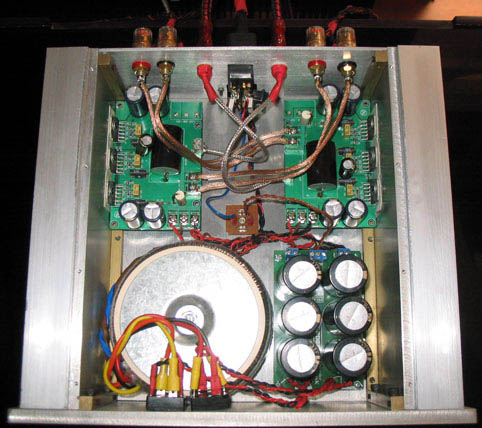

Hi Alexw88,
This is not 100% Finished, Chassis not yet anodized and i will modify PSU using Carlosfm design and change the trafo with 300VA 2x25
I will use this PA150 for my front end Home theater.
I build this with standart part and only cost me around $200... so far i'm very happy with it.
After this i will build 5 channel PA150... soft start+speaker protector.
Alex, Why you don't want to make another PA150 beautiful pcbs , I sure some people in this forum have interest to build BPA300,
If you don't like to manage logistic, i will help you to do that or even they want soldered smd part... i can do that too...
Best Regards
Jopie
Best Regards
Jopie
