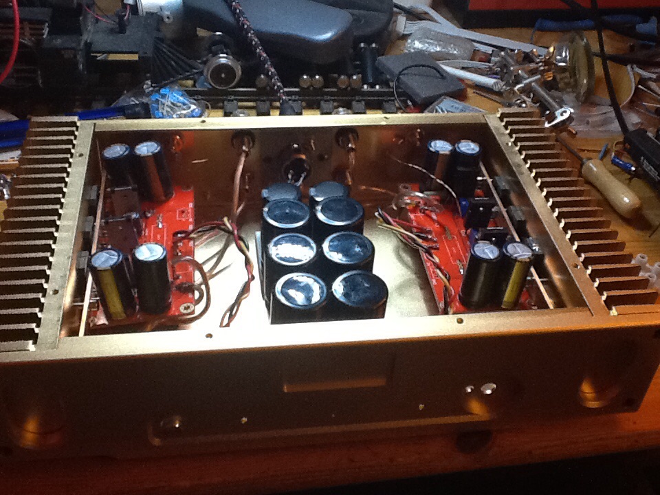

if you don't mind my asking, what do you use to drive it and what do you use for the input cap, if any, that i'm guessing you may have mounted under the board.
No Input cap. My preamp is from Richard Murdey. There are two Black Gate caps at the output. The PSU is the snubber version. The Toroid ist 2x25 V 600 VA. All resistors are TKD from Thel Audio in Germany. The Feedback resistor is direktly soldered from pin 3 to Pin 9 at the LM 3886 with 9 pF Silver Mica cap in parallel.
The 0.18 Ohm are from Isabellahütte 3 Watt manganin.

sure there is drift.
with quality components drift during warmup is extremely low.
here's what i'm getting for each chip's output offset:
cold:
0mv 0mv 1mv / 1mv 0mv 0mv
hot:
1mv 1mv 2mv / 4mv 3mv 2mv
the worst case delta on the first board is 1mv
the worst case delta on the second board is 2mv
the worst case net delta side to side is under 3mv (with one side hot and one side cold).
3mv into either 8R or 4R is less than one milliwatt.
i'm reasonably confident the chip can handle that. 🙂)

little higher supply voltage
Hi
I am building a clone of this amp. My toroidal is sligthly higher voltage 2x28vac. Will this have any affect on the component values?
Regards Morten
Hi
Regards Morten
You should check your PSU output voltage when mains is at maximum of the supplier's tolerance.
The 3886 have an absolute limit of 84Vdc, when signal is present.
If one channel is disconnected, then the remaining channel will see a higher supply voltage due to less loading on the PSU.
