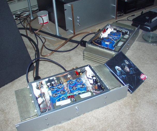

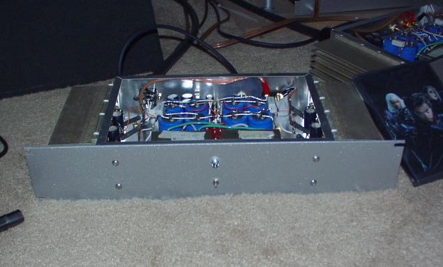

Ok, you asked for it. If someone wants to host bigger pics let me know, otherwise, this is all i can post ... i take back what i said before, the amps are crazy loud. Quite nice sounding too. My wife was really impressed. I can get them to distort if i do crank em, but i also had both my main speakers plugged into one amp to see how it did w/ a 4 ohm load...handled it quite nicely even when cranked... got a little warmer, but the heatsinks although not optimally positioned, worked fine.

DC offset is about 2mV. Very little offset. Idling heatsink temp is very cool. Sinks get quite warm into 4 ohm load, but they never get hot even when driven hard into an 8 ohm load. If you wanted to drive PA speakers, i'd have a 800-1kva toroidal PER channel 25-0-25 or 30-0-30 would work, although 25-0-25 would be better i think. I'd really like to finalize a pcb for this amp, now i've proven the design works ptp... although it was a lot of work to get these things soldered up. Anyway, good luck w/ it if you do decide to use it
