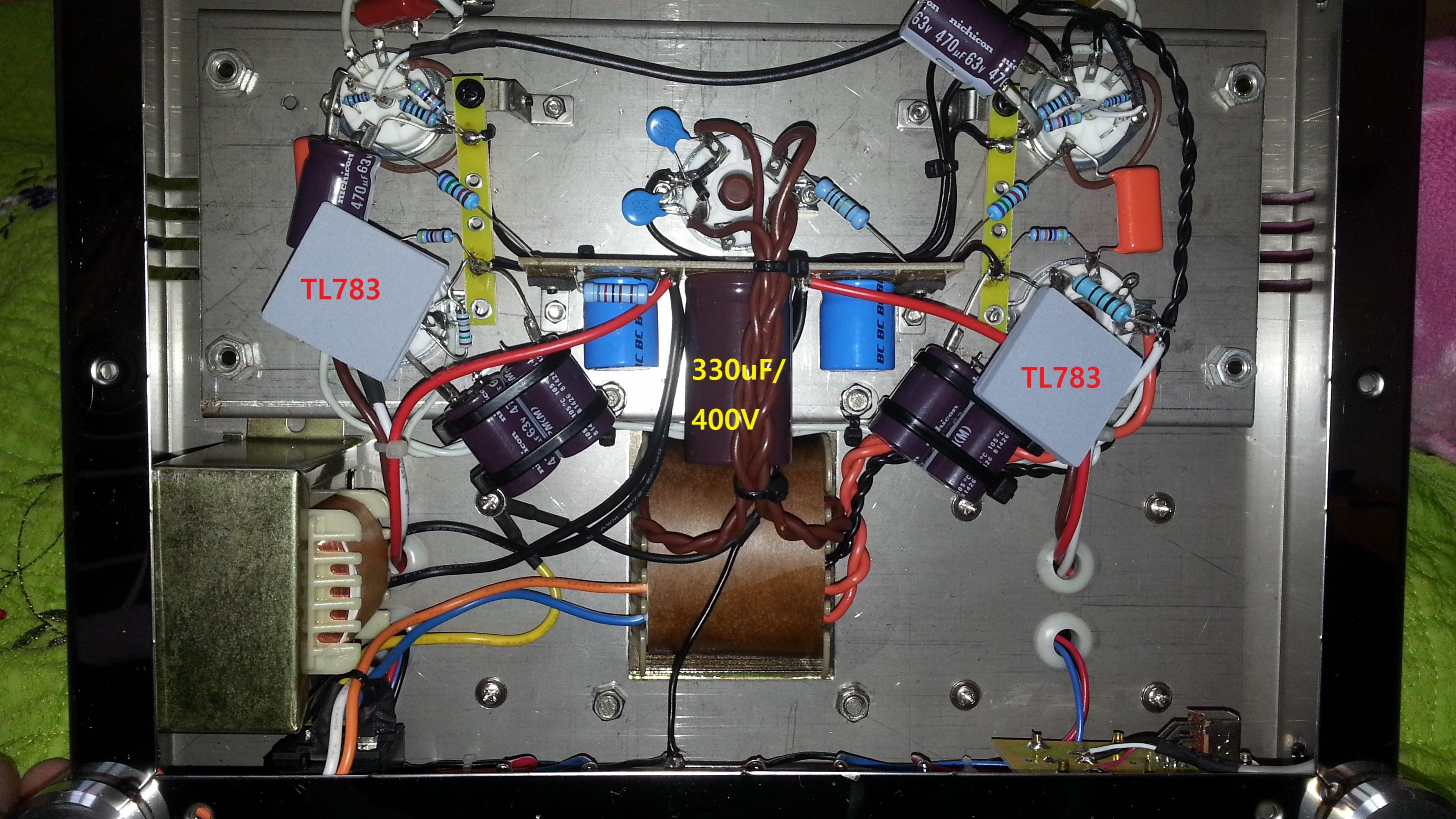

My A10 is Wiring version.
Enjoy for KT88 tube.

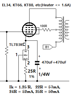

I changed the bias method to CCS(Constant Current Source).
CCS circuit is TL783KCS(125Volt) with Ceramic Heat sink.(The IR thermometer indication approximately 25'C...very cool)
Cathode resistor 500 ohm exchange to CCS 50mA(1.25Volt/25 ohm 1%).
It is not necessary to calculate a bias resistor every Power tubes.

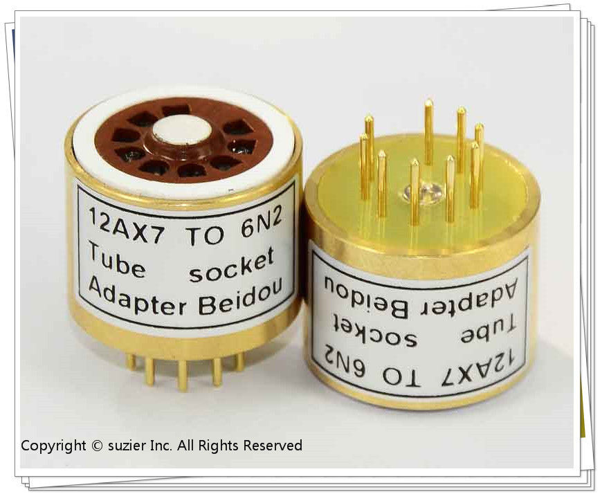

* Voltage tube to 12AX7 with Socket.
* Rectifier tube to 5AR4.
* Power tube to KT88.
Best Regards.

TL783 CCS circiut for Any tubes...
Hello Dear.
TL783 buy from ebay, amarzon, aliexpress...or TI free sample(max 5pcs).
with Ceramic heat sink(cool pad).
The heat sink is not necessary for a fact if I calculate thermal resistance of TL783. It is not hot even if I touch it by finger.
Firstly I bought it to work in LM317.
Because LM783 is FET structure, thermal resistance is good.
However, in LM317 a heat sink is necessary for the NPN Transistor structure.
Best Regards.
