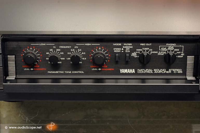

It might be medieval compared to the technological level of other members, but, here is my trick:
Yamaha C-85
Play the revealing piece of music and:
1. Bandwidth to minimum;
2. Level to minimum;
3. Search with the frequency knobs...
