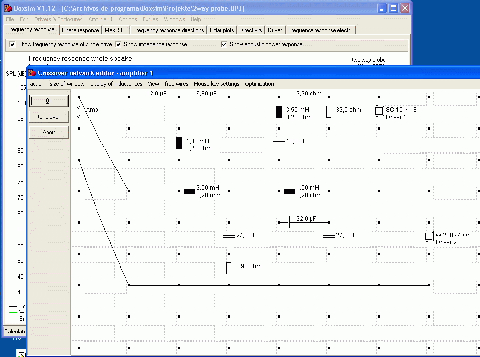

Some interesting things can be done using the free matrix filter editor.
For example this high slope two way xover (a la Jason Quadra) for a couple of cheap Visaton drivers
