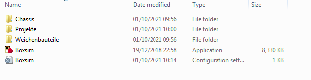

BPJ (projekte) files include the Version 1.2 driver files, so can be imported to the projekte folder.
The fifth text file, Boxsim.ini, is created on first launch of the program. So can be deleted and recreated.

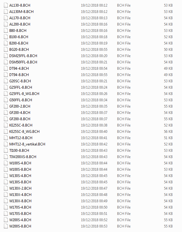

Bottom line is the old 18kB chassis or driver files are largely compatible with the new 54kB driver files, which include actual off-axis measurements rather than calculating them. But you don't get half as many driver files in Version 2. Pretty much the paper and aluminium midbasses and a few tweeters.

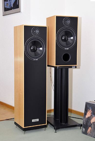

A lot of forum interest in Boxsim started with cloning the expensive WLM La Scala speaker.
My best guess was it was something like this:

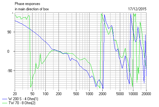

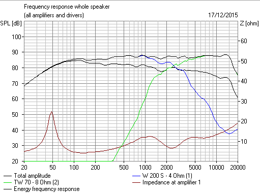

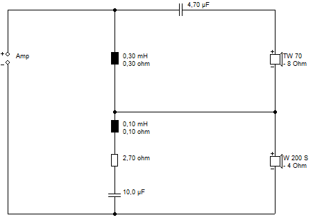

This upload might work. It is my attempt at using the W200S-8 and a very similar Monacor HT-22 cone tweeter with 4th order tweeter. Boxsim 1.2 of course. My current listening as it goes. But I have tried other things too, as in the simpler circuit below.
Might save somebody some time. The tweeter file goes in the chassis folder. The project file goes in the Projekte folder. Should work in Boxsim 2.0. I'll just add system7 WLM La Scala to help google find this.
