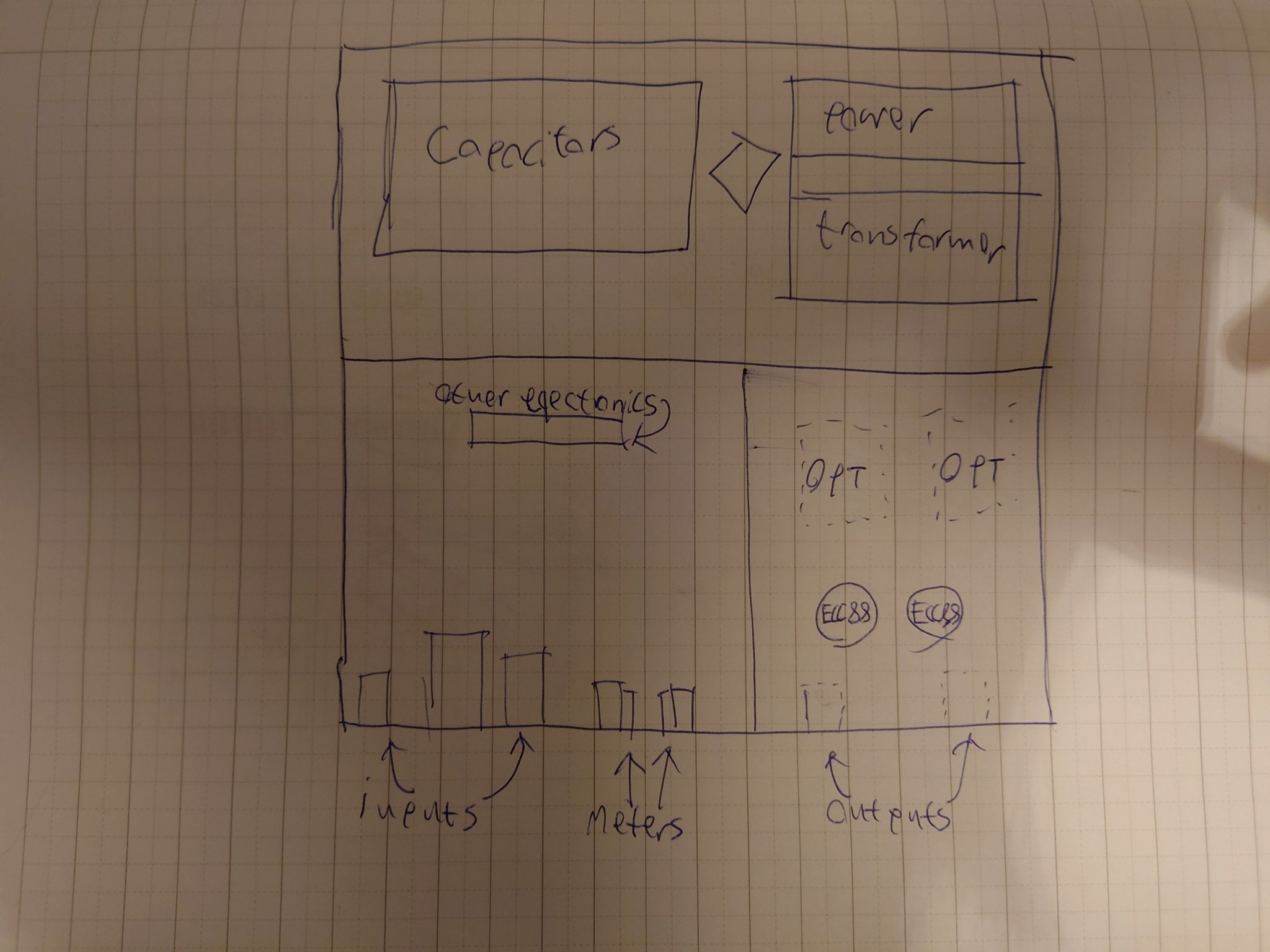

Hello, starting my first build with OPTs today, along with a power transformer I wound myself just yesterday but as all of the transformers are unshielded and I have some mumetal around I was wondering if it would be worth the time to construct some boxes around them to keep any interference away?
Maybe just wasted time and definitely something I could add later but thought I'd ask 🙂

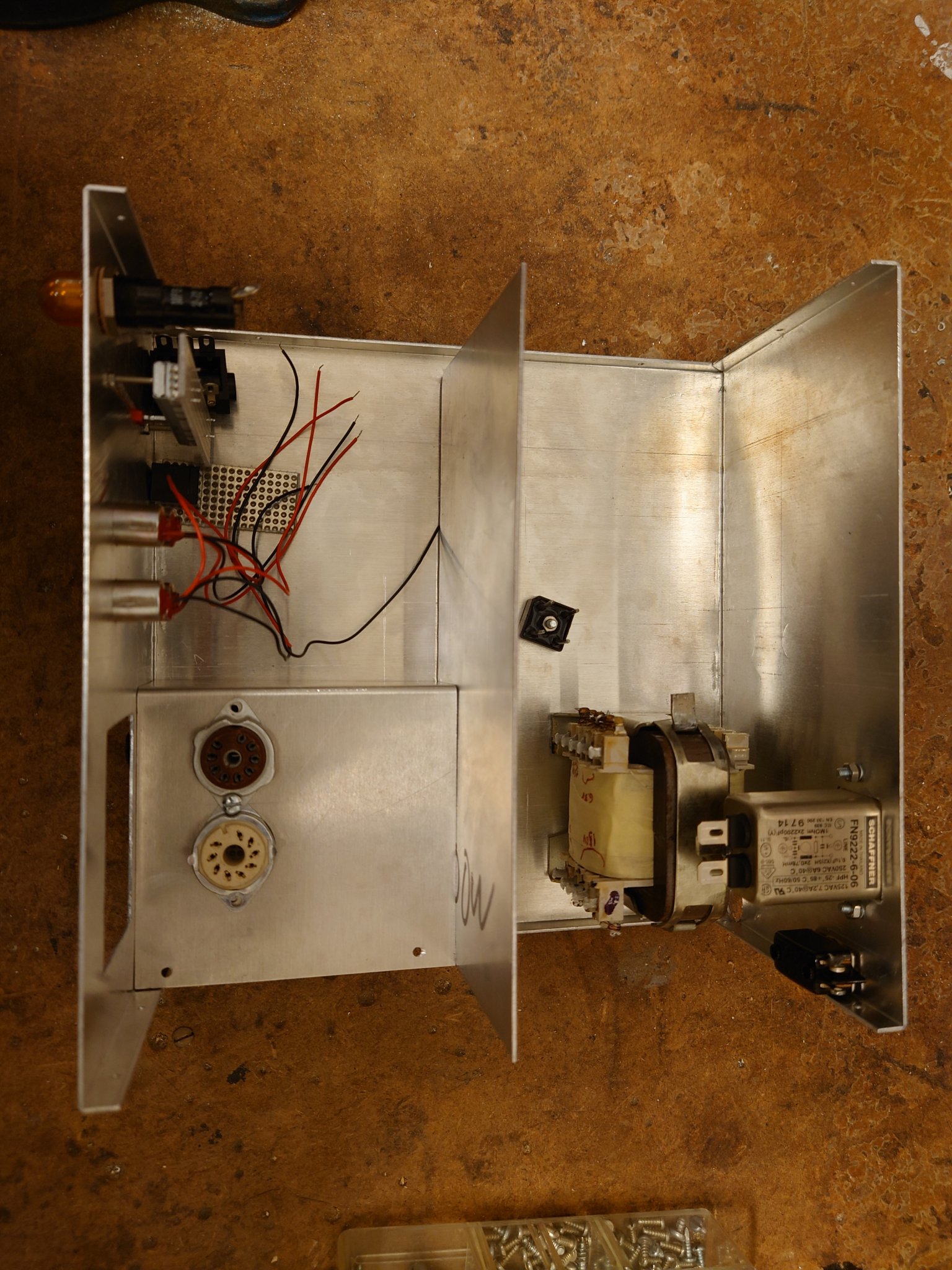

Also ended up boxing in the OPTs together in an aluminium box just by necessity of the physical layout of my case, not sure how well aluminium does at shielding magnetic fields but it's probably better than nothing 🙂

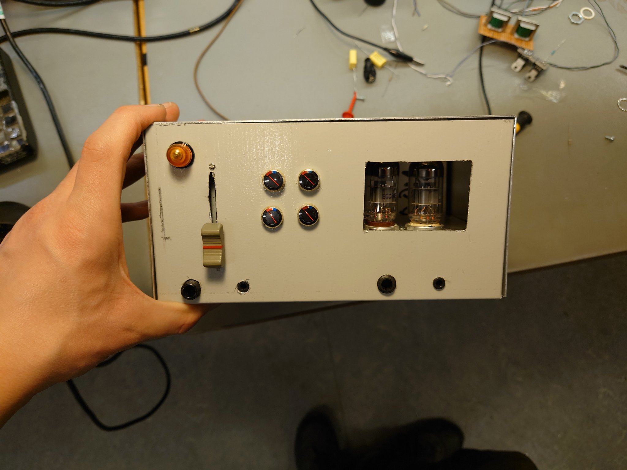

Attached a picture of how it's looking from the front atm 🙂
Power light, volume slider, left and right chanel VU meters and heater and HT is the plan for the small round meters and the tubes are a pair of ECC88s!
