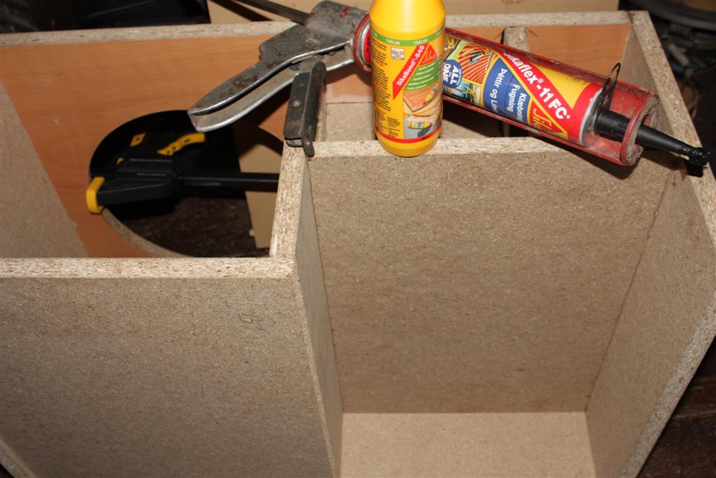

but these days I mount them with flexible and strongly sticking silicone, and no screws
but I mount them after assembling
I consider it like corner bracing, just stick it on, let it dry, and done

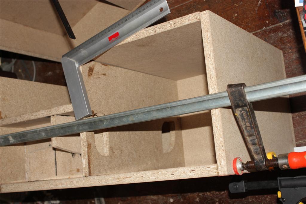

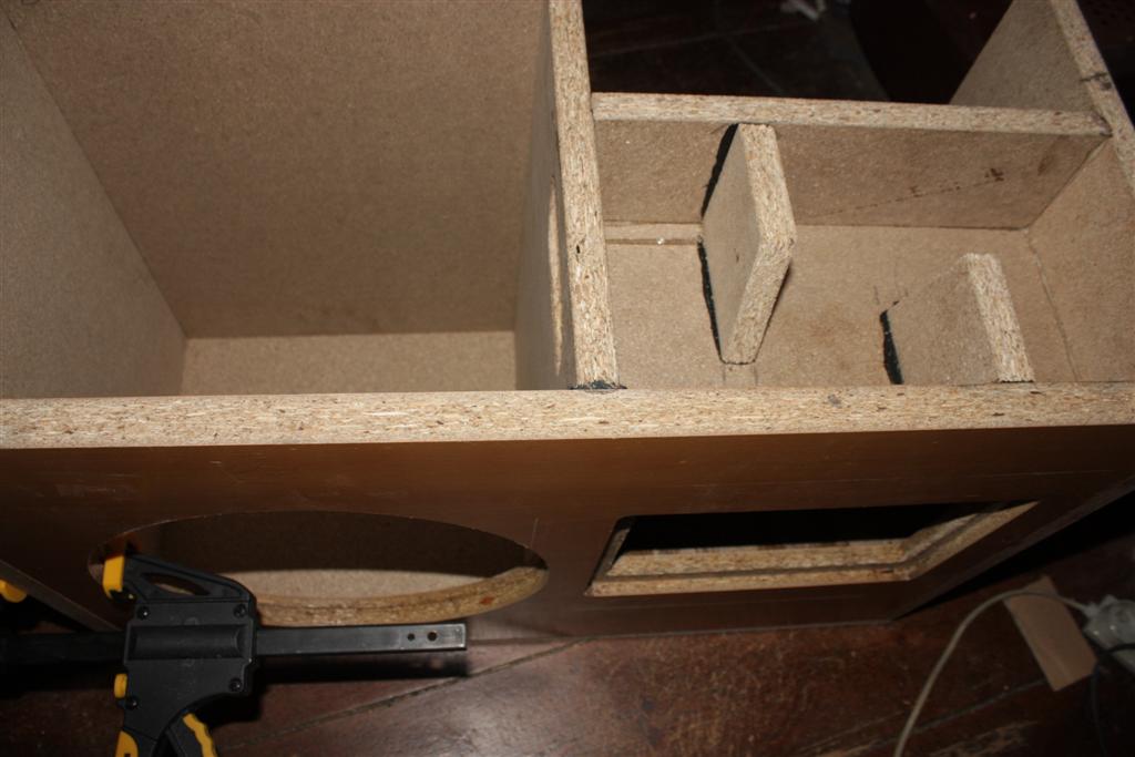

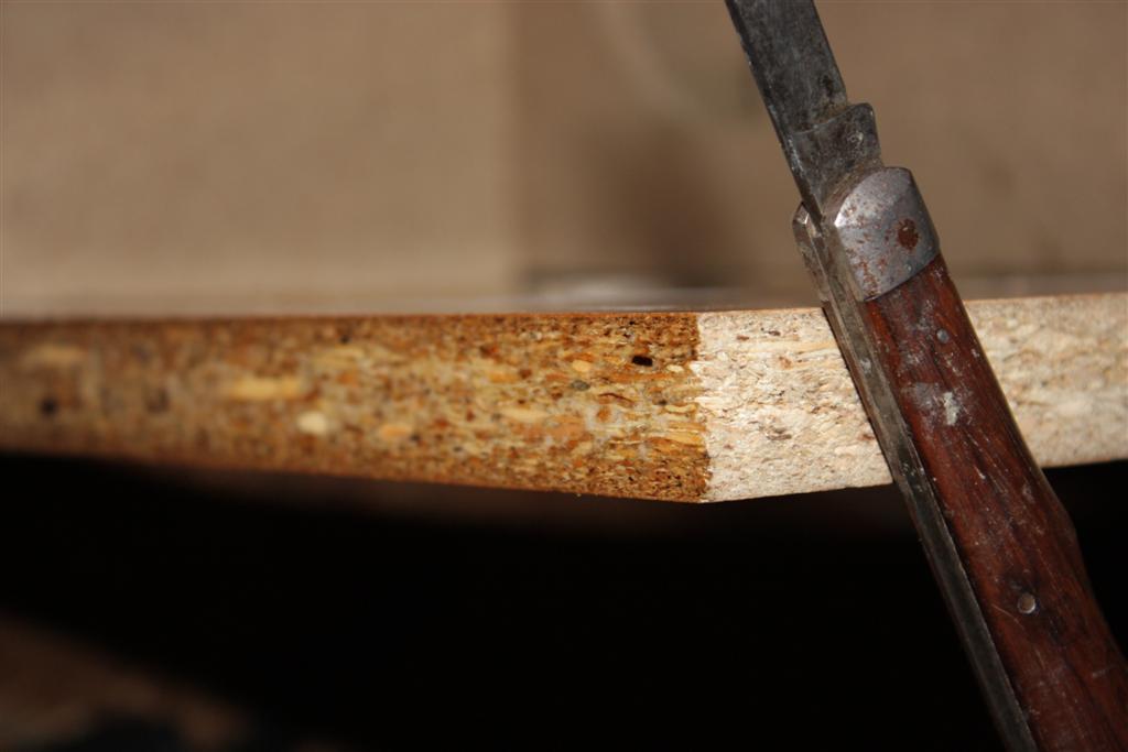

one major important thing, be it expencive plywood or cheap particle chipboard, all cuts needs to be 100% straight and perfectly angled, or it will suck big time
and still a good idea to check angle when assembling

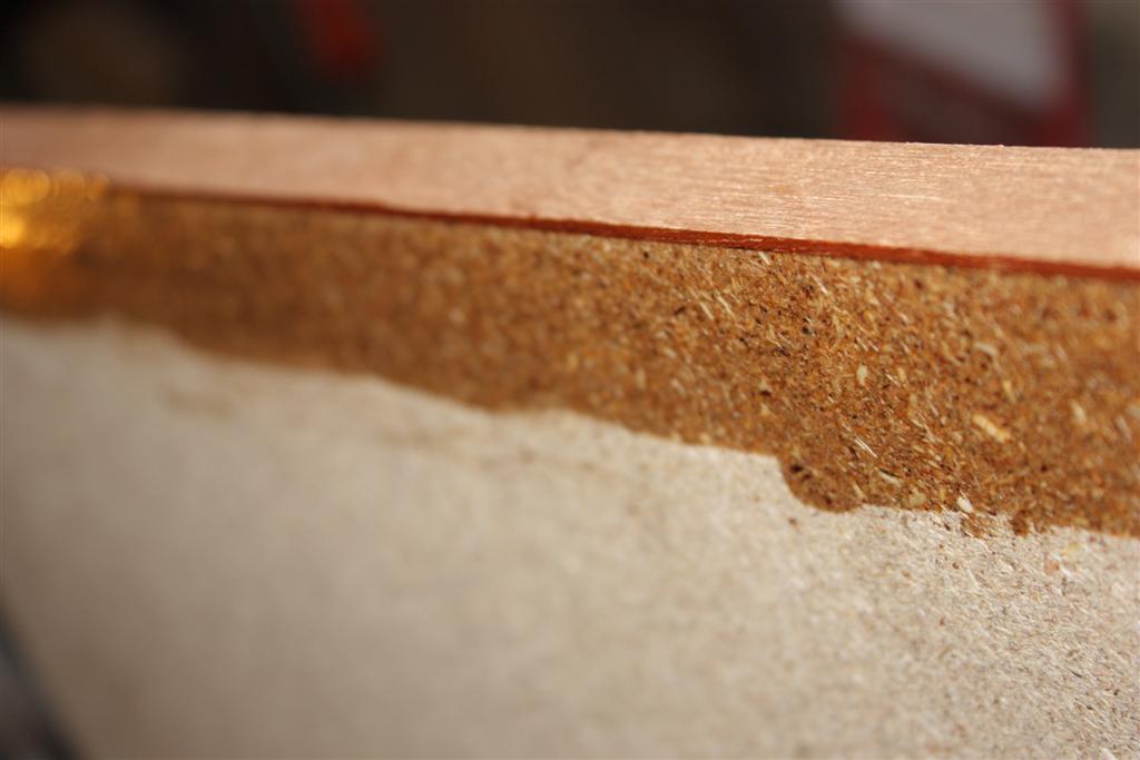

managed to assemble bottoms, and shoot a few pictures showing soaked joints
I keep applying glue to both joining parts, layer by layer, multiple times until its fully soaked
