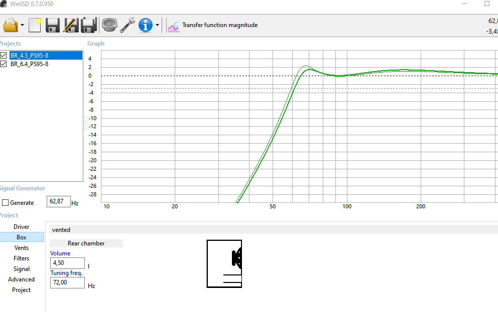

I have couple pairs of Dayton PS95-8 speakers. Currently have built folded TABAQ (ML-TL) version, and the sound is "good" in most of the range and OK or "almost good" at best in the lower Hz. The volume of the TABAQ box is ~9.5 Liters. Obviously the thing those speakers are lacking is decent low end extension. PS95-8 for my ears are not much into sub 70Hz range which TABAQ boxes are made for.
It looks like I have to do the obvious: to reduce box size and probably go with simple bass reflex or closed box just for the sake of simplicity. I don't think I can push those drivers very low. Don't get me wrong - I would like to have some bass extension, but... I am trying to be realistic about driver capabilities.
Tried WinISD, but I don't get good results with it. With closed box the sim results are disappointing. The vented box show some promise, but I am not happy with pretty much all of the results. The only one I like is ~4-4.5 Liters and ~70-75Hz tuning.

For max linear response you need something like Vb= 6,4 liters and Fb= 69Hz and that would be my choice for BR.

Vb= 6,4 liters and Fb= 69Hz - how you came with those numbers? I can get very very similar results at 4.5 Liters and Fb = 72Hz. Screenshot of Winisd with 6.4 and 4.5. Probably also there are many more similar tuning variations couple of Liters around 6.4L and couple Hz around 70Hz, but... does it mean that the sound also will be very very similar?
Thanks in advance.

With these popular formulas:Fb= 6,4 liters and Fb= 69Hz - how you came with those numbers?
Vb=20*Vas*Qts^3.3
Fb=Fs*0.42*Qts^-0.96
F3=Fs*0.28*Qts^-1.4
Yes.I can get very very similar results at 4.5 Liters and Fb = 72Hz. Screenshot of Winisd with 6.4 and 4.5. Probably also there are many more similar tuning variations couple of Liters around 6.4L and couple Hz around 70Hz, but... does it mean that the sound also will be very very similar?
Formulas are approximate assuming average losses. Small variations wont make any significant difference, as shown in your sims. If 4,5liters/72Hz better suits your design goals go for it.
