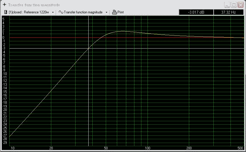

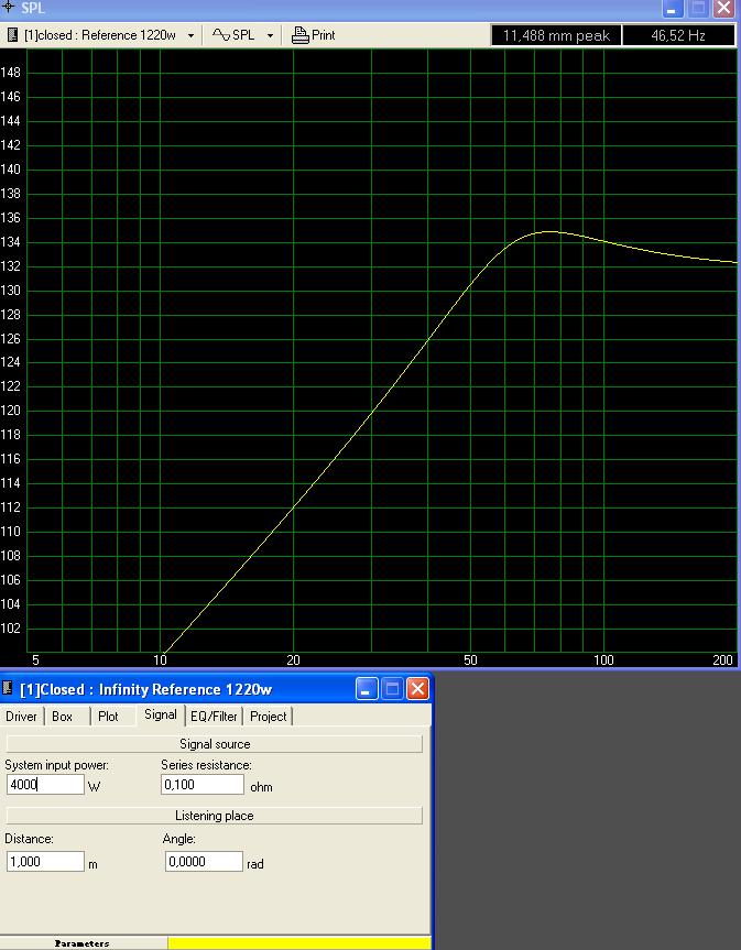

Here is the response of your woofers sealed in your box with bracing to stiffen it up, with 4000W RMS imput.
Don't port your box, it's too small to port it, you will gain absolutely nothing in output, the sound will also be worse.
