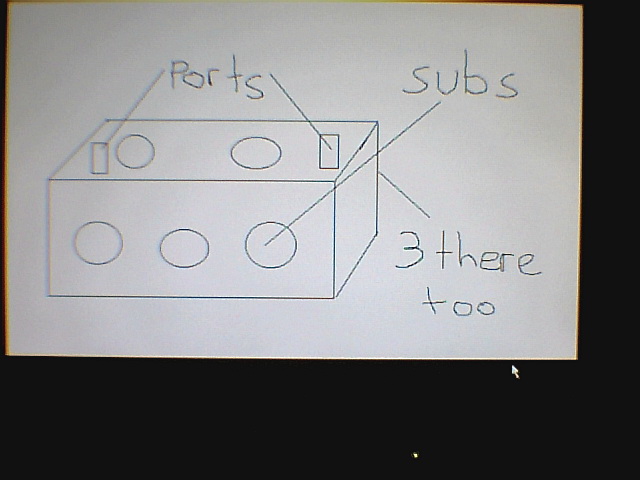

You're putting 8 12" woofers in a box that size? I don't think so. Ported or sealed, it's going to sound awful!

If yes, port the box around 40-50 Hz or so.
You will need T/S parameters to do this properly.

I deeply suspect that with 8 12 inch woofers that it's physically impossible to achieve enough vent cross sectional area to tune a box of this size to any usable frequency.
OMG!!! he took a photo of a printout of a drawing... PLEASE go away now.... 🙂 thankyou.

38 " wide
21 " depth
18 " height
which is:
96.5cm X 53.3cm X 45.7cm
I'm sure youre smart, so we'll assume they're internal dimensions.
so, thats 235 litres.... lets say.... 10 litres for bracing, so 225 litres, meaning 28 litres per woofer... woofer displacement will be around 2 litres, so 26 litres per woofer.... now each woofer would need a 100mm port. (I'm ignoring whateve you came up with) so, to tune a 26 litre box to say, 40Hz (kinda high, but meh) you'd need a 20cm long port.... hmm... I'm sure you could do it... lol what was the point in this box again?? other than to be big? lol

SkinnyBoy said:OMG!!! he took a photo of a printout of a drawing... PLEASE go away now.... 🙂 thankyou.
What would be worse is if it was a real photo which he then scanned and saved as a .jpg. 😀

noo... wait... he took a photo of the screen... lol ah well..
Why does it have to be ported? If I had that much membrane area I would go for a closed sub equalized to output low frequencies easily.

richie00boy said:I'd table the suggestion that 40Hz tuning is really too high for a sub.
ofcourse its too high!!! but good luck tuning a 25 litre box to 30Hz 😛 lol

but are those internal or external dimensions?? and I hope you have atleast 18mm mdf, with a shelf brace in the two gaps between the 3 woofers on the front/back.... may require some creativity to get it to clear the magnets on the top woofers though....
