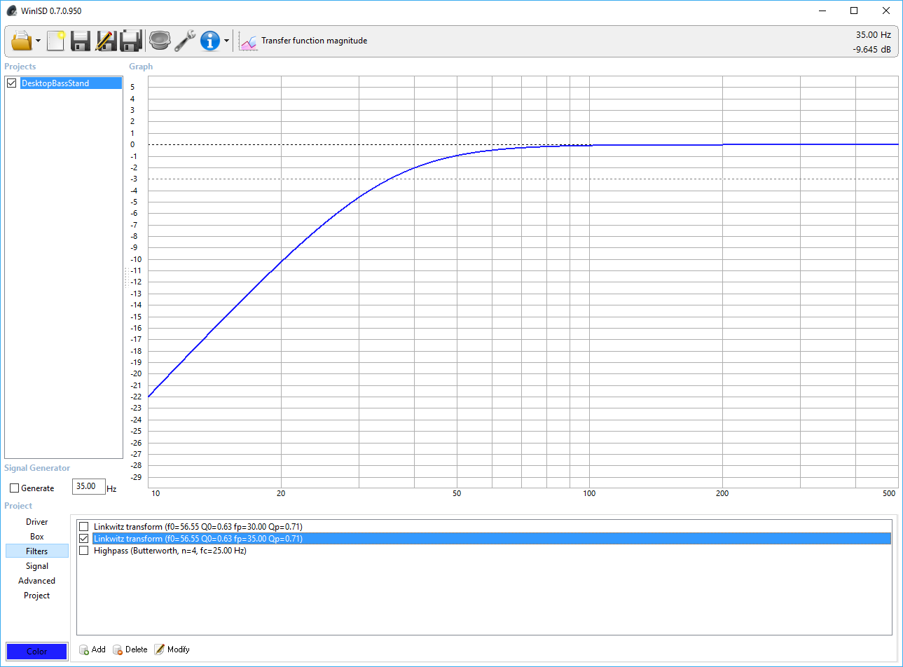

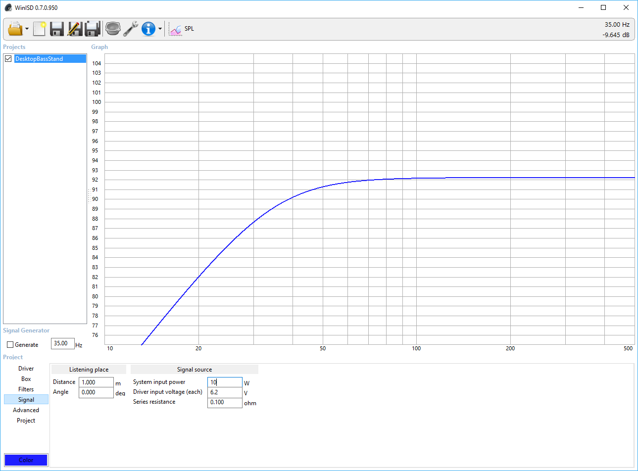

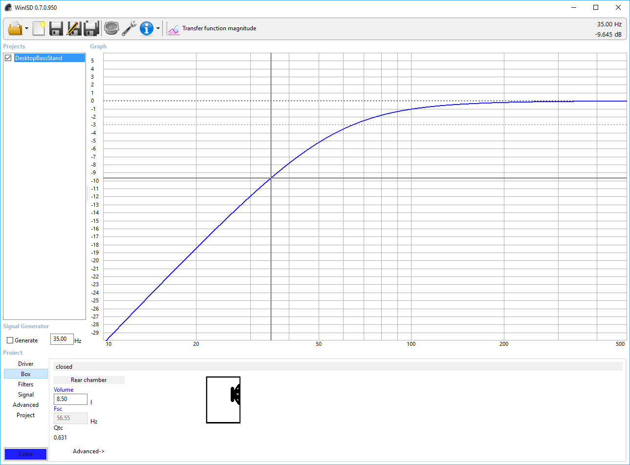

Ok, I did my 2-hour self-learning subwoofer design course and here are the first results. So bear with me and please point out if I have missed something 🙂
Idea is Linkwitz transformed sealed box. I chose 8.5 litres as it seems good size for my dimensions and enlarging from here doesn't really give much anymore in terms of lower end SPL.
1st image shows this starting point, 8.5 l sealed box. As can be seen, we are 10dB down at 35 Hz.
2: 35 Hz LT added. So we are boosting 10dB at 35 Hz and so also losing 10 dB of SPL, right?
3. SPL at 10 W, meaning at 35 Hz it is already 100 W. So kind of maximum SPL?

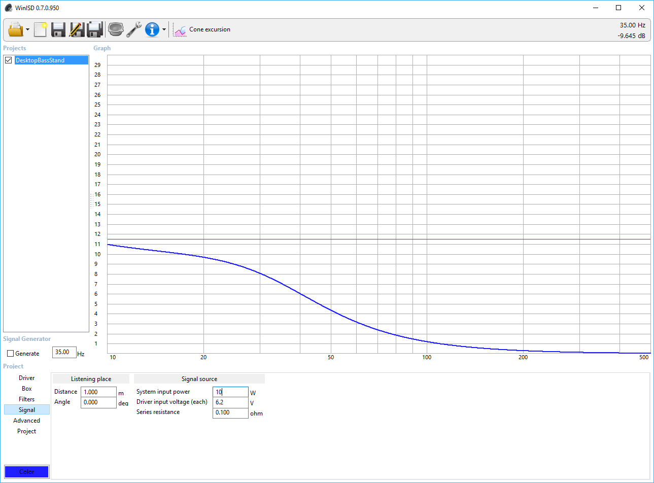

4. Cone excursion at 10 W. Still within limits. And I would use subsonic as well.
So this would give 92 dB which is plenty in a small room in near field. 35 Hz plus room should give some extra reach. This is of course simulation but I would also have two of these so that means more headroom.

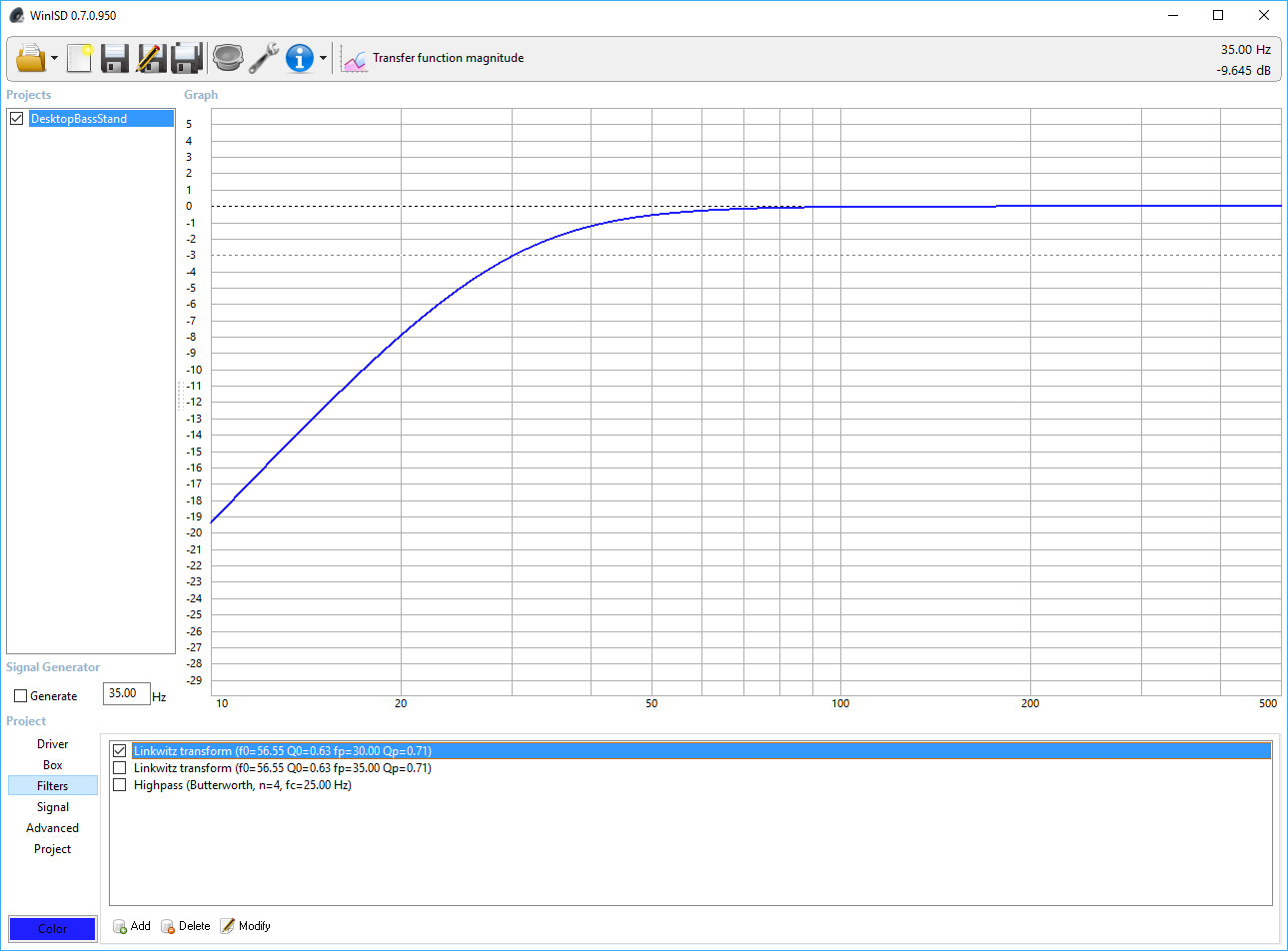

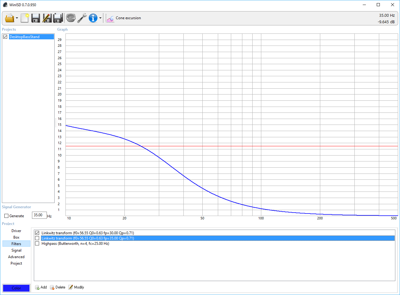

Another example with 30 Hz LT.
1. Fc at 30 Hz but now we are boosting already 12 dB meaning 16 times the power.
2. Cone excursion gets too high - but only below 30 Hz.
3. 22 Hz 4th order high-pass filter added, this keeps excursion within limits but does not really show in magnitude response.
Here used 10 W is already too much as we have 12 dB boost. Anyway, it kinda works on paper but is maybe too close to limits and pushing too far. Although again I would have two drivers giving some more headroom.
Anyway, based on these findings I could build two small sealed boxes and then experiment LT and HP with DSP, do measurement including the room and adjust. Could work! Unless I have completely missed something as I am new to this..

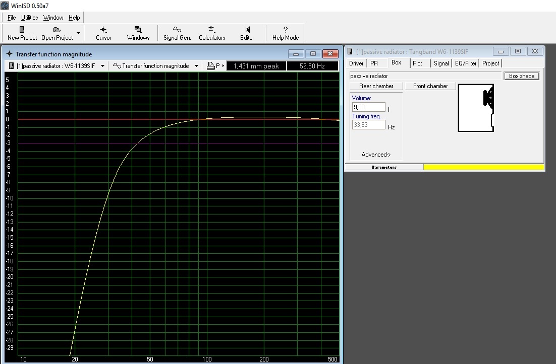

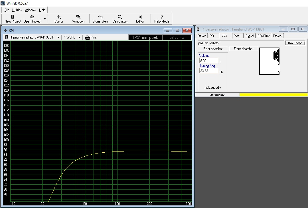

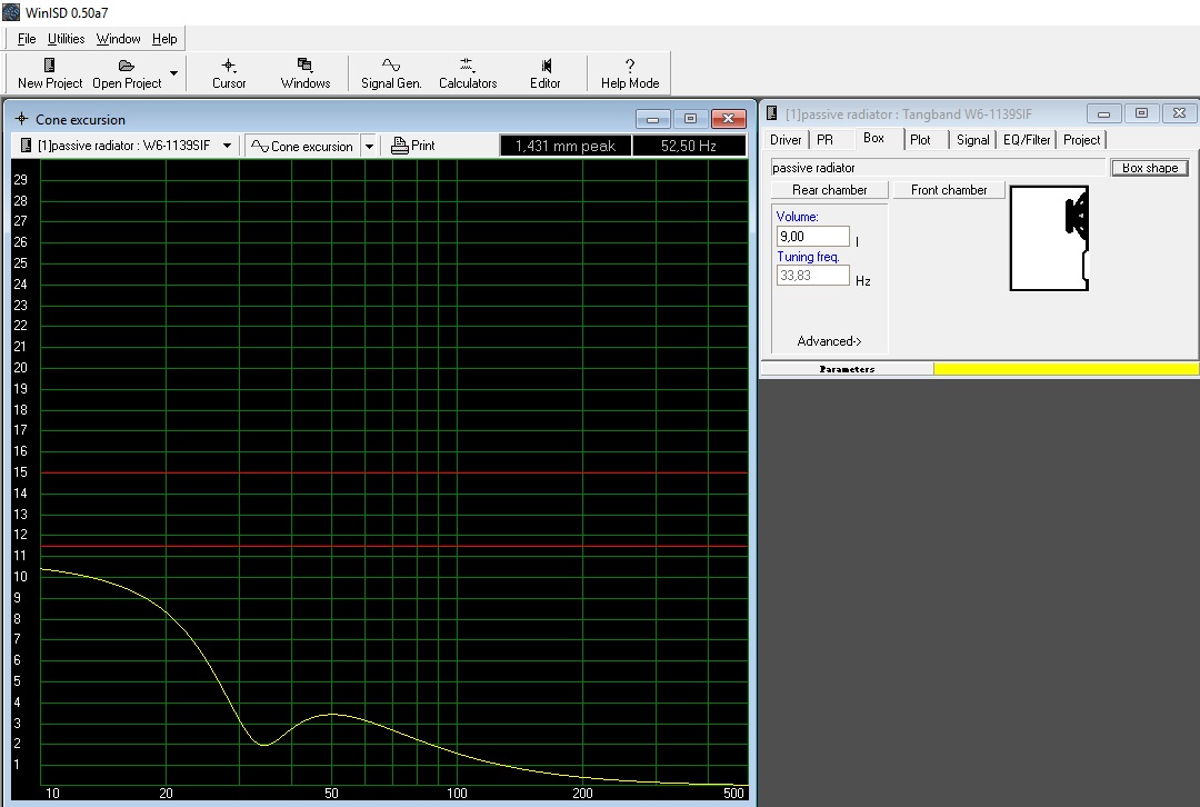

I simulated my box with passive radiators and I think I'll go with this one. I'm planning on using a spare LM1876 chipamp for power, so not much reserve there. If the amp goes to it's limits too fast, I might need to consider some class-d amp instead.
The simulation is done with 20 watts input, 9 liter box and no mass added to PR's.

LT with this small driver with so small power handling capability definitely has its limits. But near-field listening with quite low levels (at least in the current flat), should be ok. And as I would have two of them helps as well.

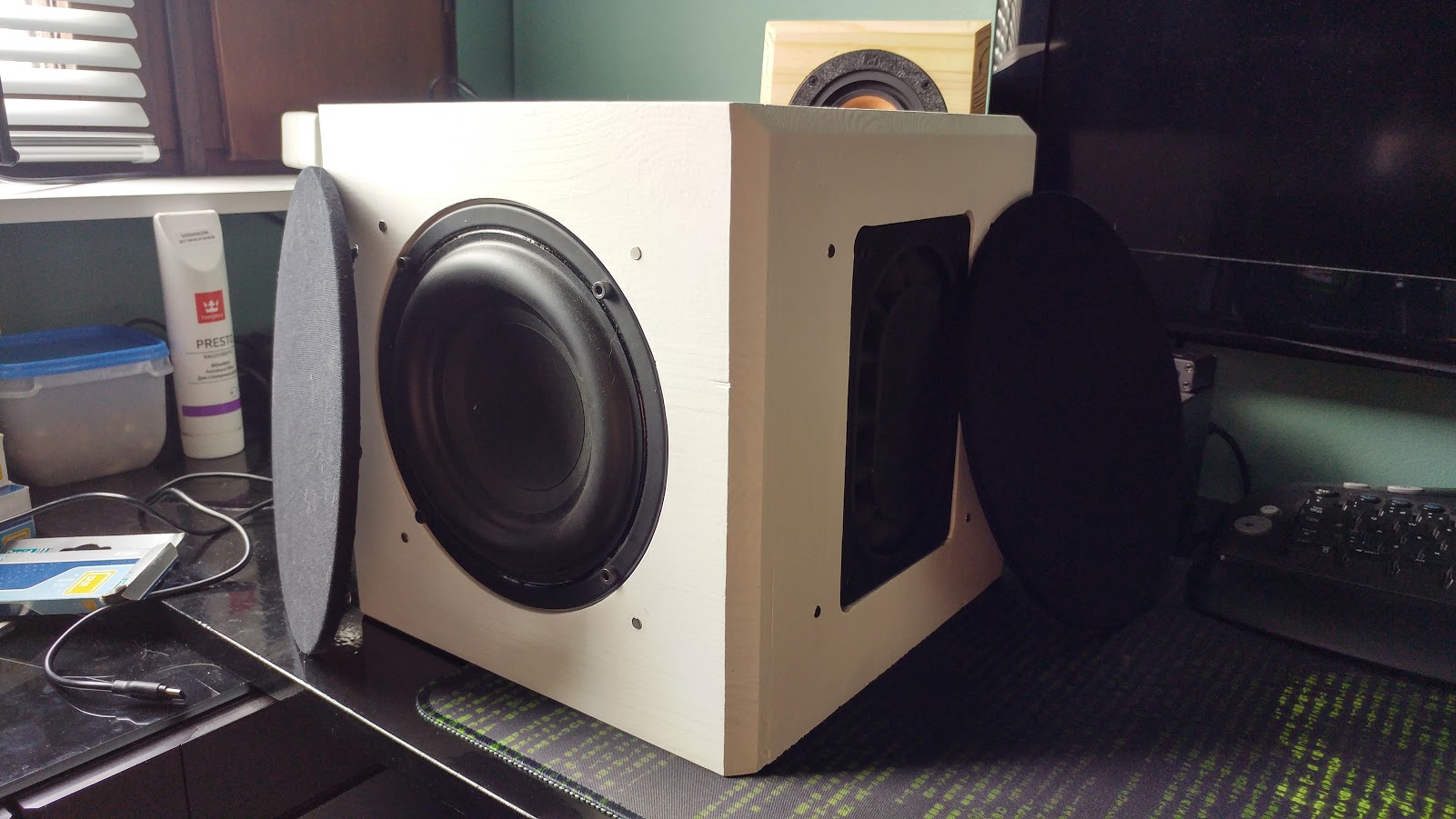

Just finished my build with the PRs. Not perfect finish but pretty good. Haven't done much testing with this, few notes with the LM1876 amp and it was immediately clear that I need more power. Now going for LM3886 and just as I received all the parts for it, my solder iron broke 😡
I'll try to post some measurements when I do them, I got the umik-1 with the minidsp, so lots of measurements and adjusting will come.

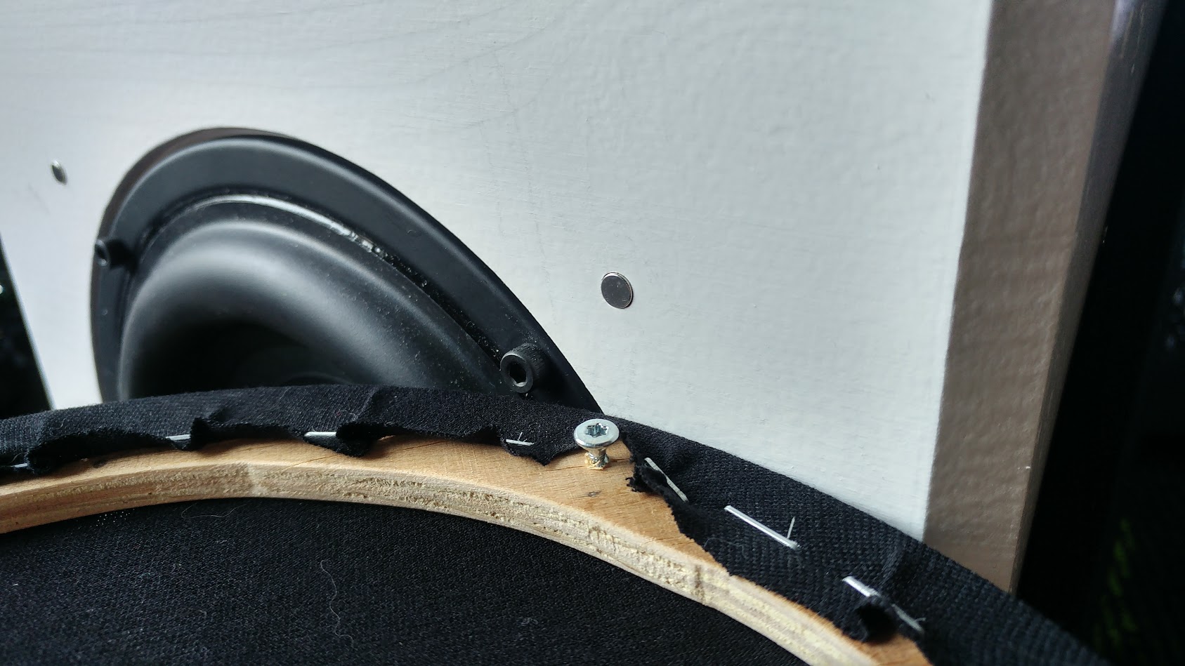

No doubt a circle cutter/jig (router) and just stretch cloth over it.
Just like that. I cut the rings with a jigsaw and used a staple gun to attach the cloth.
I drilled small holes to the rings and cabinet for the magnets to attach the grills to cabinet. The magnets aren't flush with the surface, because the cloth needs some space. And the front grill needed even more spacing so I just put small screws there.
