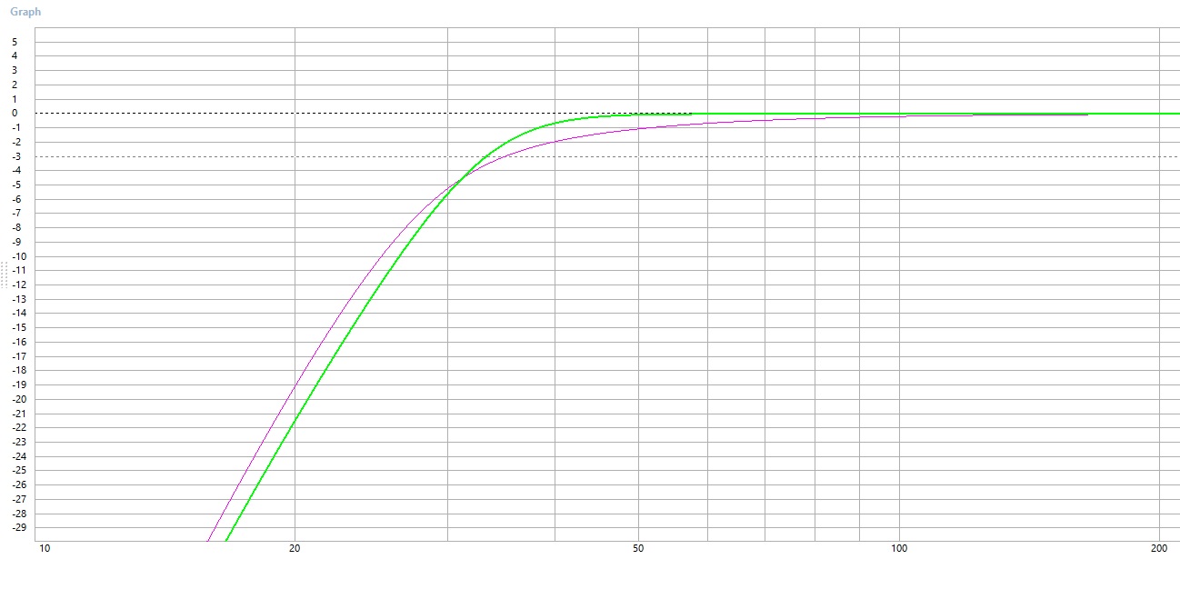

30% less length if wall slot ported, is that correct? Is this considered gospel?
If 30% of the port is removed after construction and gives that 30% back to the cabinet volume, how do you account for that? Slot ports are voluminous.
"Yeah, I was off initially because I said ~40% reduction----I'm getting old and some brain cells aren't quite as active as before, but none the less, a 30% reduction in required length is a big difference because it allows you to go BIGGER on the port area (without the penalty of a ridiculous vent length) to kill (lower) vent velocity and maintain port linearity to much higher levels."

That's what I personally measured with my DATS. I don't know if you consider empirical data "gospel".
I never removed anything after construction. This was constructed with a higher Fb initially in design. It was afterwards that I discovered the much lower than calculated Fb. Turned out sounding real nice, so I left it as-is.
Ah, OK, thanks for the reply. So if I have already constructed my cabinet and need to reduce the port size internally, is there a ratio or rule of thumb as to how the shortening of the port and the subsequent gain in cabinet volume will interact?
What I guess I am asking is:
Can I shorten my port by your indicated maths and achieve the right effect with the added cabinet volume increase?
Thanks. OK, to flesh out my previous post:
I have attached an image of the sim of the cabinet I have running.
GREEN LINE - 26L and tuned to 34hz with a 70cm port. This is the ideal prediction before real world port correction.
PURPLE LINE - 26L and tuned to 31hz with a 91cm port. This is the presumed real world response of the green line cabinet with 30% longer port.
If I decrease the port that is 70cm (but acts like a 91cm port) by 30% will I be on track?
I have simmed a cabinet volume gain of about 1.5L (due to reduce port volume) and that has little effect on the curve.
Many thanks,
