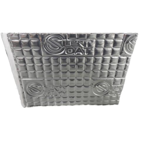

I'm not sure what you mean by butyl, obviously some form of rubber, but which?

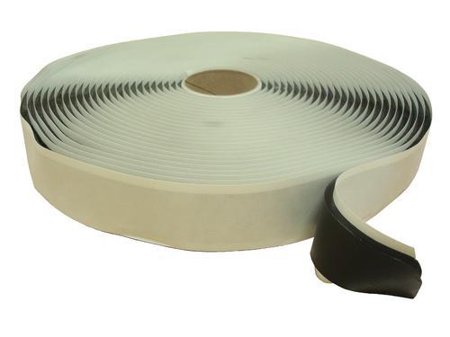

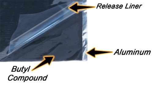

Most common CLD tiles for automotive use, damping door panels etc. has a butyl based layer. This used to be asphalt, some of them still use asphalt. Butyl stays more flexible long term.

It's also sold as butyl rope and/or tape, lots of automotive use for sealing various light assemblies and fender to car body seals etc.

It's very sticky and stays flexible. Excellent replacement for asphalt based damping panels. I've used both of the above mentioned butyl products in my line array build for different purposes.
Though Sorbothane might even be better for this particular job. 🙂

Butylrubber is good stuff for damping and has low rebound. Those products shown, with a single adhesive layer, are effective when added to a surface of roughly the same thickness. In a constrained layer damping (CLD) it needs adhesive on both sides and can be "thin". As added material, on top of, say 3/4" MDF, they are much too thin though (= not CLD and is not as effective).

My understanding of CLD is that it always contains a viscous or soft material between two rigid layers. If that definition is correct, does standard dynamat actually qualify as CLD? I wouldn't think so.
For it's purpose, when stuck to sheet metal, Dynamat is an excellent CLD.
Stick it to a thicker piece of wood? It probably doesn't count as CLD anymore. And if you use it to add weight to the walls mass loaded vinyl would be a better option.
I merely tried to explain what the butyl product was. Hence the name Dynamat came up, as a cushion between the clamp and speaker butyl tape would be a viable option compared to using an asphalt based product.
