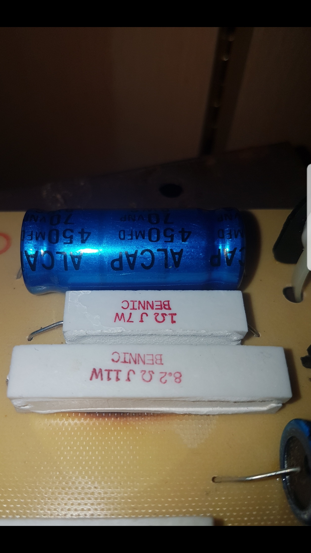

The hot running resistor (8.2ohm, 11w)...can I replace that safely with a higher rated resistor and would it run cooler?

That resistor conceivably got hot through some fault condition, like running the CM2 without the CM1 connected. I'd have to model the whole thing to be sure:

But really, simple troubleshooting ought to reveal if there is a serious problem. Coils and resistors are tough as old boots, and can be unsoldered to check the other components in series. Being 0.3mH / 8R2@11W / 63uF here.

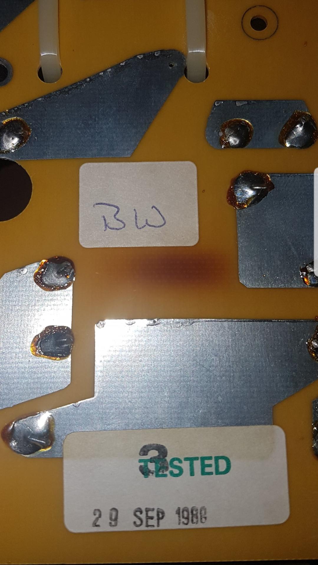

That's not the worst scorching I've ever seen. Not much can go wrong with a simple bit of coiled copper resistance wire IMO. Either works or it doesn't. But nothing stopping you replacing it at all.
