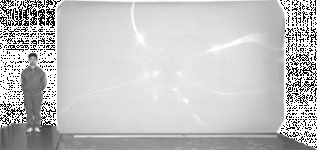

We might have a few "issues" with the Administrators of the MCG (Melbourne Cricket Ground) when we approach them and tell them we want to "strip" their 20 odd foot LCD panel though...not too mention rip the rows of lamps off the towers...u can ask em Trev 😛
hehe...see Trev told ya that pic you gave me would get used again if i just waited
Ya, they are the ones i cut up for the lilliput 😉 .
Nothing like the old fire cracker round the lamp post mate, how bout i do that and you play catch with the light? 😀
