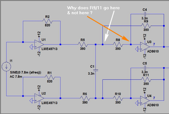

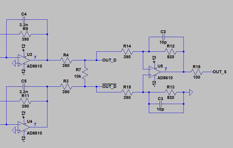

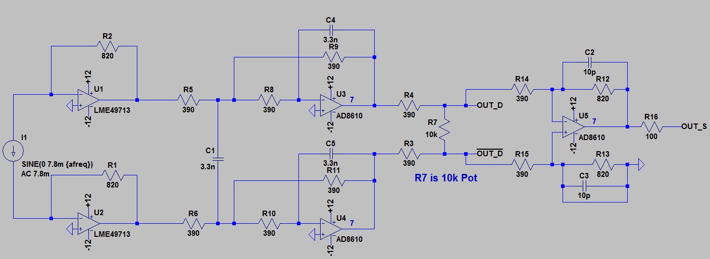

I realized that I cannot use the pot's in the way that I was planning so, i am readjusting the circuit to attenuate at the output of the op-amp instead of at the input that.
Here is the circuit I am providing a differential and a single ended output. The input impedance of the devices that this is going to is pretty high so the input impedance in the 300 ohm range will not hurt.
In the image R7 is a 10k pot.

I am looking to to the quad ganged pot .. to do volume control on dual (stereo) differential lines.
In your last screenie you show an Unbalanced output feeding the circuit. So have you considered putting the 4 gang pot in that position ?
You seem to have made it more complicated than necessesary. You have the unbalanced out "appearing" to be converted to balanced, Twice ? Then converted back to unbalanced.
I say "appearing" because U1 - U4 are ALL in inverting mode ? Which means you would Nothing out of U3 & U4 as they would cancel out !
So you could eliminate U3 & U4 for starters.
Let me know what you think, & we'll take it from there.

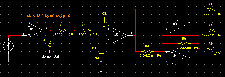

The input current source is differential.
Also the feedback is the way it is because it is a mulitple-feedback low pass filter topology, I have found that it works better then what you are suggesting.
@ cyaniccypher
I don't use LTS, & i didn't recognise the input signal labeling as an differential input current source at first ! The LPF looks more like a sallen/key type circuit than a mulitple-feedback one. Why is the f3 so high ?
Anyway, have a look at the circuit i've designed & see what you think. It's a Lot simpler & appears to do what you want. I've only used one output from the current source, but it still works. You could replace R1 with a larger value to get more gain, if required.

@ cyaniccypher

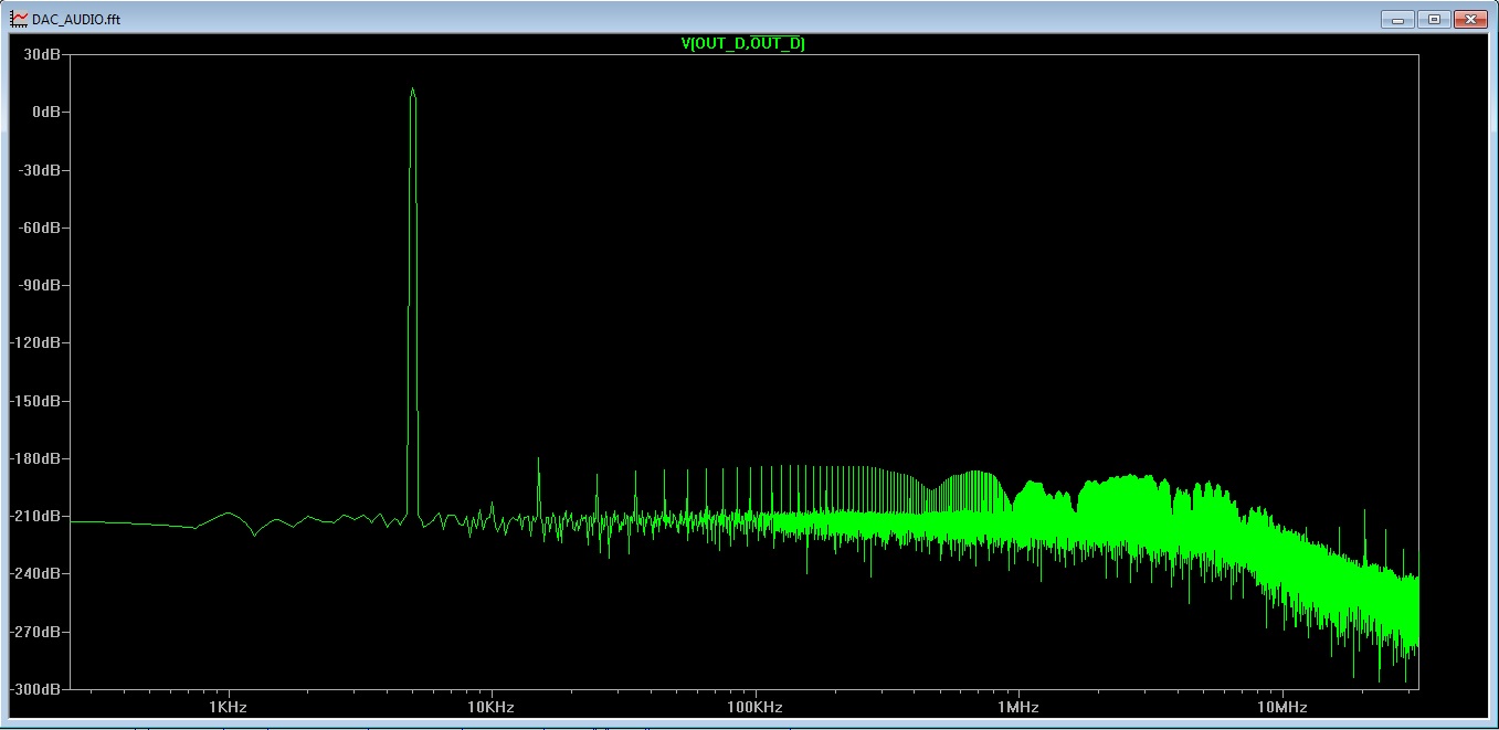

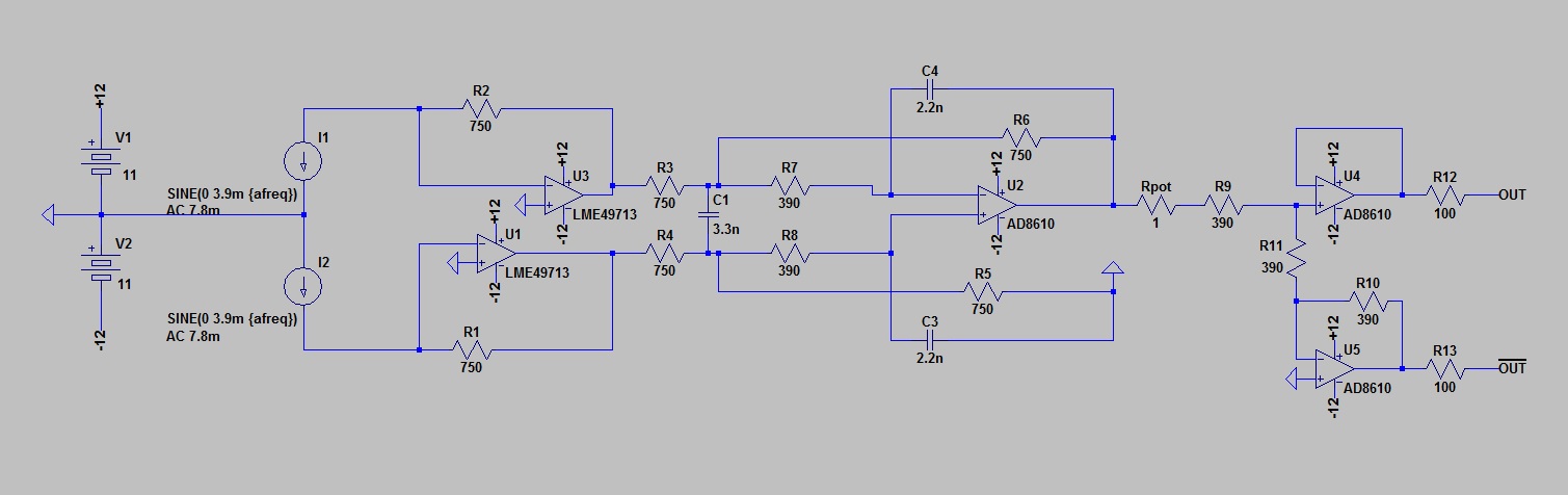

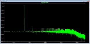

Thank you for that. I do not have a choice with the current output because I am using a PCM1794A which has a differential output. Or rather two single ended outputs that are 180 out of phase.
I am using your circuit for differential output though it is working really well in the simulation in real word I will never see a noise floor of -210dB.
R7 will be 2k and Rpot will be a 1k pot in the final design.

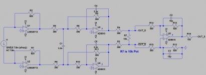

Thank you for that.
Pleasure :)
Yes you do have a choice, as i mentioned & showed in my previous post & screenie. By taking just the + or - output from the PCM1794A & feeding into my circuit, will still produce a complete sinewave signal @ U1's output pin.
Well it's similar to my circuit, & will work, but you are creating a unnecessary propagation delay @ U4's output. That's because you've taken U4's input from U3's output. If you notice how i did it, there is no extra PD because the inputs to U3 & U4 are both connected directly to U2's output.
It should be the other way round, otherwise you will get a variation of -6dB to zero.
Also your curcuit uses 5 OPA's, where mine only needs 4.
Where is the unbalanced output in your circuit ?
I'm still not convinced about your LPF circuit though. And Why is the f3 set so high for it ?
Also doesn't pot in the feedback loop normally need a reverse log lot (hens teeth are easier to obtain)?
Also, doing it that way, when that pot gets even slightly intermittent on the wiper contact, you are asking for nasty noises.
Why not just do the standard thing, pot from U5 to ground (With a DC block cap) U3,4 are a simple buffer, easy, obvious and no opamps running at less then unity gain, so should be stable.

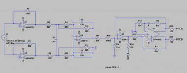

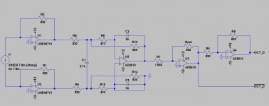

I will use the circuit below, you are correct with the propagation delay from the circuit i had before.
I am putting another resistor in series with the pot because when the pot is at 0 ohm i do not want the gain to be too high.
It will be a log pot.
So you don't want to use the 4 OPA circuit with other fewer components too, & still acheive what you want. OK by me ;)
I see.
With the filter the way it is there is already -.4dB attentuation at 20kHz. If I move the filter in any more it will start cutting into audio range and I do not want this
OK.
Pot will be 100k.
It'll give you a lot of attenuation, but might be noisy !
