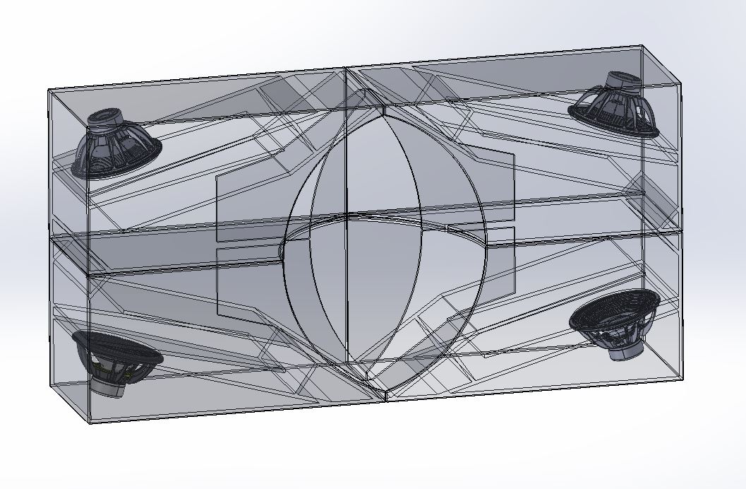

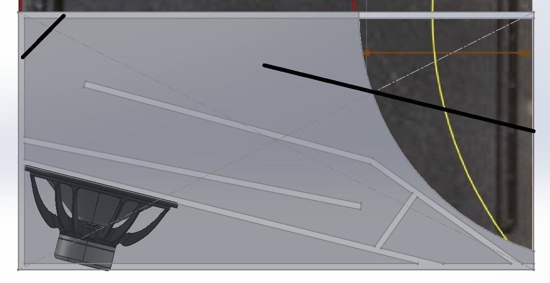

Currently I am trying to design and build prototypes similar to danley BC218, divided in half for easier transport and multiple possible deployment configurations. I will be using 18SW115 8ohm version as i already own them and it seems Danley also uses them a lot in his designs. My goal is not to make a identical copy of his design but to make a sub with similar preformance and same design benefits. Aiming for same dimensions and about same frequency response (-3db@ 28hz).

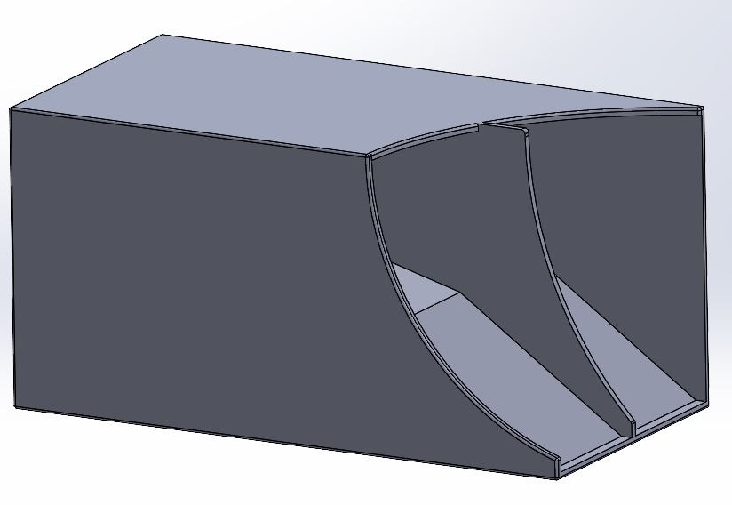

I've been following @weltersys folding prediction and made a 3d model, but 18SW115 sadly doesnt fit and i am not exactly sure how to model in hornersp with decent accuracy.
I am relatively skilled in Solidworks, Catia and cabinet building (designed and built my own version of TH118 and 4 way synergy horn), but lack experience for simulating such advanced horn sub.
Any help would be appreciated, as i said looking forward do design 3d model first from usable simulations, then build 2 or 4 prototypes - I have a huge free area near my house and I will keep this thread updated with build progress and measurements.
Looking for support in simulating this folding or exploring possible different horn foldings
Attaching picture of a very rough model
Looks like the 18SW115 "fits" in your rough model 😉 .
The "half moon" exit shape won't model in Hornresp, you would need to use Akaback to get closer.
I have no experience using Akaback.

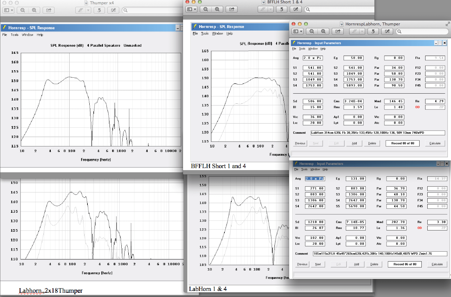

If you are just looking for a start in Hornresp, these inputs would get you going, they would all need adjustment in length and area to conform with whatever your horn's cross sectional areas and lengths are:
Two (2P) 18SW115-4 were used in those models, you would have to substitute a single 18SW115-8 driver parameters.

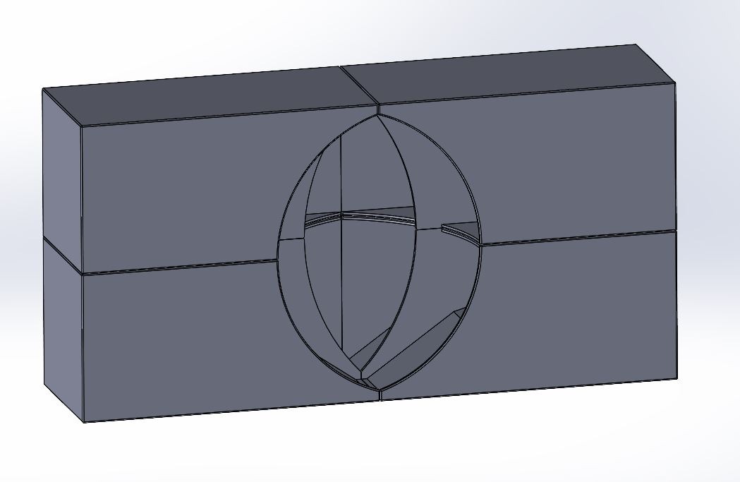

Thank you for detailed answer @weltersys, I am only slightly experienced with hornresp and have no experience with Akaback, As far as my understanding goes the ''half moon shape'' extends low frequency by few hz, so for what reasonable low corner should I aim in my hornresp model? in advance I apologise for potential use of wrong expressions or silly questions. Do you still think that this folding of horn is suitable for this cabinet or there might be a better option? I have seen a video on Youtube posted by Ivan and it seems they use this driver orientation (we can see driver through plexiglass). Attaching a picture of driver mounted in 3d model, you can see there is a few milimeters missing, I followed your prediction which uses lower driver height.

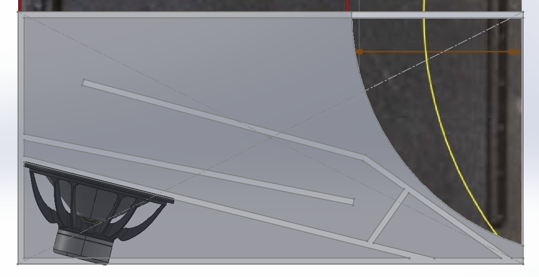

Will try to modify overall shape a bit to get it to fit comfortably
What do you think about overall folding of a horn? I will add a reflector at the top left corner but i suppose adding other reflectors in early sections of horn will reduce horn volume and make response worse? Also extensive bracnig will be added.
Reactions: Sn95 and camplo
Yes, since I have been following the Xoc1 thread for TH18 build and built a few of them I already know about benefits of not adding corner refectors, my plan was only to add a reflector on top left and good bracing. Planning to use this refector also as place for handles
Currently I am exploring different horn folding approaches to eliminate wasted space next to horn mouth, if any of you has any suggestions I will be happy to 3d model and sim them.
"BC" =boundary coupled.
The increased boundary area increases forward gain by as much as 4dB around 55Hz, about half that below the low corner.
Shoot for an impedance response similar to the BC218, and an F3 of 26Hz.
Obviously some slight changes are required to fit the driver.
Looks OK to me, more twists in the throat end could make the path length longer, but it's close to the correct 1/4 wave length already, assuming 60" x 30"x 30" outer dimensions.
Those dimensions are made for (USA) truck pack and standard 5'x5' (60" x60") Baltic Birch.
Danley seldom uses "reflectors", other than for wheels or handle placement as you plan.

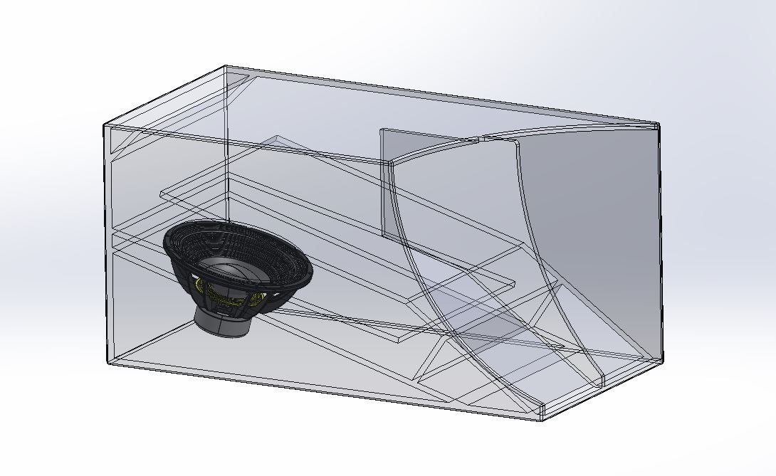

Here in europe we have plywood mostly available in 3000x1500mm sheets (pretty close to 120x60 inches), so outer dimensions I plan to use are 1500x750x750mm, which closely resemble original dimensions (one half).
I think i will stick with current folding, only adapt it to fit driver and then adjust it to simulations.
Will keep you updated and thanks for detailed advice.
Yes I have seen these 2 threads. there seems to be quite a bit of useful info, but both threads kinda go offtopic fast. There isn't really a lot of hornresp sims or actual models with dimensions. Also some predictions seem to get way too low tuning in my opinion. Art's prediction for horn folding seems to be the best and closely resemble original. I started this thread with intention to exploring BC subwoofer concept and to build actual prototype, then post real word measurements. Making 3d model and building good quality cabinet is easy part for me, but to get horn dimensions right was the main issue, so I seek help and advice from experienced horn designers.

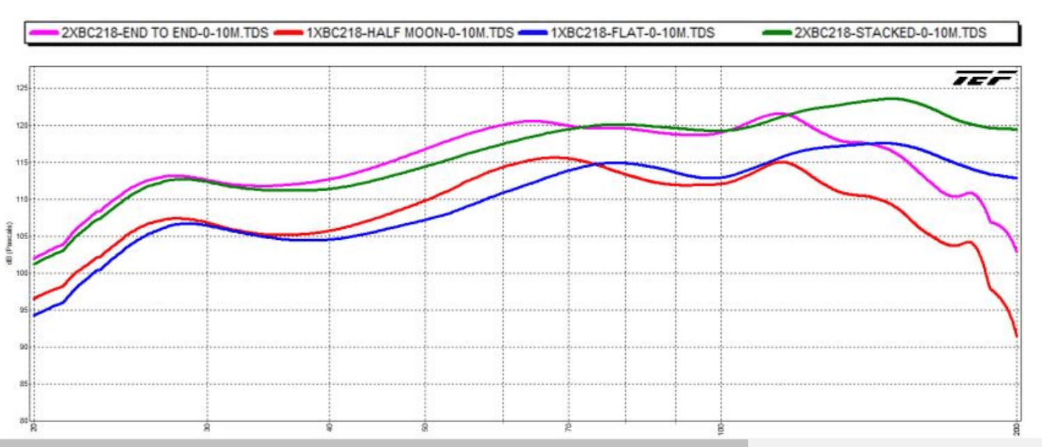

Yes I also agree with you, I think shape of the mouth definitely changes things a bit. In attached picture we can see how different configuration change frequency response. I believe that in ''flat'' and ''stacked'' configuration, it behaves as a standard front loaded horn. So i think we should take that frequency response for our goal and then just mimic moon shape from pictures. Is my thinking correct?

As a start I would begin iterating between Hornresp and 3D, trying to find the best compromise between response and what you can fold into the enclosure 🙂. Weltersys has shown some nice examples. If you are going for similar response as the 'flat' response shown above, beware that you compare 2 of your 1x18" boxes with 1 Danley sub.
Now I see that the datasheet also contains the response for the 'flat' position, Hornresp will probably do just fine to simulate this, and indeed apply the 'half moon' as close to the original. It would be cool however to see if we can simulate the same response differences for different stacking configurations by using a finite element method. So you can always send me the model (*.stp) when you're done iterating.
Yes.
Since you are building the cabinet in two parts, shoot for the frequency and phase response shape of two cabinets to be similar to that of the blue trace (1XBC218-Flat).

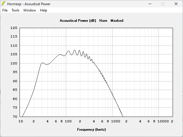

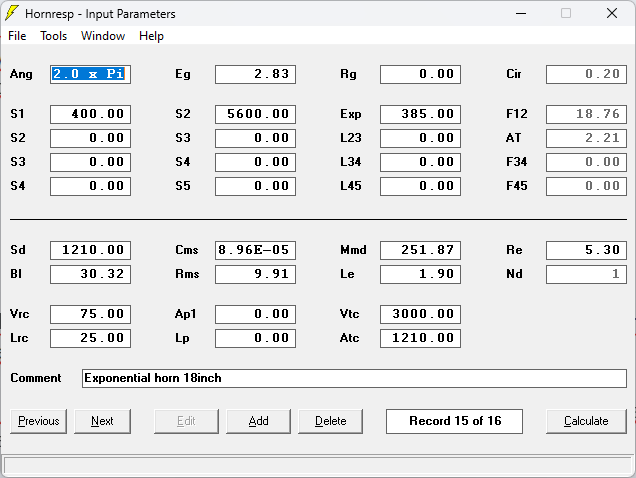

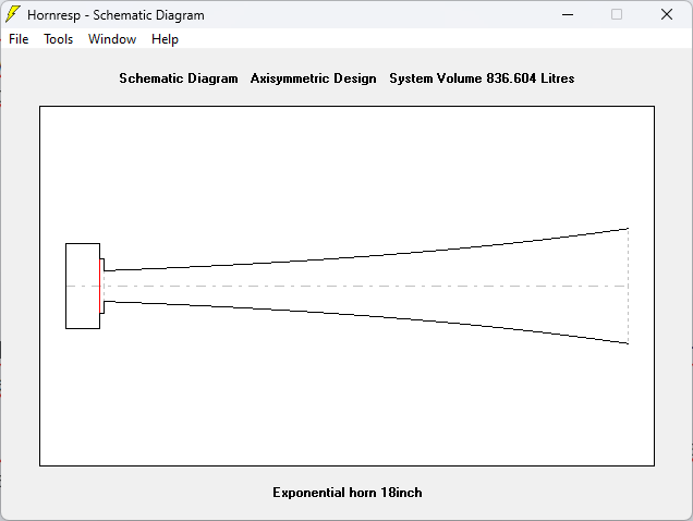

To get you started in Hornresp, my workflow would be:
1. Enter driver parameters
2. Use 1 exponential horn section
3. You know your global box dimensions, so you can enter the horn's mouth area at 'S2'.
4. Your 3D design gives you an idea what horn length can be obtained, enter at 'L12', or 'exp'.
5. Get your available horn volume (volumetric) from your 3D design (L*W*D of your total cabinet)
Now you can fiddle around with:
  • The horn's throat area 'S1'
  • The rear chamber volume 'Vrc'
  • Driver's front chamber volume 'Vtc'
And check if your horn volume calculated by Hornresp ('Window' -> 'Schematic Diagram') does fit in your box, and if the response shown ('Window' -> 'Acoustical Power') does meet your requirements.
If all is well you need to discretize this 1 exponential horn section to 3 or 4 parabolic sections (because that is wat you are actually building), and see if you can still obtain your desired response.
I see Weltersys is using the Offset Driver (OD) model in Hornresp, but I think as a start you could stick to the Single Driver (ND) model.
I got too excited and tried the above already 😉, and it seems promising:
